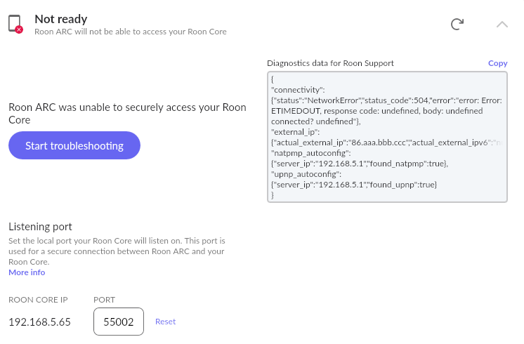

Tell us about the problem you’re having in as much detail as possible. Screenshots are always appreciated!
With that, can you also provide a screenshot of the error message you see under your Roon Core Settings> Roon Arc?

Thank you for your patience while we’ve diligently worked to reach every request for support with port forwarding. The diagnostics you’ve provided suggest that UPnP is not properly configured on your router.
Please first try the following steps:
  • Try to enable UPnP/NATPMP in the web administration interface for the router directly upstream from your Core
  • Try to manually open the port in your router’s port forwarding configuration
  • Make sure the IP/Port matches the Port listed in Roon → Settings → ARC
  • Check for any VPNs or Firewalls that might be interfering
  • Check if your modem is in Bridge mode

Can you confirm the port number from your Roon Arc settings matches the port number being used on your router? We’ve seen a few cases where an ISP or router can change port numbers and therefore break the port forwarding rule.

I’m on Virgin and no issues. It will be the port forwarding setting on your Mesh that’s changed. This could be the ip of your Roon core has changed if you have not reserved its DHCP address. Do you have UPnP on the mesh router?You need to ensure that your forwarding port 55002 from the router to the ipaddress of the core.
