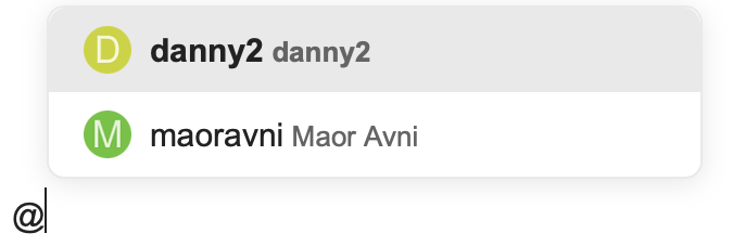

okay, why when I write @support does it automatically turn into @AMT?
Thanks I will try that.
I don’t think it does. As soon as you type @ it opens a menu with the user names that already posted in the current thread, to make it easy to pick one. Like so:
If you don’t want either, simply continue to write the name that you want. Then the menu shows additional known usernames from the forum (not just the current thread) starting with this character:
