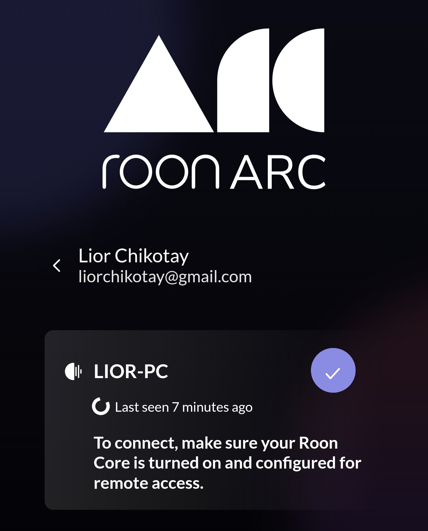

Another thing that I noticed in all of this, is that when I first set up ARC, it looks like the connection to the core is not stable from the get go.
After the ARC reset, I choose my core. It says it’s online, but does not proceed to choosing the active profile. Instead it stays that way or says the core was last seen X time ago.

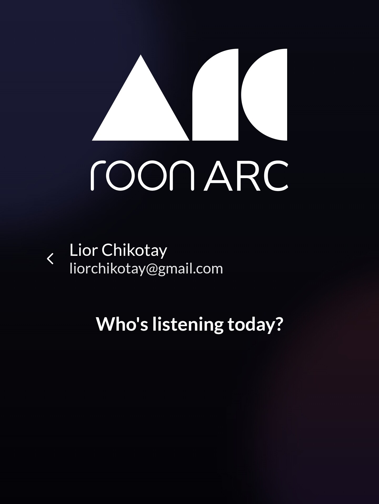

If I quit ARC and start it again, I get to choosing the profile. But then it shows no profile, nothing to choose. It will stay that way until I restart ARC.

I’ll attach some screenshots.
