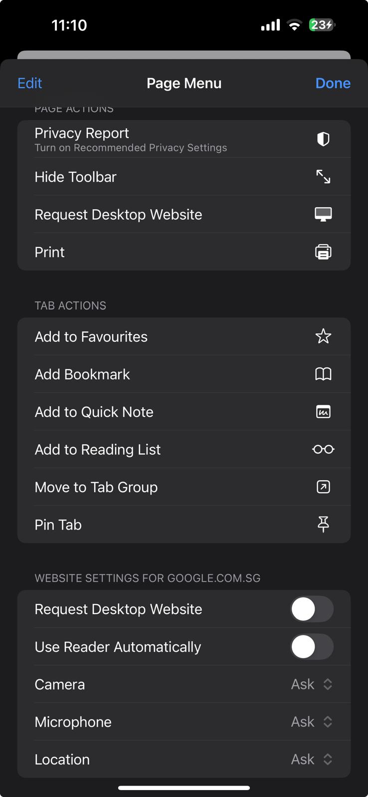

I don’t see this setting anywhere. Might have been removed in ios18 (not sure).
I’ve done this multiple times.
Hello @Michael_Silva ,
It looks like you are on WiFi, can you please check this setting?
