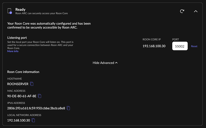

ROON ARC says everything is fine.
I can connect my mobile phone to ROON ARC using the WIFI network but not using the cellular Network

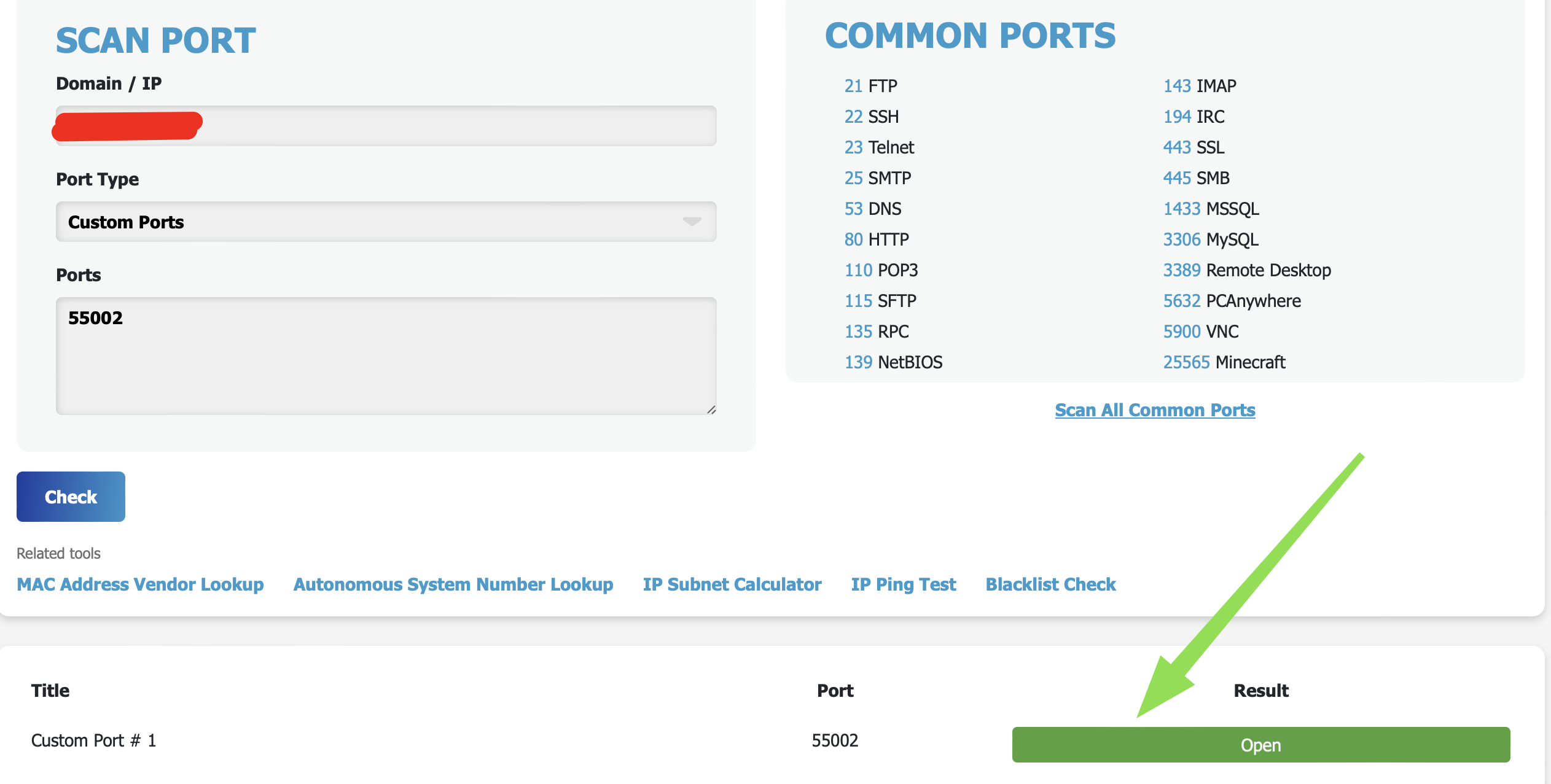

  • Visit Port Checker - Check Open Ports Online with a browser while you are on the wifi
  • It should automatically detect the external IP address of your router in the “Domain/IP” field
  • Enter the port number 55002 that ARC is using in the “Ports” field
  • Click the Check button
What is the result? It should show as “open” and we want to know if it does
First of all I would like to Thank You for your kind help.
My ISP is TOTALPLAY
And I have performed the check as you instructed me directly on the ROON Server.
The result is below
May I kindly ask you for a suggestion to solve it?
Thank You again.
-Marin Rene
Glad if I can help, I appreciate the kind words :slight_smile:
OK, this is not great. It is possible (likely) that something in your ISP’s network is blocking access to the port, and does so in a way that Roon cannot notice (hence why it says “Ready”). I had something similar with Vodafone in Germany. It took me a lot of convincing on phone support to explain to them that this is not how it is supposed to work.
I also note that you have an IPv6 address (the new version of IP addressing). This is normal with TOTALPLAY, they don’t seem to provide IPv4 addresses anymore for residential accounts. Roon added support for IPv6 to ARC in May of 2023, so it is possible that this can be made to work. However, we have seen that there are still issues with some IPv6-only ISPs in some cases. My own experience with IPv6 is limited, though.

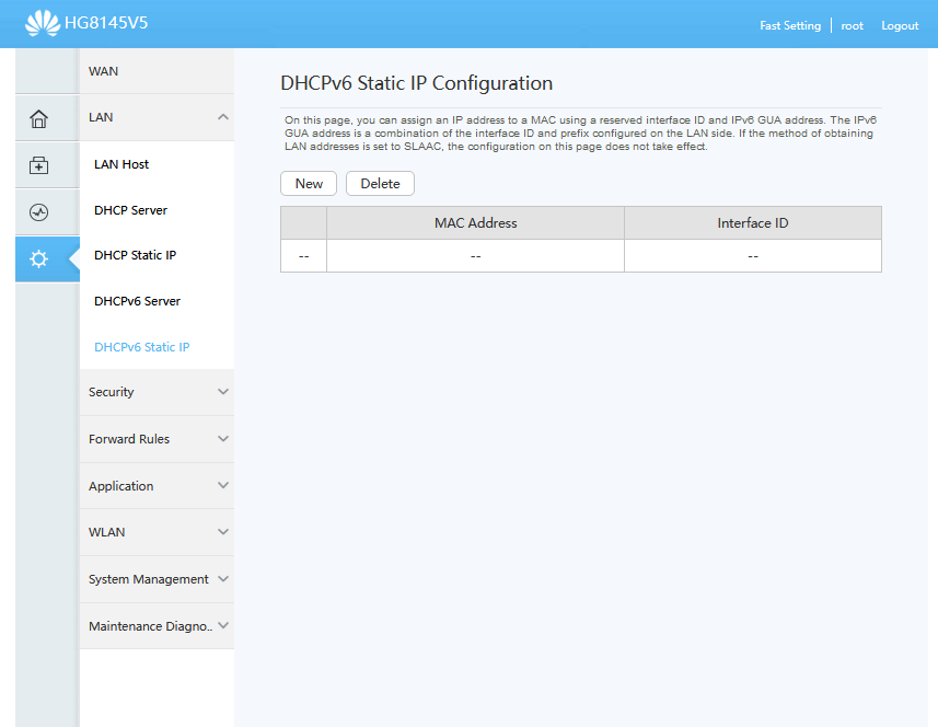

I am afraid there is no settings on the router (it is a Huawei HG145V5) that might appear useful to perform any of your suggestions.
Allow me to send you the screenshot of what the router shows.
Is there something you can suggest to me?
Is there nothing under Security and Forwarding sections as that’s for DHCP management which is very different.
Hi @MarinRene,
Please share a screenshot of the Security tab, with any IP addresses or sensitive information omitted. We’ll need to see if an IPv6 pinhole is available.
