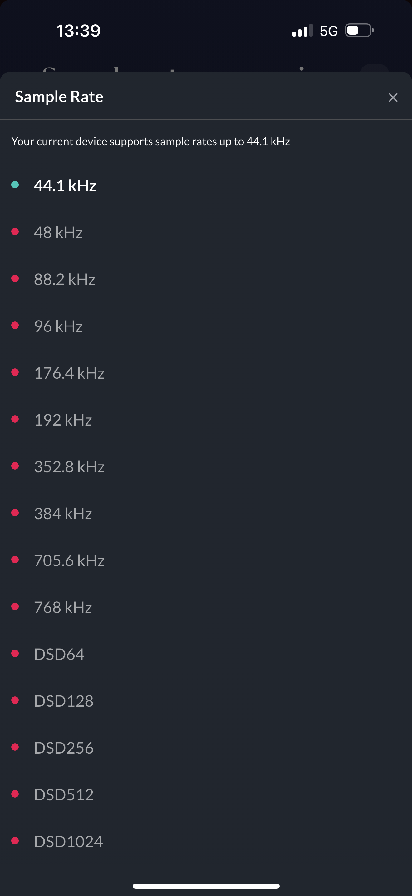

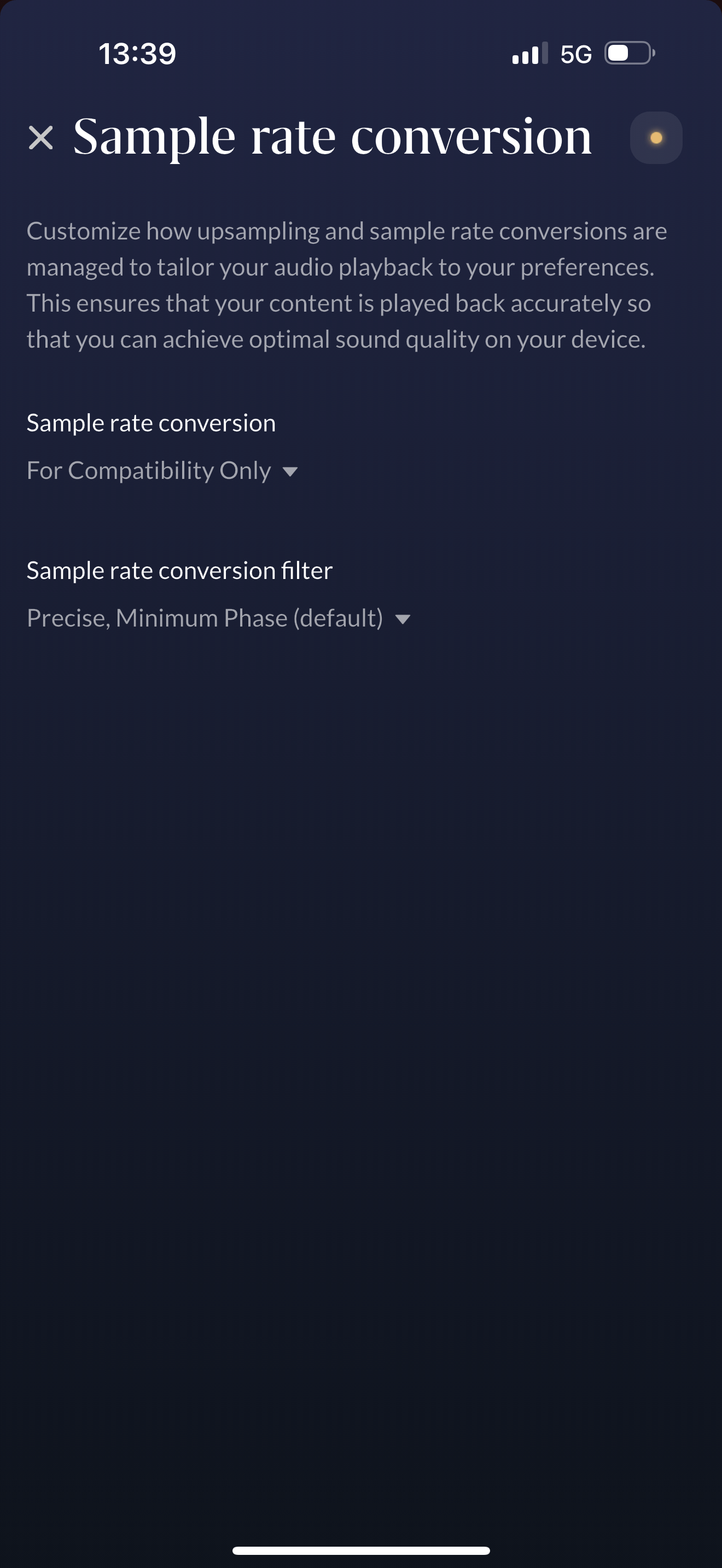

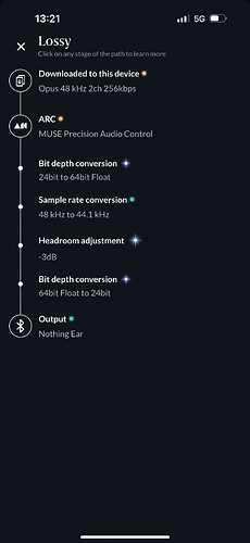

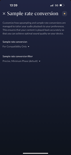

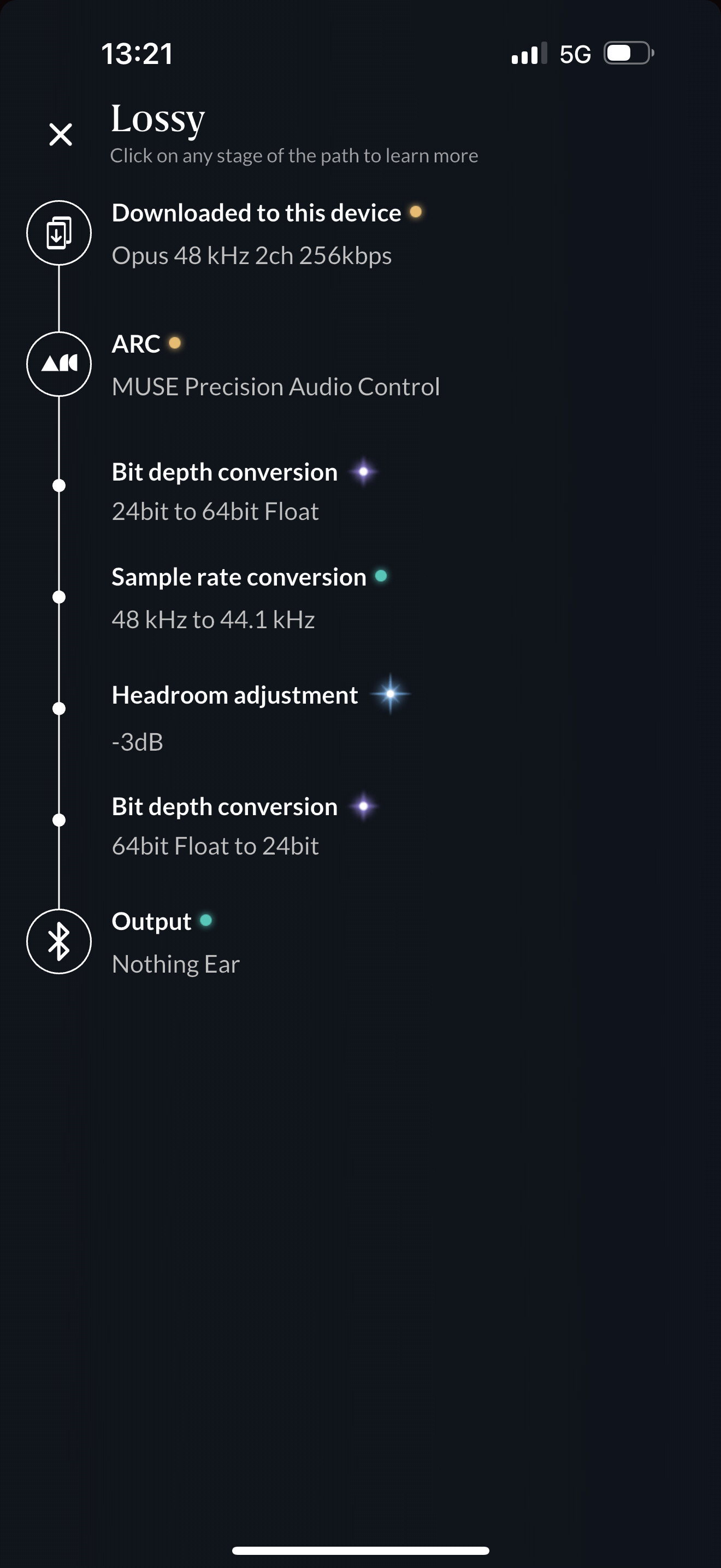

Why is this downsampling happening when iPhone’s Bluetooth is AAC up to 24/48?
My nothing earbuds support AAC 24/48.
Edit: I’ve double checked and it appears these are limited to 44.1! :roll_eyes: my bad. New earbud purchase coming my way.
I mention this as my phone is cooking whilst playing downloaded music.
It’s set for compatibility but in fixed it shows 44.1 being the maximum.
So on my iPhone for playback it would appear Muse is causing the heat issue with my earbuds. I believe this to be the case as PlexAmp in comparison, which is Opus 24/48 also, with downloads isn’t creating the same level of heat.
