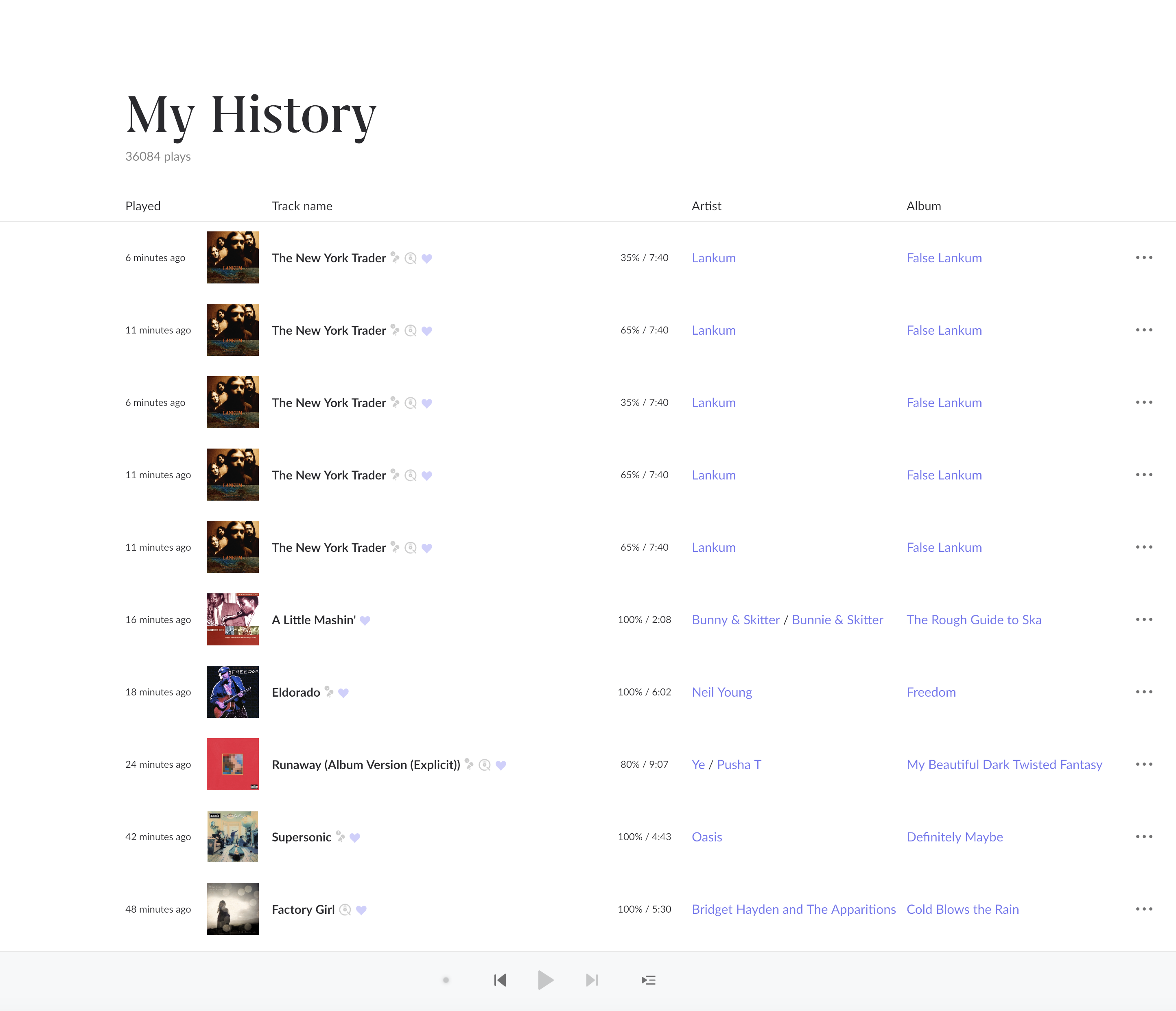

I am experiencing a problem when using ARC, whereby the play history is incorrectly recorded and tracks are shown as having been played more than once. This mainly appears to be happening when a song is paused or interrupted (eg when switching off my car at the end of a ride or when there is a connection problem), but not sure that is is always the case.
I first noticed the problem about a week ago and saw that there was a long list of tracks (that were played during the preceding month or so) listed in the history as having been played 252 times each (as well as some with lesser play counts)!
I have cleaned up the history manually as far as I could, disconnected ARC from the Roon server and reconnected it. I am now keeping a close eye on the history to try and figure out what is going on - as per above it seems like the problem occurs when a song is paused or when there is a connection problem on ARC (which occurred fairly regularly in the past but not since reconnecting it to the server).
