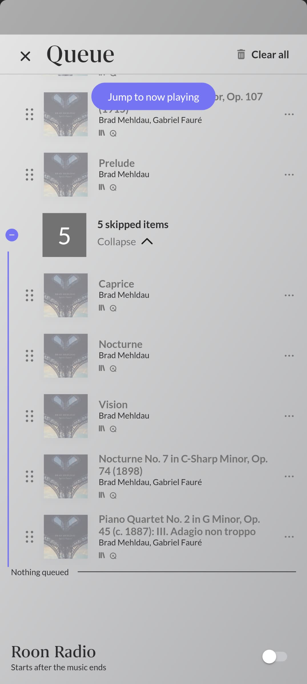

ARC is skipping tracks after pause\play. Hello! I use ARC on a Pixel 8 Pro. If I pause what I'm playing for a few minutes or a few hours and then I start playing again, most of the times ARC restart the track that it was playing, finish to play the track and then skips all the remaing tracks in the queue. I can see "xxx skipped items" in the queue.

I just pause the track. Then I use the phone or other apps or just put the phone to charge or lock the screen. Sometimes I quit ARC because it uses a lot of battery even when it’s not playing. When I go to ARC again and I start playing, the current track starts playing again. At the end of the track, not always but most of the times, all the following tracks are skipped.

It just happened. 11:33 AM Italian time, 2:33 AM Pacific time.
