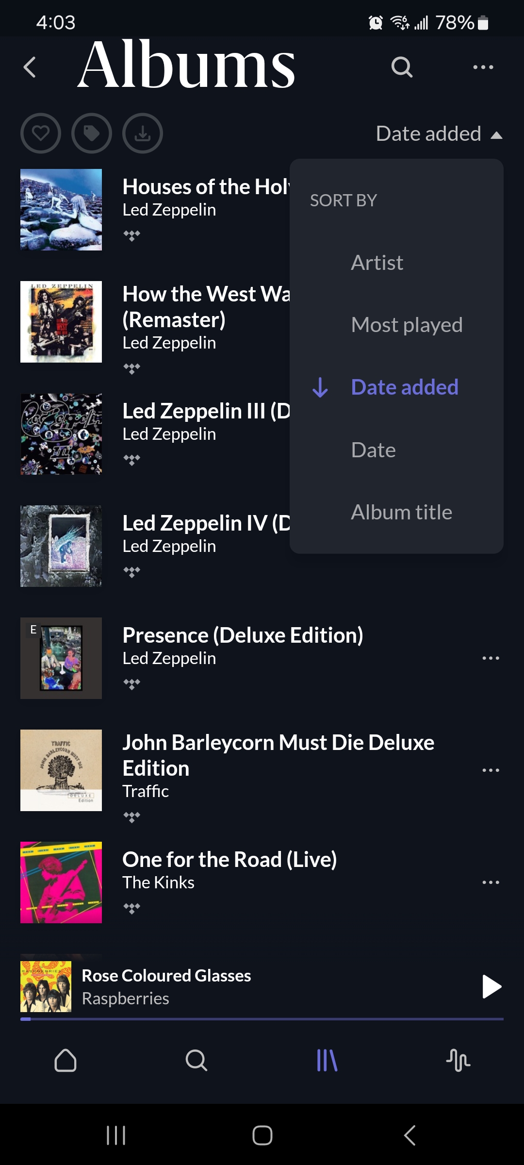

The list of favorite albums is displaying in reverse order that I want and it won't let me change it. Normally I use date added with the arrow pointing down so it's the most recent albums added at the top, Arc does not respond anymore to that.
It's the same with other sorting methods such as most played or artists name or album title.
Router is a Netgear Nighthawk mesh router. Modem is just standard issue from Spectrum internet, no brand name on it.
And just to be clear, normally you can flip the order of your favorite albums, that is what no longer works when you tap on the arrow.

Thank you for the report. Just to be clear, does the arrow icon respond to touch (reversing sort order) for any of the browsers in ARC for you? Try the Playlists or Tracks browser as well.
We see the device in diagnostics but for due diligence also want to confirm the make/model of phone you’re using here. We’ll attempt to reproduce this in-house and respond shortly. Thanks!
Hello,
no none of the other categories can reverse order either. My phone is a Samsung Galaxy S21 Ultra.
