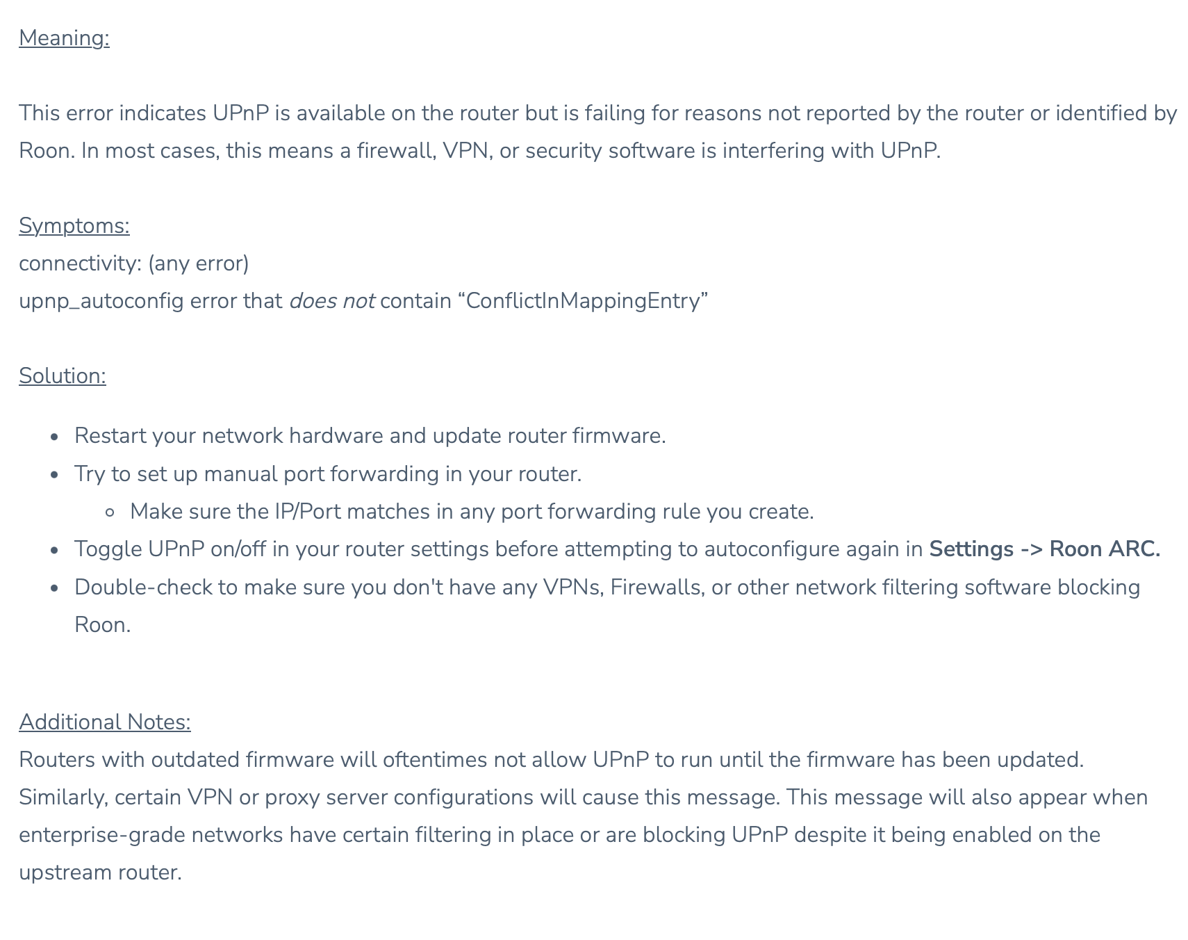

This is an unspecified UPnP error on the router. Try restarting the router and then (when it is fully back up) the Roon server machine.
From the port forwarding help page:
Thank you. I rebooted the host, and now it works.
