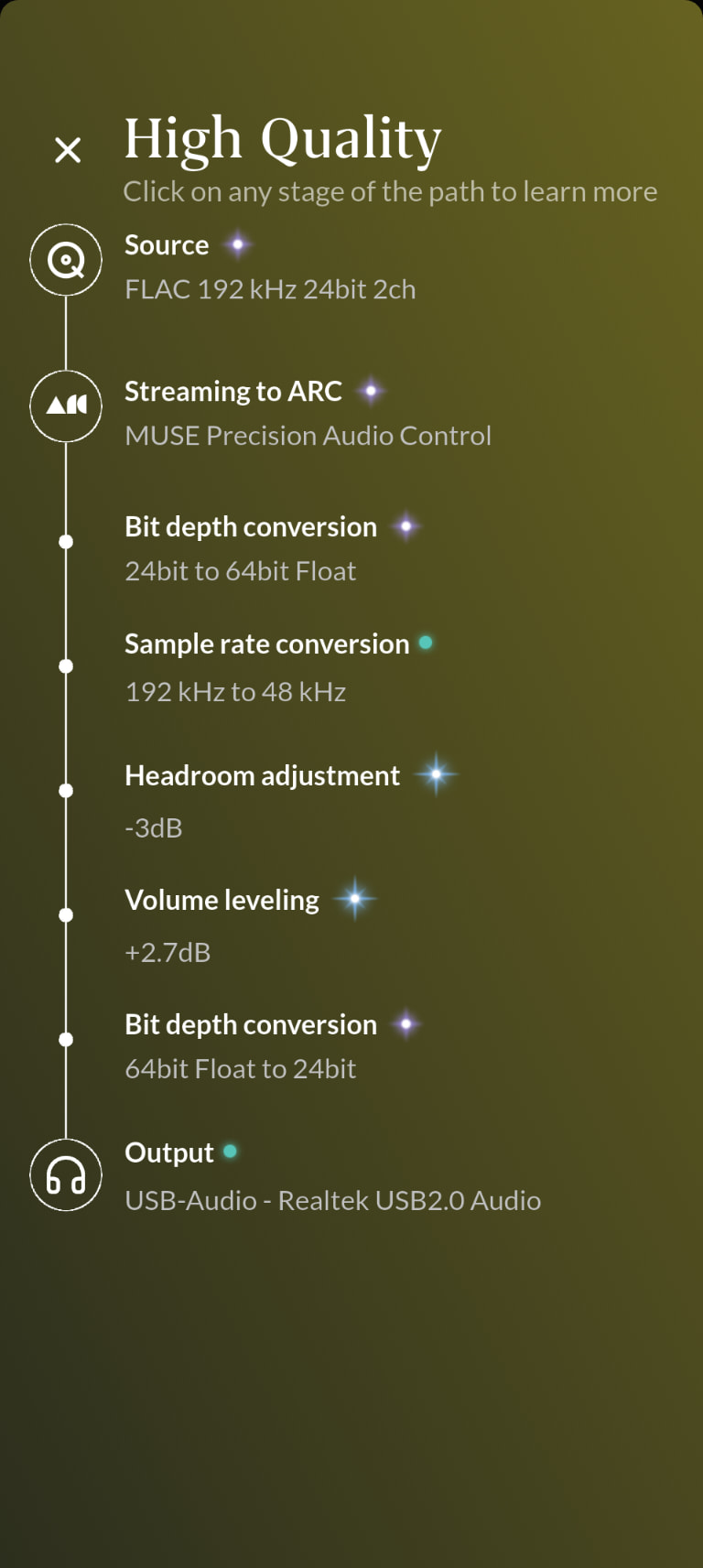

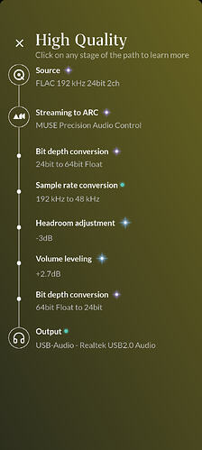

When enabling the USB Driver beta in Roon ARC, the app fails to initialize exclusive mode with the Realtek USB DAC dongle. Instead of displaying the Android USB hardware permission pop-up, ARC falls back to standard audio routing and Android targets the default (wrong) audio profile, forcing a 192 kHz Qobuz stream to be downsampled to 48 kHz.
After reviewing phone logs withadb shell dumpsys audio_policy and audio_flinger, it appears the Android OS creates the proper high-res hardware profile thread (AudioOut_68D at 192kHz), but it sits idle. Instead, ARC registers an active track under the standard 48kHz mixer thread (SRate: 48000), which looks like a driver initialization failure and silent fallback.
After toggling on “Disable USB audio routing” in Android Developer Options, ARC does not output audio to the USB device and routes audio through the phone’s internal speakers. Switching ARC’s USB beta driver to on or off does not change this behavior.

Because 3rd party audio drivers from the UAPP and HiBy music players can successfully execute the USB handshake protocol on the phone while Roon ARC does not, I wonder if this is a bug report or regression. I come to this conclusion after reading:
Requesting support to review ARC’s inability to get exclusive control of the USB dongle with the beta driver. Thanks!

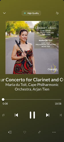

Started streaming “Colour Concerto for Clarinet and Orchestra“ on 2026-05-19 at approximately 16:13 (CST).
