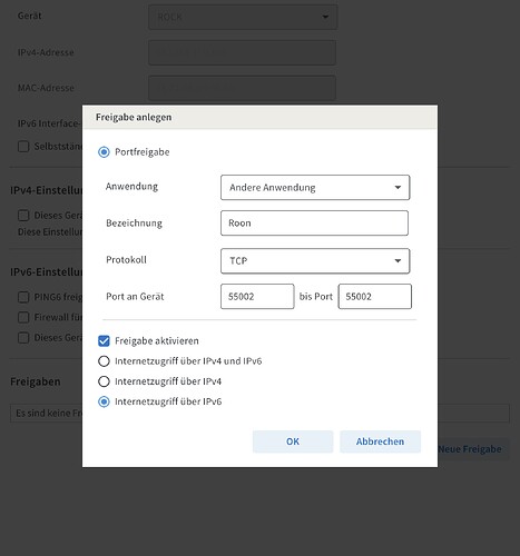

As to your questions: The router is not in Bridge mode, I only have the Fritz Box plus one Fritz mesh repeater.
Port was opened and the number matched Roon. I will try again, but yesterday, right after installing ROCK OS 258, it did not work.
Maybe one of the Fritz Box experts like @Suedkiez have an idea?
Thank you in advance!
Port 55002 matches with the App setting of course.
It is a manual setup. Changing to both does not bring a positive result either…
