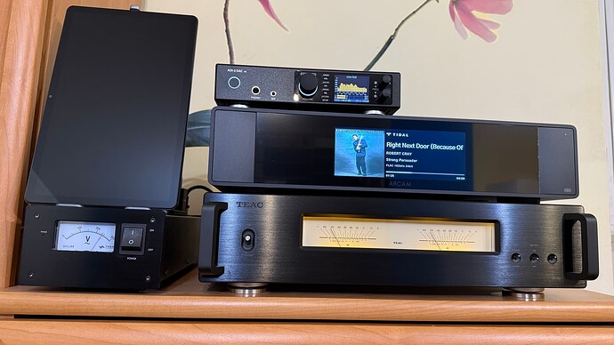

Would you mind posting couple pictures of it?

Thank you!
Indeed very well made unit, looks really great.

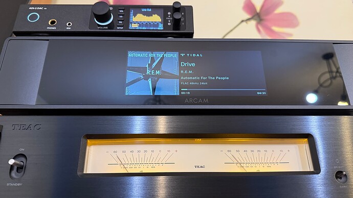

Arcam is not Roon Ready yet. In the Tidal app, this album is shown as High quality, which I get during the playback via Tidal Connect. For the R.E.M. - Automatic For The People album, I can pick Max quality.
Also, Arcam displays different bit rates and depths when playing the R.E.M.'s album with High and Max quality. I have no idea, if it is MQA, though.

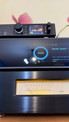

Awesome, thanks. I downloaded samples from Blue Coast Music. Arcam ST25 played all 10 files from USB. DSD files worked terribly, though. There was more noise than actual music. It is easily audible and visible in my RME’s spectrum analyzer. It does not happen during playback from PC, so I gues it is an issue with the Arcam. MQA file worked fine.
RME only supports DoP for DSD from Linux which the streamer will be based one and it looks like the Arcam is converting it according to the Display. Or perhaps thats encoding to DoP? Hard to tell. What does Roons signal path show for the DSD files?
It was played from Arcam’s USB input, not Roon, as Arcam ST25 is not Roon Ready. Playback worked fine from my Windows PC, but I just recalled that it converts digital output. Thus, I am unsure if this noise was Arcam’s or RME’s fault. However, there is no noise when I use Roon to stream these DSD files to a HiFiBerry Digi+ endpoint and then send the signal to RME. I can also test with a Macbook. I am not sure if it can send DSD natively via USB, though. Or maybe I should simply Connect Arcam with Teac Amp directly via analog? Then it should be clear if it’s Arcam’s fault or not as RME will be omitted in the signal path.
EDIT: When the Arcam is connected to Amp directly via analogue, the noise is gone. Looks like RME’s issue then.
The arcam will be using a Linux os all these devices do to some degree. Does the Arcam support DoP for DSD content out of the USB. The RME won’t play native DSD from non windows machines. As your hearing noise this indicates it’s outputting a format DAC can’t decode.
