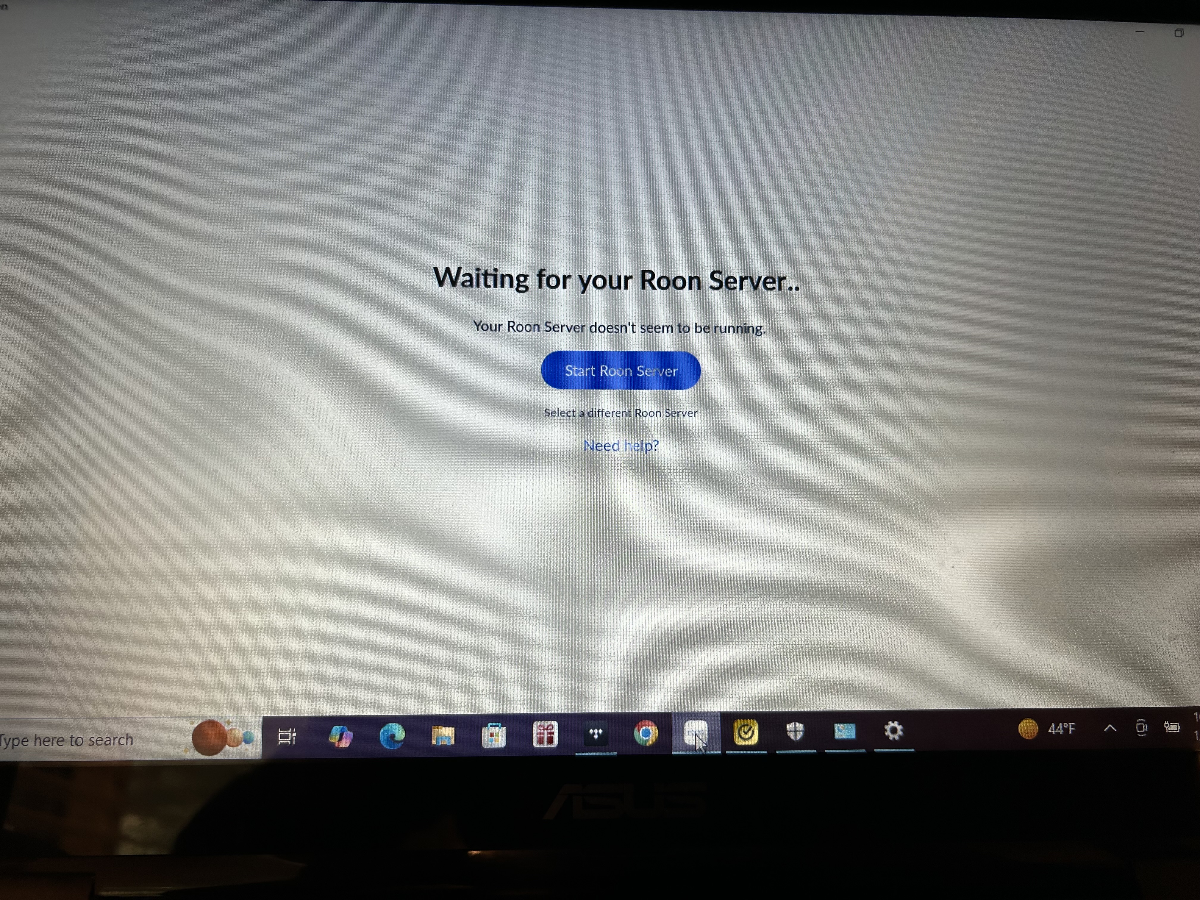

Thank you for the kind, patient assist. My core, an ASUS laptop with Windows 10 (8gb RAM and 237gb storage), has worked flawlessly with my iPhone 14 remote until yesterday when I got the following message when I click on the Roon app from the core: Waiting for your Roon Server. I’ve tried clicking on Start Roon Server, but that path takes me back to the Waiting for your Roon Server message.
I’ve looked at messages from community members who have bumped into this problem, and I’ve browsed the knowledge database. From there, I’ve tried rebooting my router (AT&T BGW210-700) and the core (the ASUS laptop) with the Norton 360 firewall off (with Public and Private selected for RAATServer.exe, Roon.exe, and Roon appliance.exe in Windows Security and with RAATServer, Roon, and RoonAppliance allowed under Program Control in Norton 360), and I still get the Waiting for your Roon Server Message.
Should I try a reinstall? Should I delete Roon from the ASUS laptop core and reinstall it for Windows from the Roon website?
Is there something else I might try? I’m not sure what changed from Tuesday night, when Roon was working like a charm as it had been for several years, into Wednesday morning when I began getting the Waiting for Your Roon Server message.
Thank you for your kind, patient assist with this request for support. Thank you for creating and supporting Roon, which I thoroughly enjoy. Kudos to the team.
AT&T BGW210-700 (WiFi router) and ASUS laptop (core)
