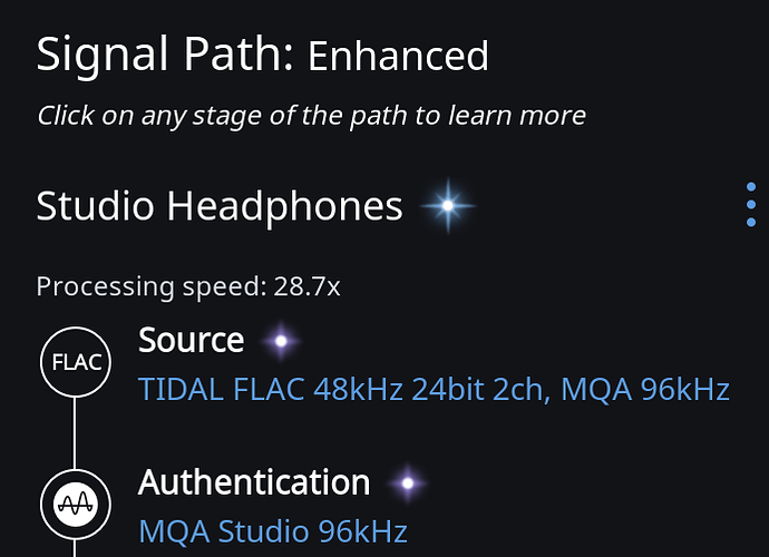

Here the path of the David Byrne’ song (similar to the Nirvana)
