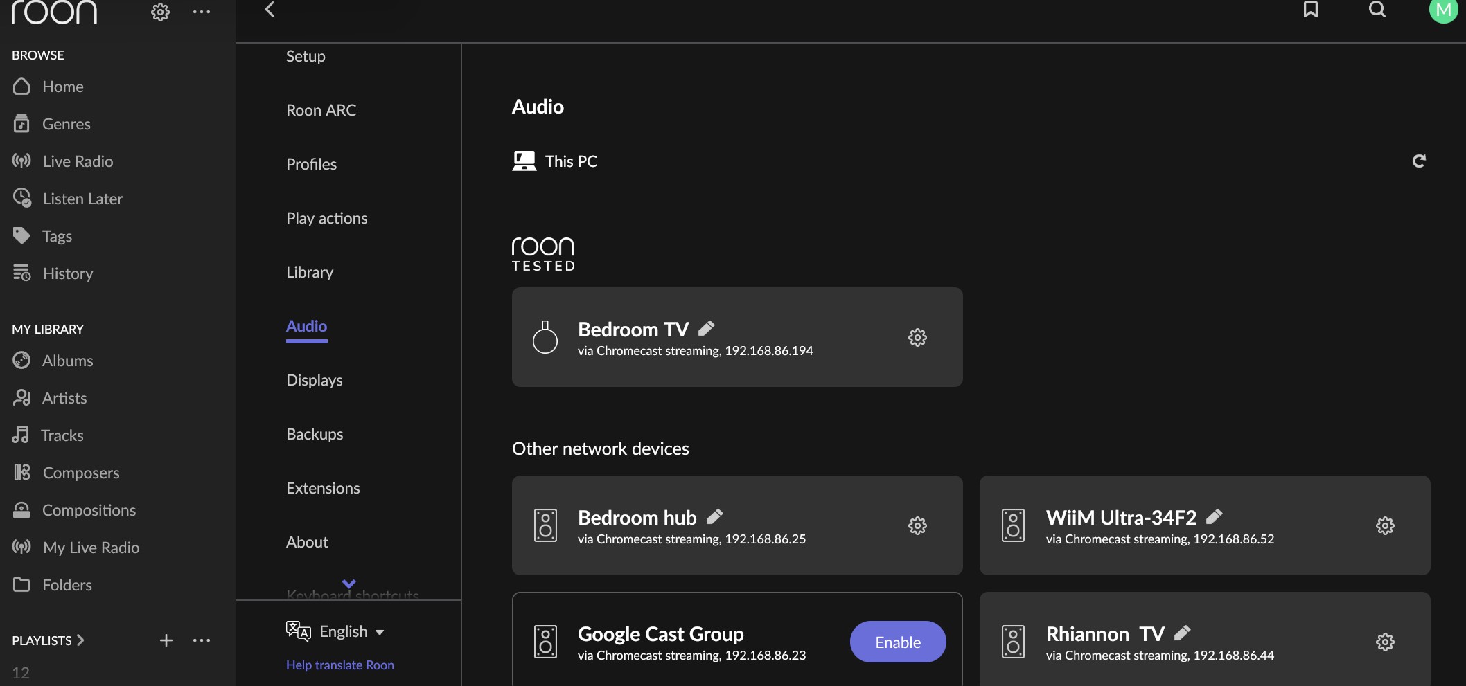

There are no steps involved, the app simply doesn’t work suddenly. The only other thing I notice is the constant resetting of the audio page
