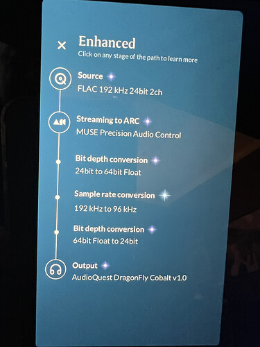

And this is Roon ARC playing on my iPad Mini 6 through a USB connected DragonFly Cobalt through my speaker system. The Cobalt down samples to 96/24.
