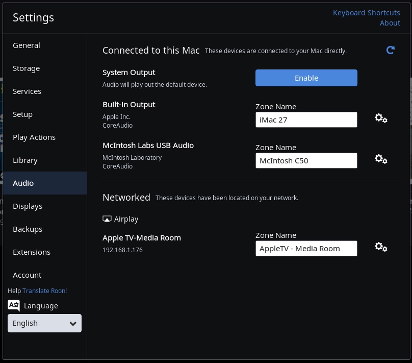

iMac 27, Late 2012, macOS Mojave 10.14.3, 2.9 GHz Intel i5, 8GB/ ROON Version 1.6 (Build 401)
Wired network/ Ethernet connection to iMac
iMac 27 (ROON Core) > McIntosh C50 Preamp/DAC via USB > McIntosh MC452 Amp via XLR cables > Speakers

20%20PM (upload://iXTnmL0yT12SwiF9RngfLQXz2vQ.jpeg)

If it is limited to the Imac then I’m thinking that something else on the iMac is having issues with Roon. Based on your screen shot, I am assuming that this iMac is not a dedicated RoonServer. Are there other programs running at the same time you are listening to Roon or are you using the computer doing other tasks?
