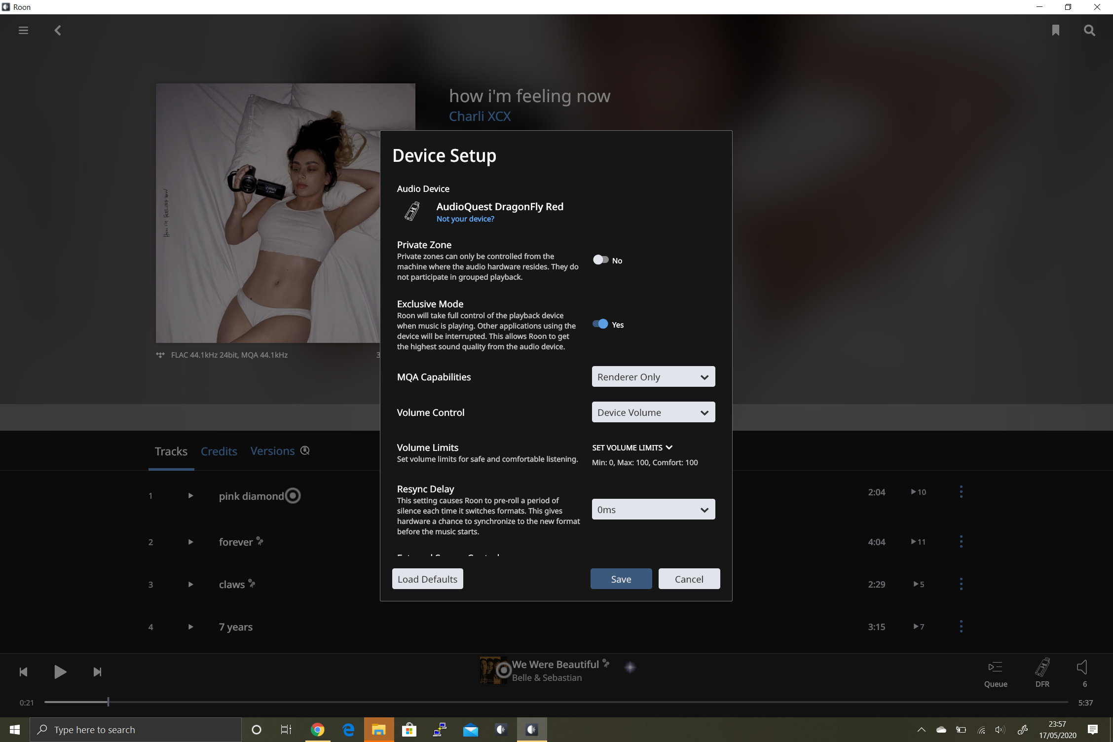

What are you using it on? If you on windows or mac, ensure Exclusive use is selected. Unless your upsampling it should switch colours depending on the source if in exclusie mode. A solid light indicates its using system audio to control it and it will set it at the highest and resample every thing to that rate.
Heres mine on my laptop which I am listening to right now. with signal path this will change with each samplerate/bit depth of whats playing.
settngs are
Makes sure also you not resampling.

Show you signal path it will indicate what its doing. Any lossy files such as mp3 or aac are decoded to 44.1 Khz 24 bit. They dont actually have a sample rate or bit depth due to the way the codecs work. So Roon does what it things is the best quality for them. Not sure why its showing as blue but sounds like you mac is outputting at system audio to me or its upsampling in Roon somewhere.
