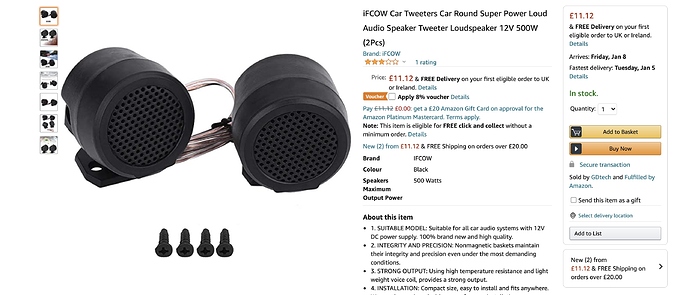

That is not a ‘super tweeter’ like those available from Townshend and the like. These are cheap speakers intended for car use, like the ones you probably have installed in the A-pillar of your car.
Something like this, at $15, is not going to enhance your audio experience and as has been stated could damage you DAC.

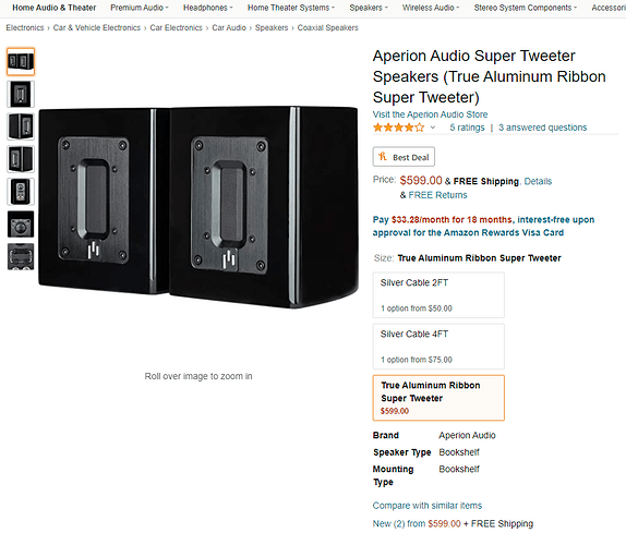

These $600 tweeter speakers. :slightly_smiling_face: I think the DAC will be overpowered, I better don’t use both the O/P’s.
Thank you… I think that is the best course of action…
That’s what I got when I clicked on the link … hence my post!
Strange… Below are the tweeters…
Strange. I got an ad for a pair of interconnect cables with a link to some generic bullet tweeters.
