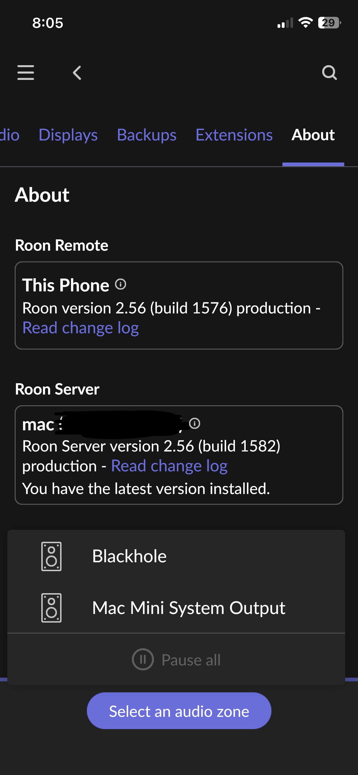

I read the change log for 2.56 (Build 1582) and noticed that an issue where audio zones are lost during Roon’s update process on MacOS was resolved. I’m unfortunately still having the same issue, and have consistently for the year I’ve used my Mac as a Roon server. Following an update of Roon, the server comes back online but Roon remotes only display the Mac’s own output. I have to shutdown Roon server via the Menu Bar icon at the top of the display on the system running the Roon server, then relaunch the service.
Mac -> (very close to) TP-Link Omada EAP650 wireless AP -> TP-Link Omada managed Switch -> Firewalla Purple router -> ISP cable modem. Local wireless network sustains 700Mbps up/down where the Mac is located. Wireless APs are connected to the switch via Ethernet.
Network endpoints are Apple TV and Cambridge Audio AXN10 streamer, both connected wirelessly.
Blackhole is an audio loop back device driver installed on the Mac running Roon server.
