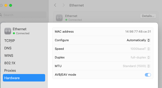

I had the same issue: could only ‘see’ AirPlay2 connections. After stumbling around a bit, I changed:
Ethernet (in settings, of course)
Details
Hardware
I found that “Configure” was set to Manual. I switched it to automatic and my endpoints popped back.
Your mileage may differ, of course.
