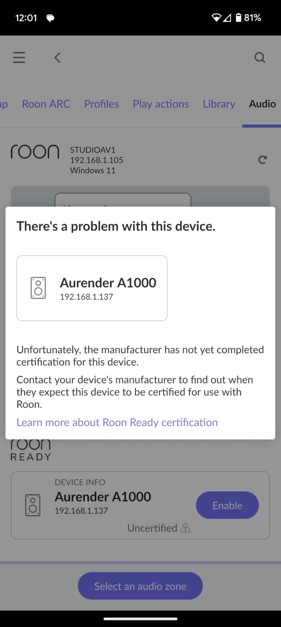

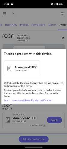

Yes under settings-audio it appears in the Roon Ready section but with a note saying uncertified with a little warning triangle.
On selection of Enable a message tells me the manufacturer has not completed certification and so I cannot select.

Thanks for the screenshot. Just to confirm, the model on the unit itself shows as A1000, is this correct? I noticed in your previous log that an Aurender N20 SPDIF was showing up as a A1000 via USB. I tried to enable diagnostics for your Nucleus One but I don’t see it as currently online, when you have a chance, please turn on the unit and let us know so that we can check logs there as well.
