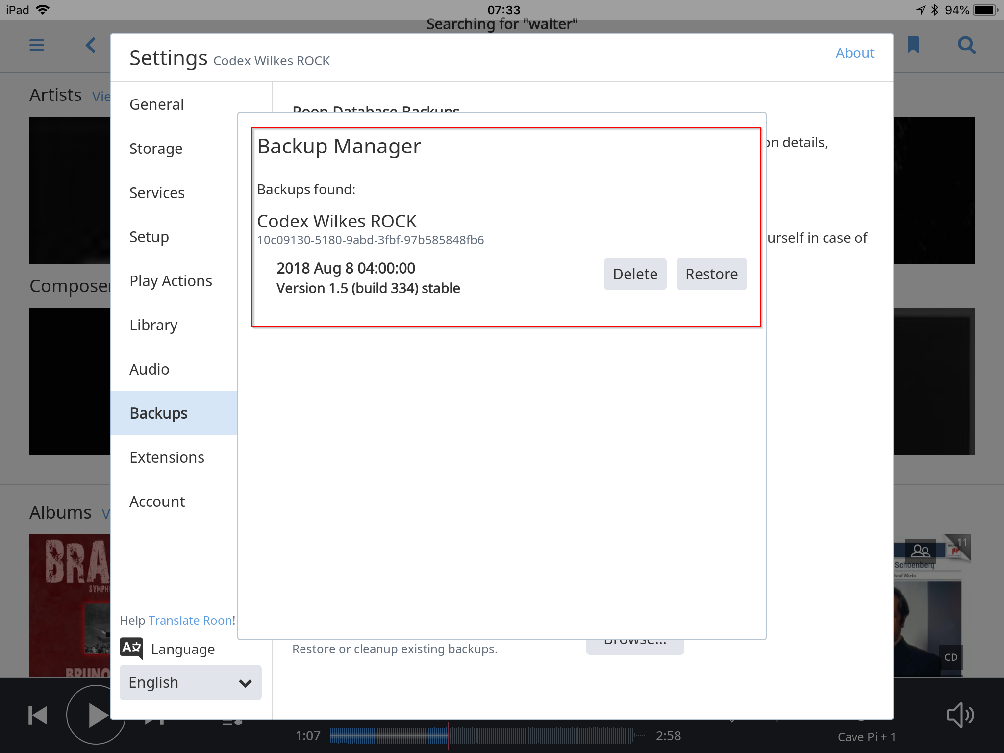

@noris, thank you for the update. As requested, I have started a new backup schedule in a new empty folder, and this seems to be successful:
Obviously, I’ll wait for the next event in a week, and let you know. (I decided to not set a more aggressive schedule and then edit later – I wanted the generic use case.)
I would like to comment on the GUI though. When one views the summary page, in my case the status reflects the last manual backup rather than the latest successful backup (which was via a scheduled task and more recent). I’d suggest either separating the two processes, or (better) reflect the latest backup (and maybe indicate whether manual or scheduled). Let me know if it would be helpful to mock this up.
