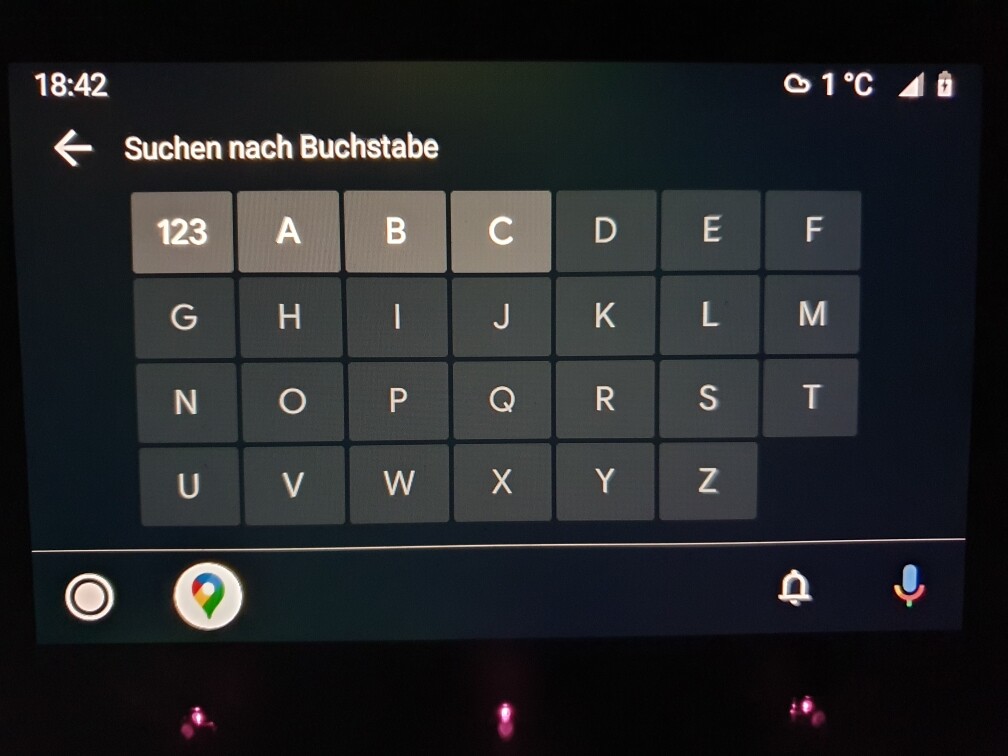

My first findings with B130 ARC on Android Auto:
Seaching for “Artists”: Only Artists “123 - C” are shown (I have 962 artists in total) - see photo:
When I go to any of these shown artists, only some of the albums are shown …
