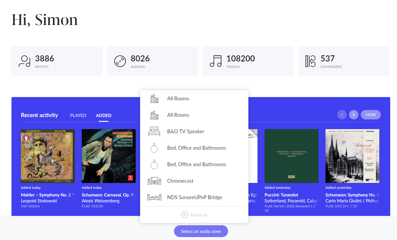

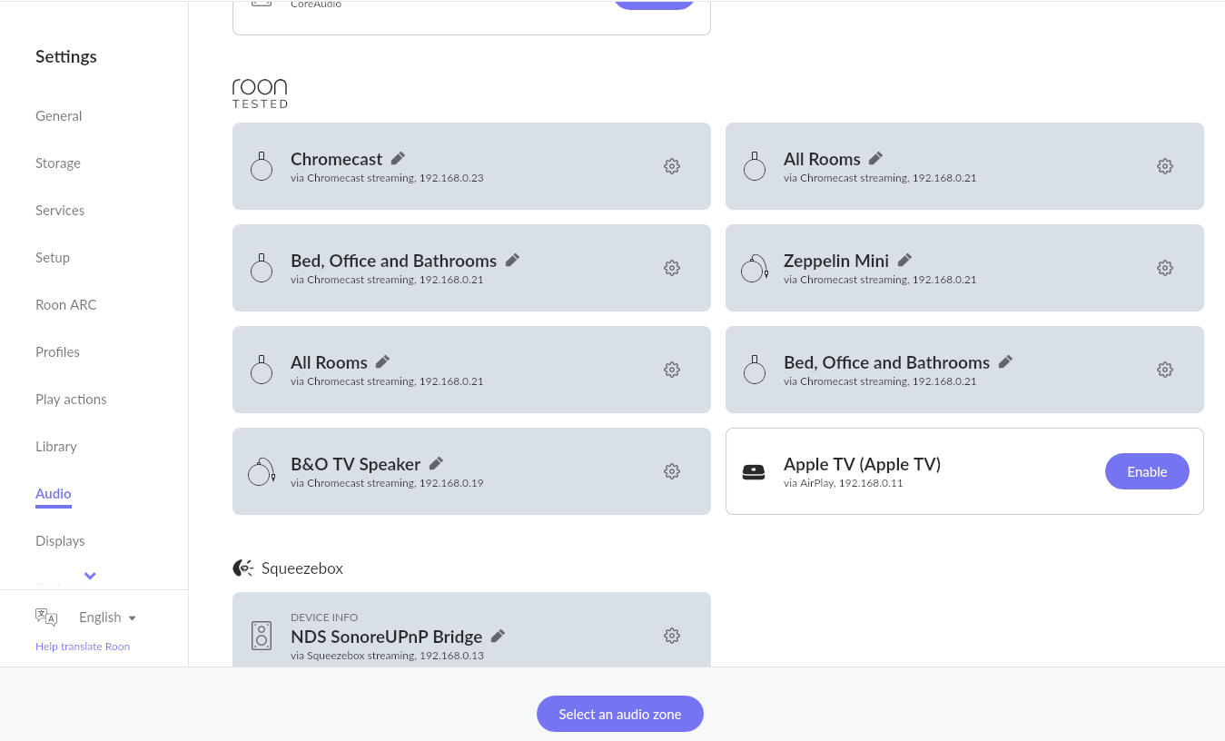

Hi, Getting duplication of Google Chromecast Groups with this latest EA Build.
This has been a recurring issue, reported here Duplicated Chromecast Groups [Ticket In] in October '22, so its coming up to 4 years.
The latest entry on that thread was there is a fix coming, and then the thread was closed, without any further confirmation on the resolution of the issue.
As you can see below, it is not resolved.
All of the Chromecast devices are on static assigned IP addresses in the DHCP table, they are powered on 24/7, self managing in terms of FW updates (i.e. latest versions) and all on the same network as the Roon Server. The network only has 1 WiFi Access point, and the devices are connected to the same SSID.
I understand from the investigation that a stale ChromeCast group gets created but Roon is not distinguishing this group from the active group.
