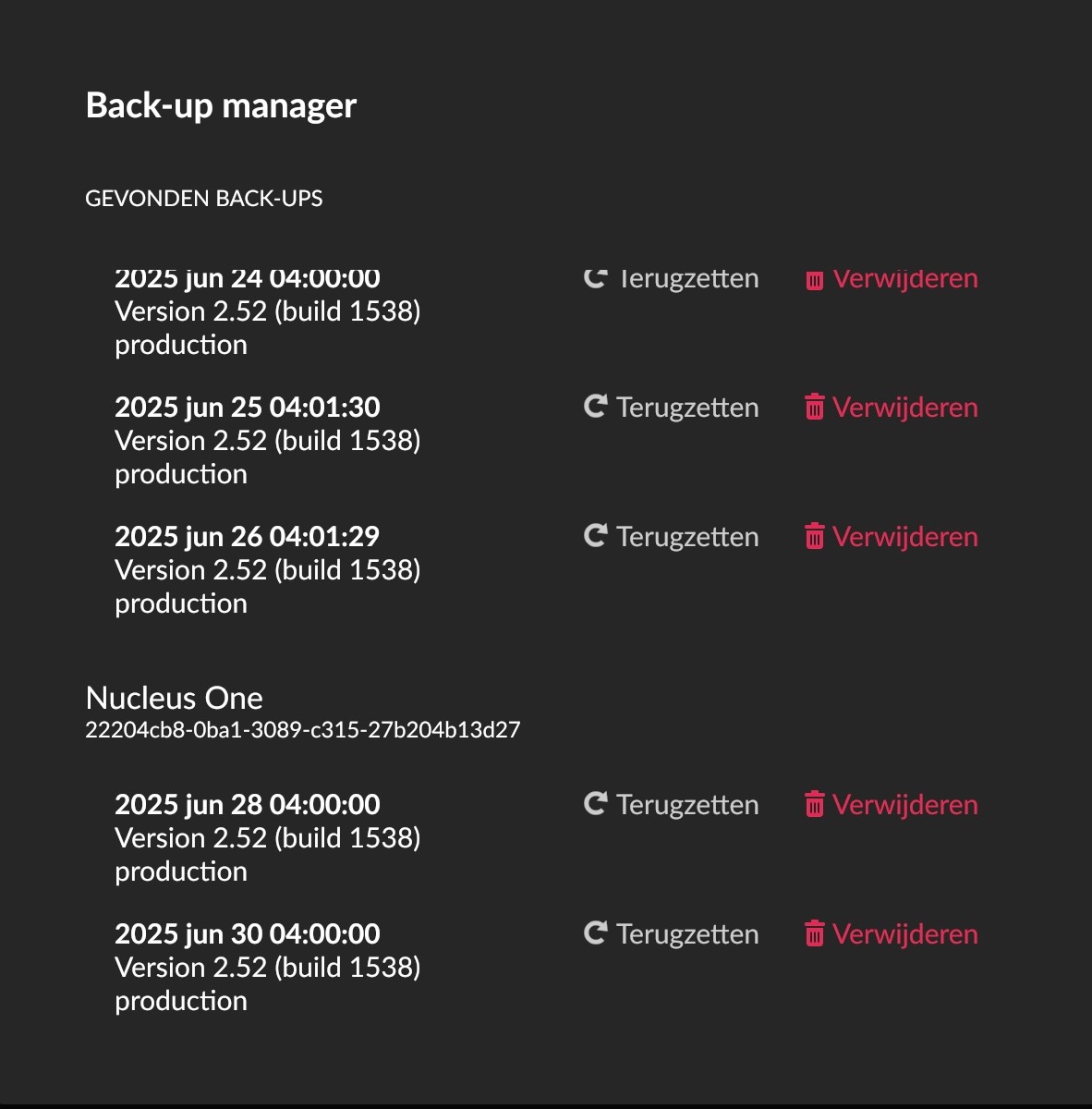

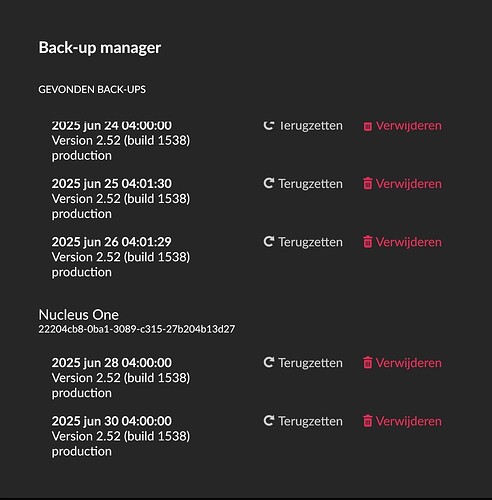

The Nucleus One skips back-ups for no apparent reason (see screenshot below):

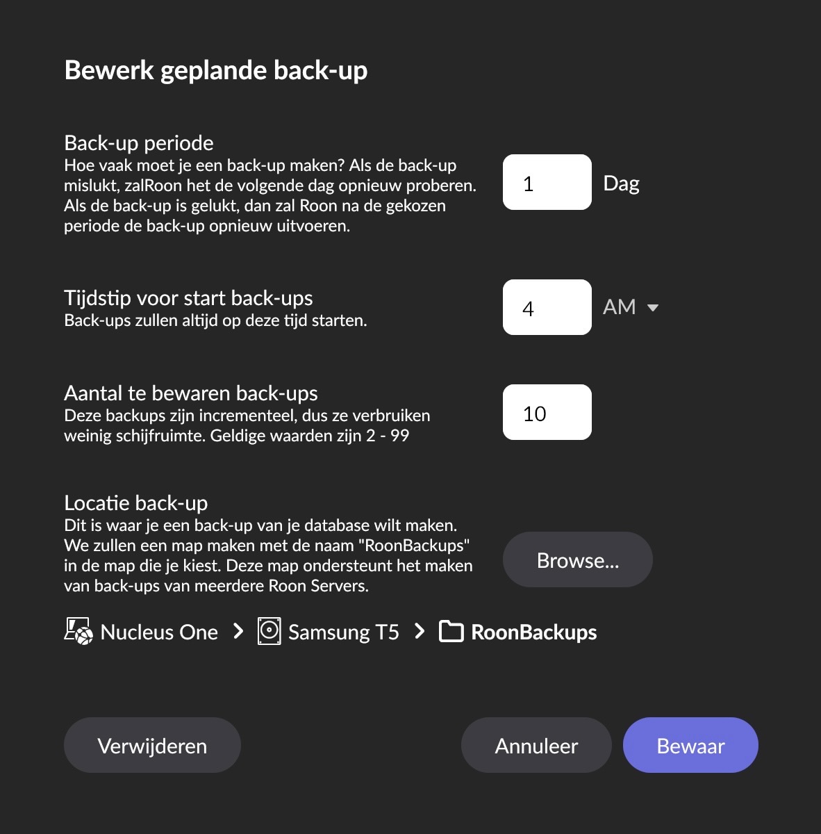

As you can see no back-up were made on the 27th and the 29th of june. This is just an example of the past week. It happens every week that 1 or 2 back-ups are randomly being skipped. To be clear, according to my back-up schedule (see screenshot below) back-ups should be made daily.

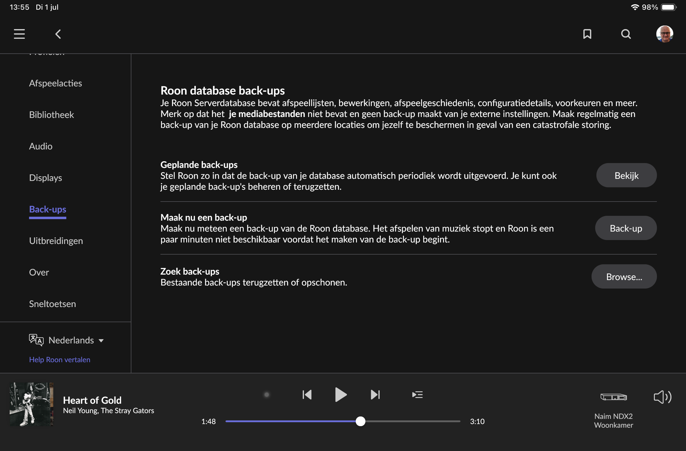

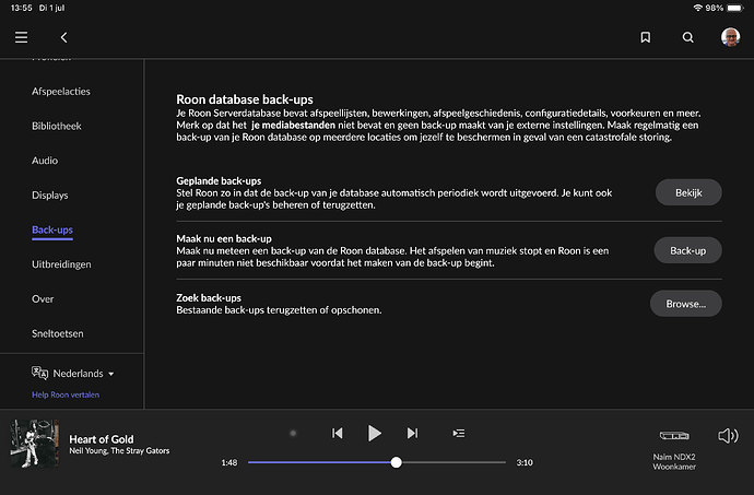

Just another user here, but could you post a screenshot of the Backup screen that you initial open in Roon settings.
I’m curious to see if there is an error message in red.
If there isn’t, was there an error that you dismissed to remote it?

There never has been an error message, I didn’t remove such a message. Yes I have the 4GB RAM which was originally supplied.

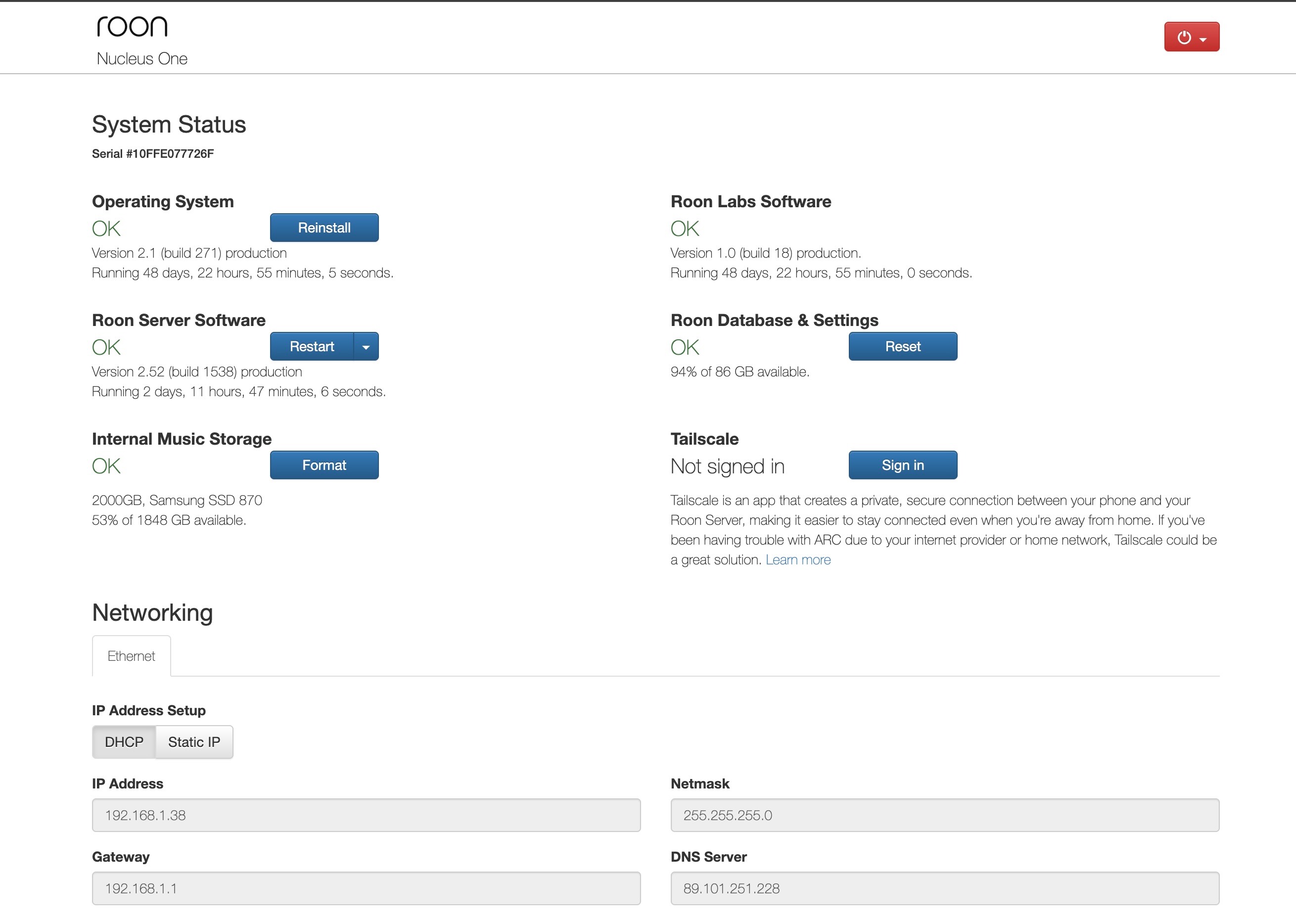

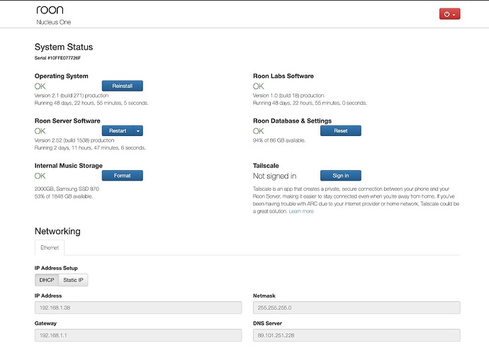

Could you post a screenshot of the webUI for the N1?

Here’s the screenshot you asked for.
No, I wasn’t playing any music at the time of the back-up. I scheduled my back-ups at 04.00 a.m.
Thanks for sharing.

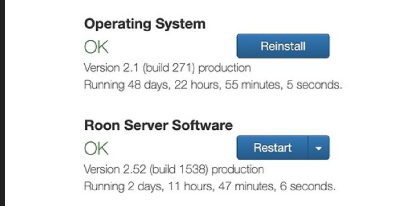

I was curious to see the running times for RoonOS and Roon Server.
There is a huge difference between the two.
Upon a reboot these are usually a few seconds apart.
I suspect Roon Server is using up all the RAM and causes Roon Server to crash.
The lack of an error doesn’t make my theory hold up though, but you have a Nucleus device, so things could differ slightly with the Roon Labs Software.
I had the same experience during the recent issue with a memory leak. All usable RAM would get used and cause Roon Sever to crash. I could see the RAM use by running Roon on DietPi.
So when I tested it on Roon Rock and had the same experience I knew what was occurring.

Thank you for your input. I cannot account for the time difference and I don’t know if it matters. I guess the Roon guys will know what’s going on.

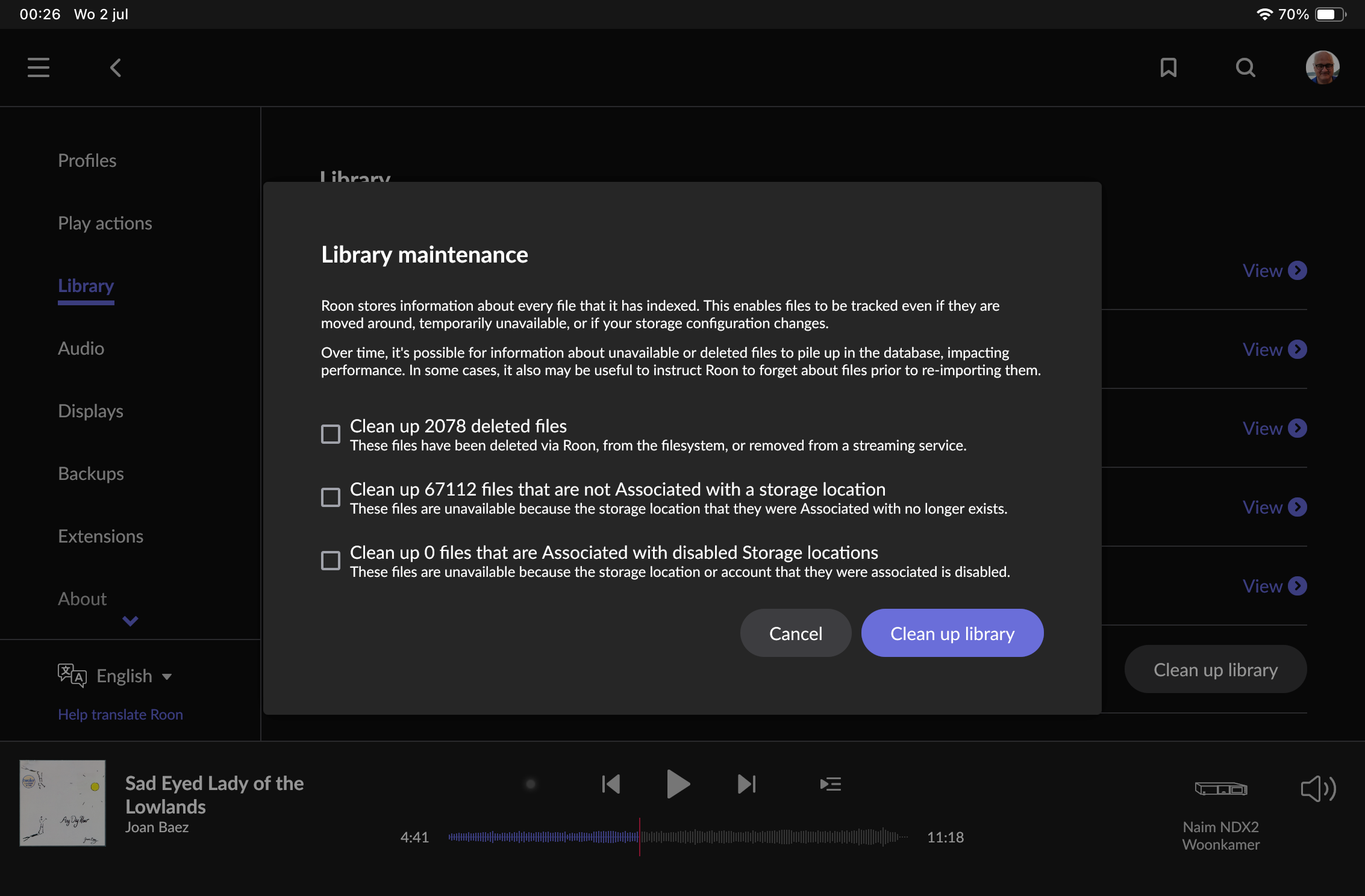

If you navigate to Roon Settings → Library → Clean Up Library, do you see a large amount of items listed there? I am wondering if you have old items from a previous media location that could be taking up library resources.
See screenshot below:
Is this what you were looking for? Is this causing the problem?
Hi Norris, I posted the screenshot you requested in the thread dedicated to my reported problem. I forgot to post it in a specific response to your request.
When installing a Roon Server update (i.e., most updates) on Roon OS, the server restarts but the OS does not, so the OS uptime is usually longer and that’s not generally a problem.
I does show that your didn’t reboot the Nucleus in this time, so may be worth a try.
