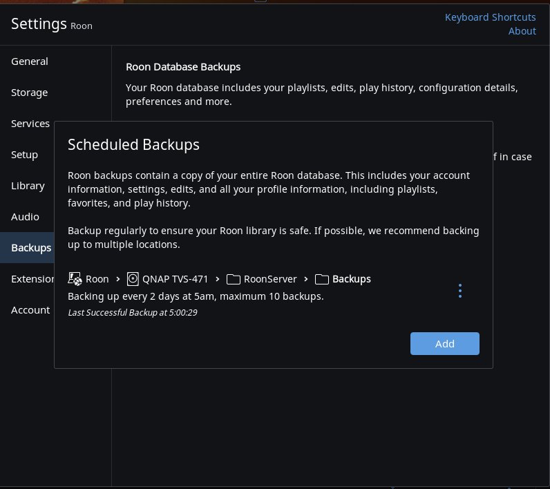

Can you post a screenshot of your scheduled backups settings of Roon? Like this one:
Yes, I put the back ups in the Music folder. Guess that’s a no-no?
