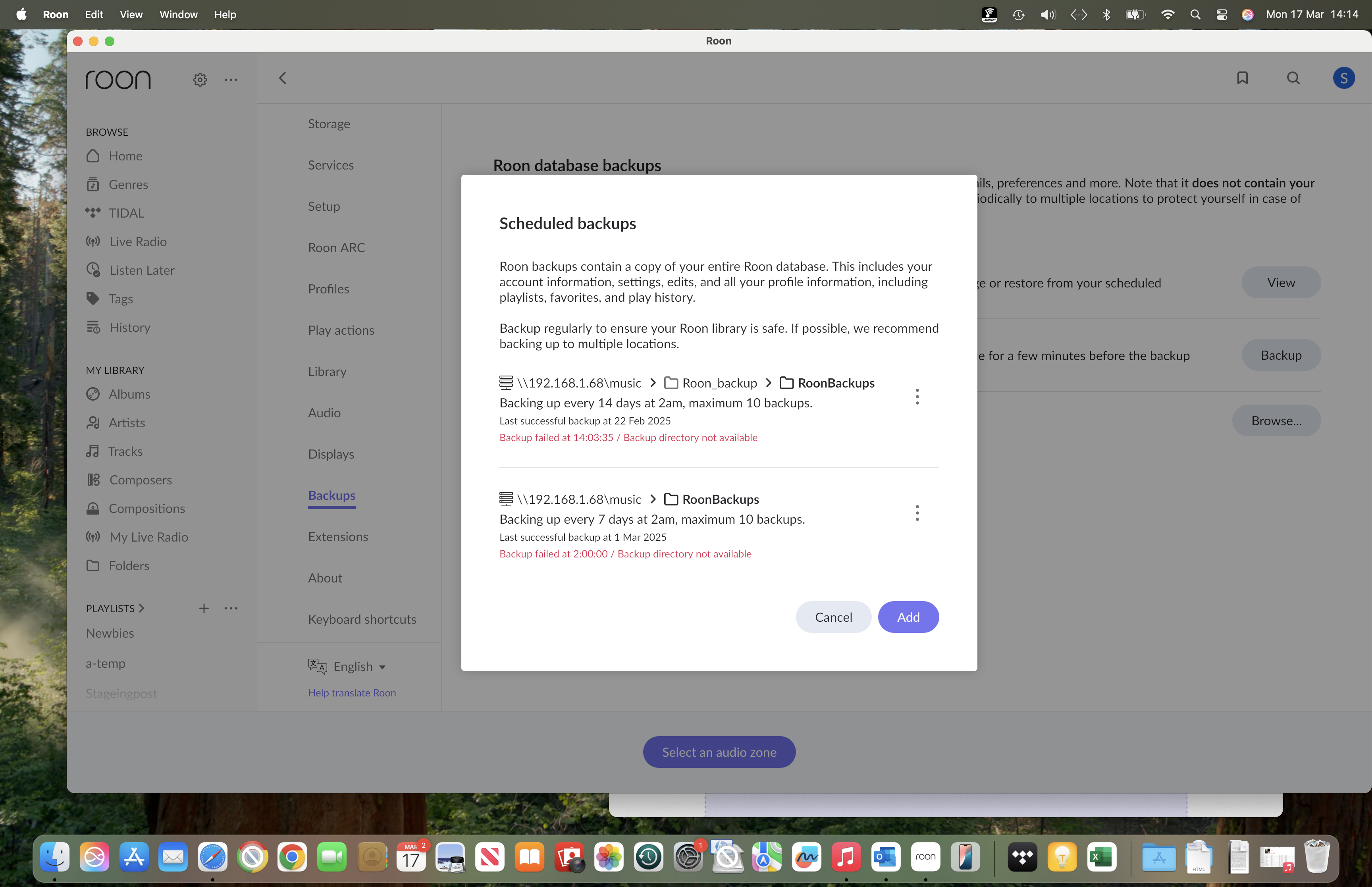

these have been working successfully from my nucleus to \\.....\ Roon_backup > RoonBackups and RoonBackups on my MacBook Pro for a couple of years. I recently upgraded my mac os to sequoia 15.3.1 and now I cannot backup.
Error message 'Backup failed / Backup direc tory not available'. I have changed nothing - why is this happening ?

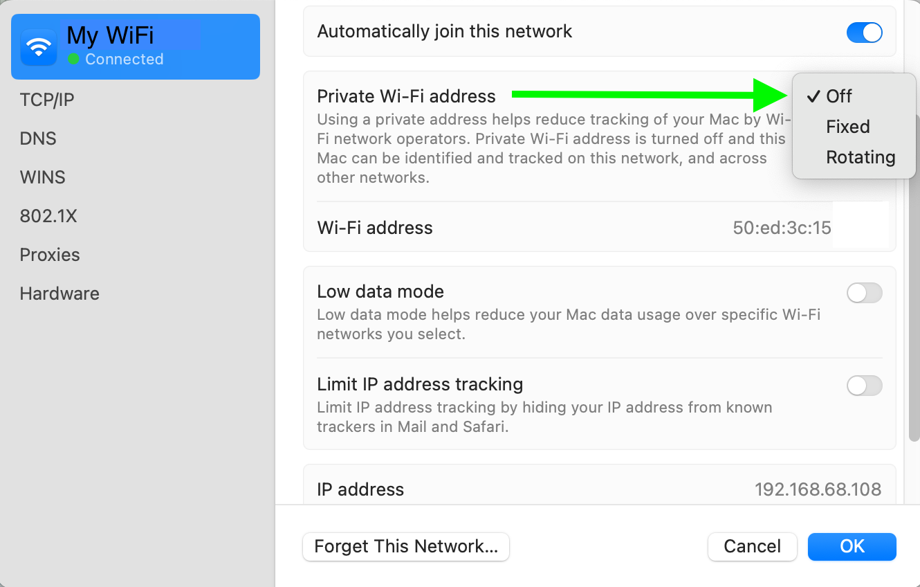

In my case, the update switched the Private Wi-Fi address setting to “random”, which changed the IP address of my Macbook and broke my backups. This may be the cause of your issue as well.
Give this a try:

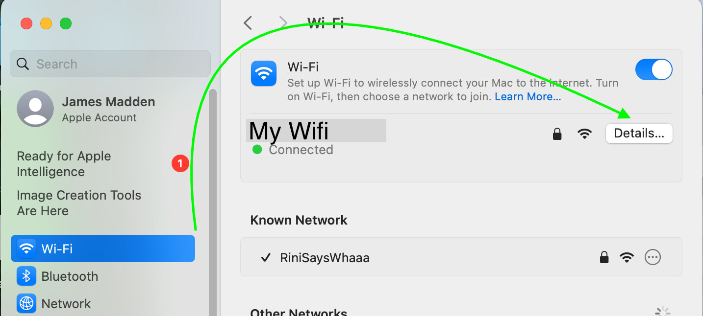

Open your System Settings and click Wi-Fi
Click Details

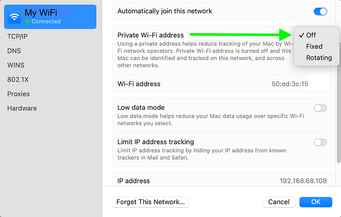

Check your Private Wi-Fi address setting, and switch it to Off
Click OK
After doing that, it reset my Mac’s IP address to one it had before the update - and my backups worked again. Hope it helps you as well!
