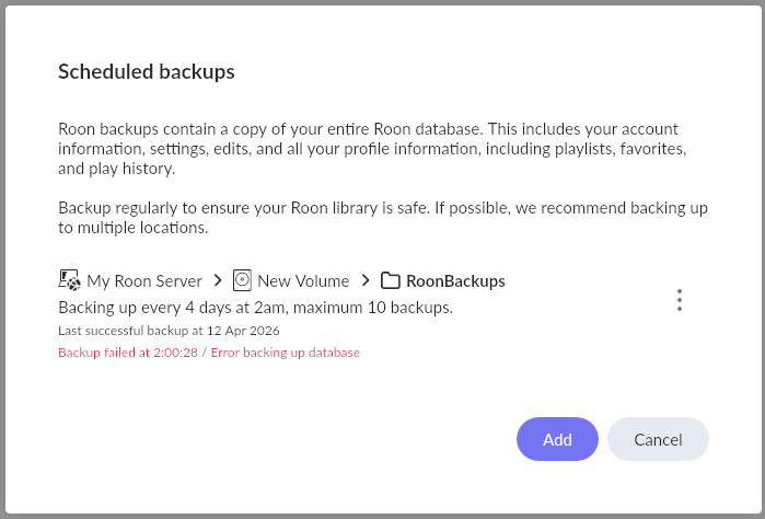

· My last successful backup of the Roon database was on the 12th April. Since then, scheduled and manual backups fail with "Error backing up database".
Backups are from a ROCK/NUC system to a USB-attached SSD that has plenty of free space.

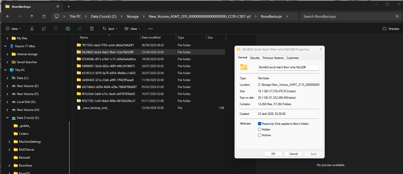

  1. I assume that the size of the last successful backup is that of the folder dated 23/04/2026, even though the last successful backup was made on 12/04/2026 (as shown in my first screenshot)?
Then the size of that folder is 16.1 GB or 29.1 GB (see the screenshot)
