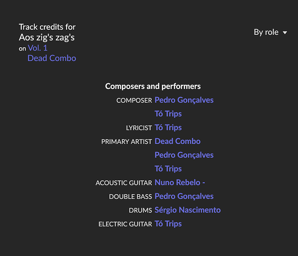

this resulted in a spurious - in the artist name, for example:
Screenshot - 11_09_2024 , 09_31_25
now… i corrected the file tags, i’ve rescanned the album, i tried to delete the album and import it again in roon… : but the artists name keeps that way.
Any solution?

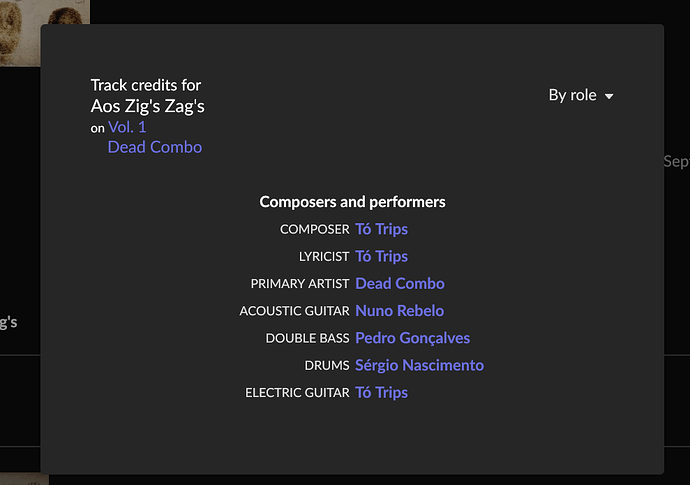

Thanks for sending the file over. We tried to reproduce using that file, but we were not able to see the same issue on our end:

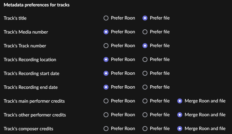

Can you share a screenshot of your Roon Settings → Library → Import settings? What is strange is that I do not see the artists you have in your original screenshot at al. It appears to be the same album, but the artists listed on our end are very different, they also look fine in the File Tags manager:

you cannot reproduce it because i have corrected the file tags. and as your import of the file has no problems, it seems that there are no hidden wrong tags.
you can try to reproduce the problem by editing the file tags on that (or any) file.
in the personnel tag, put a double space after the - in the line
ARTIST NAME - ROLE
on my system, this result in a name like “artist name -”
for that track
so see that the credits are similar to those in your screenshot (my original screenshot was the credits for the whole album).

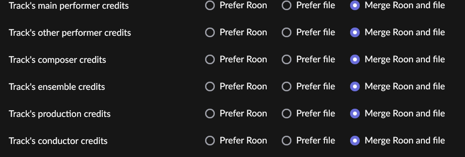

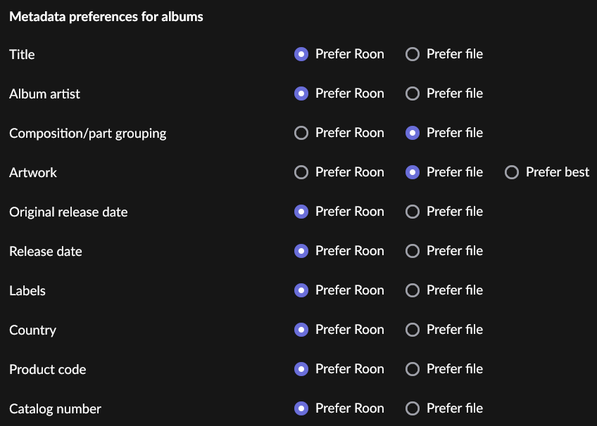

my settings are
