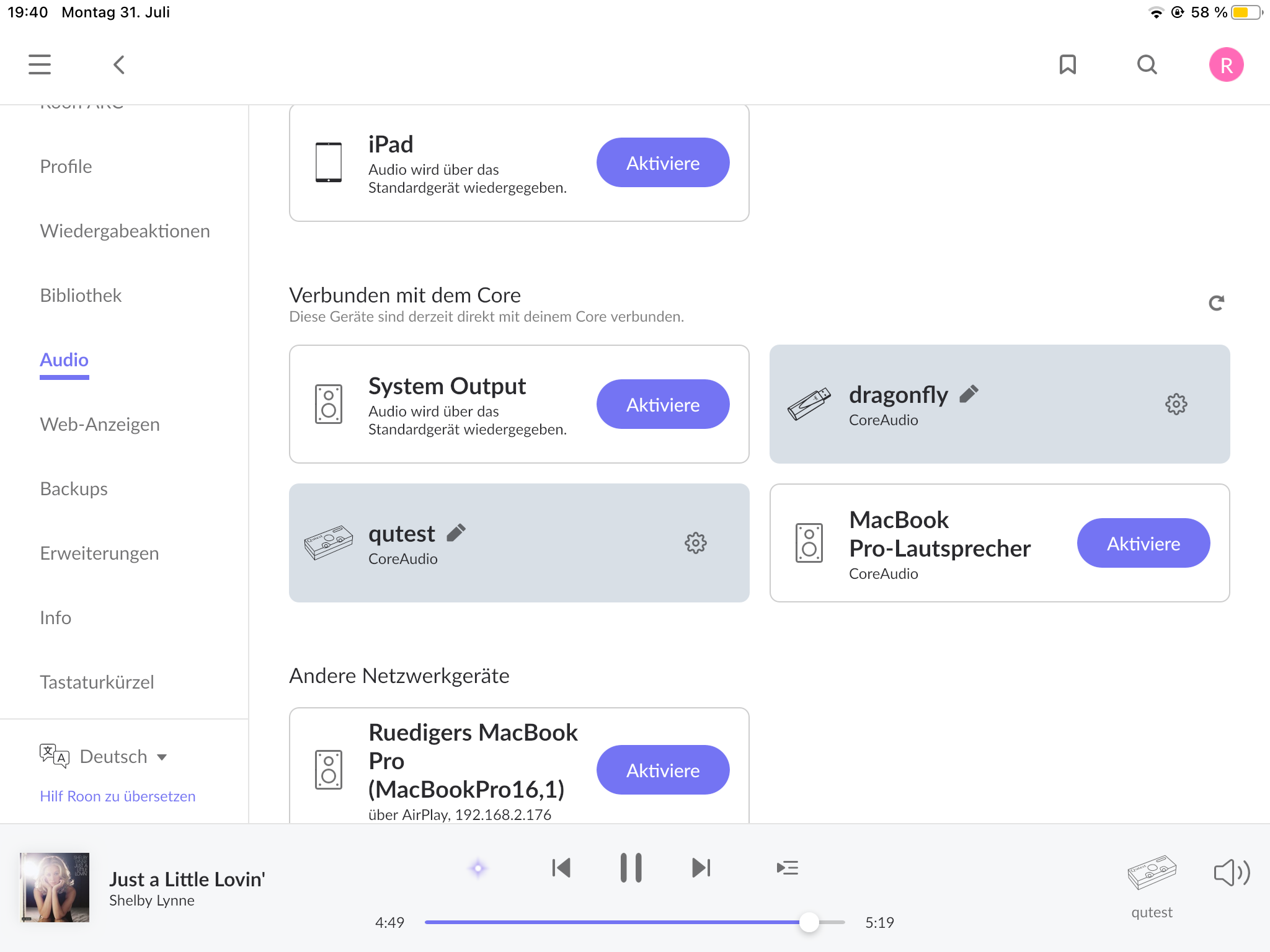

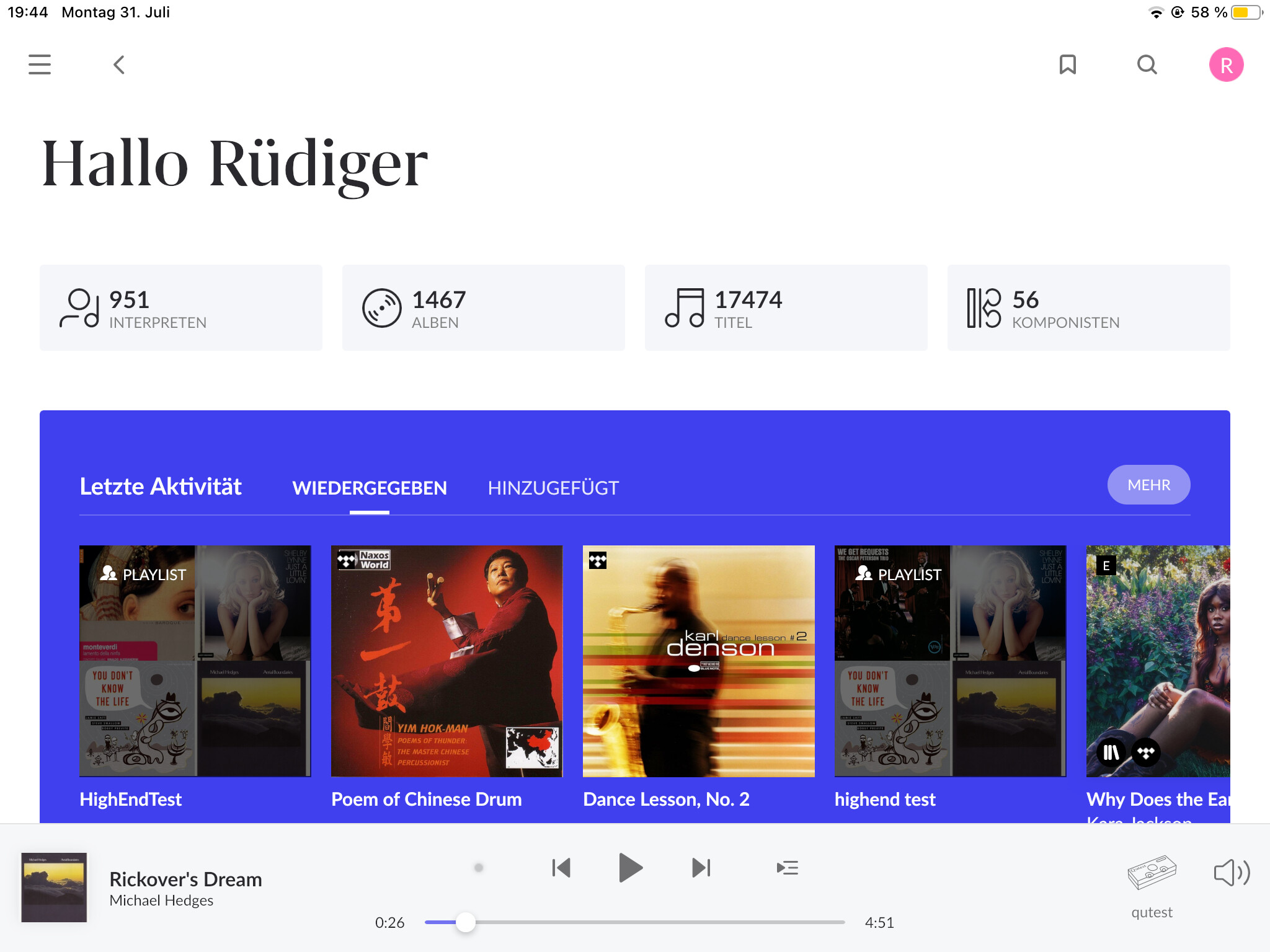

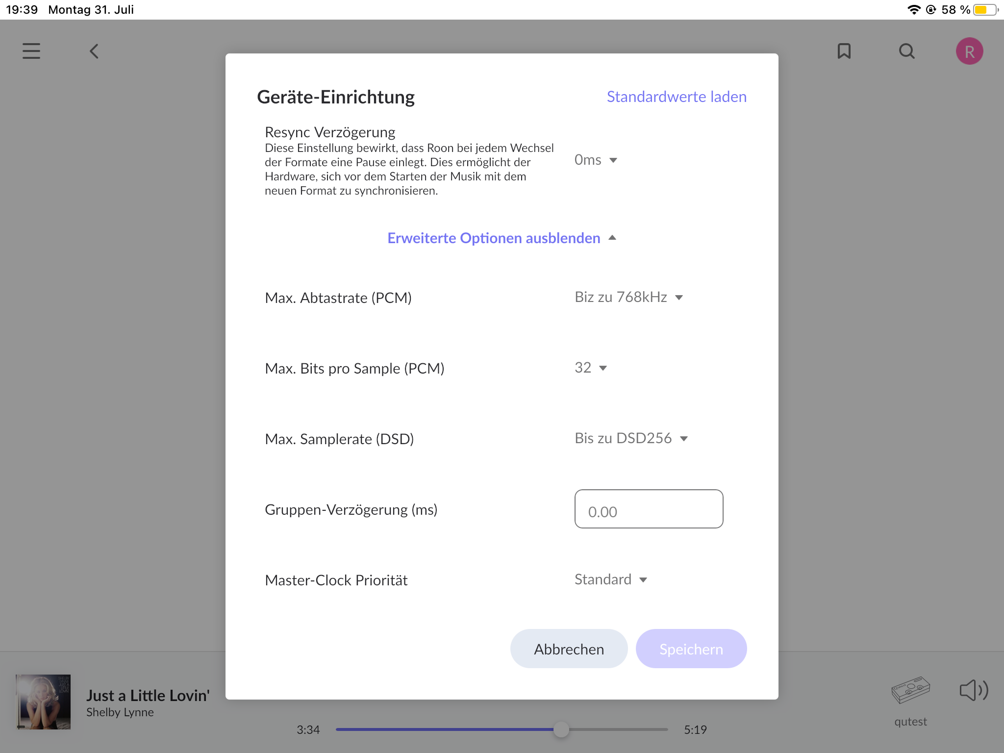

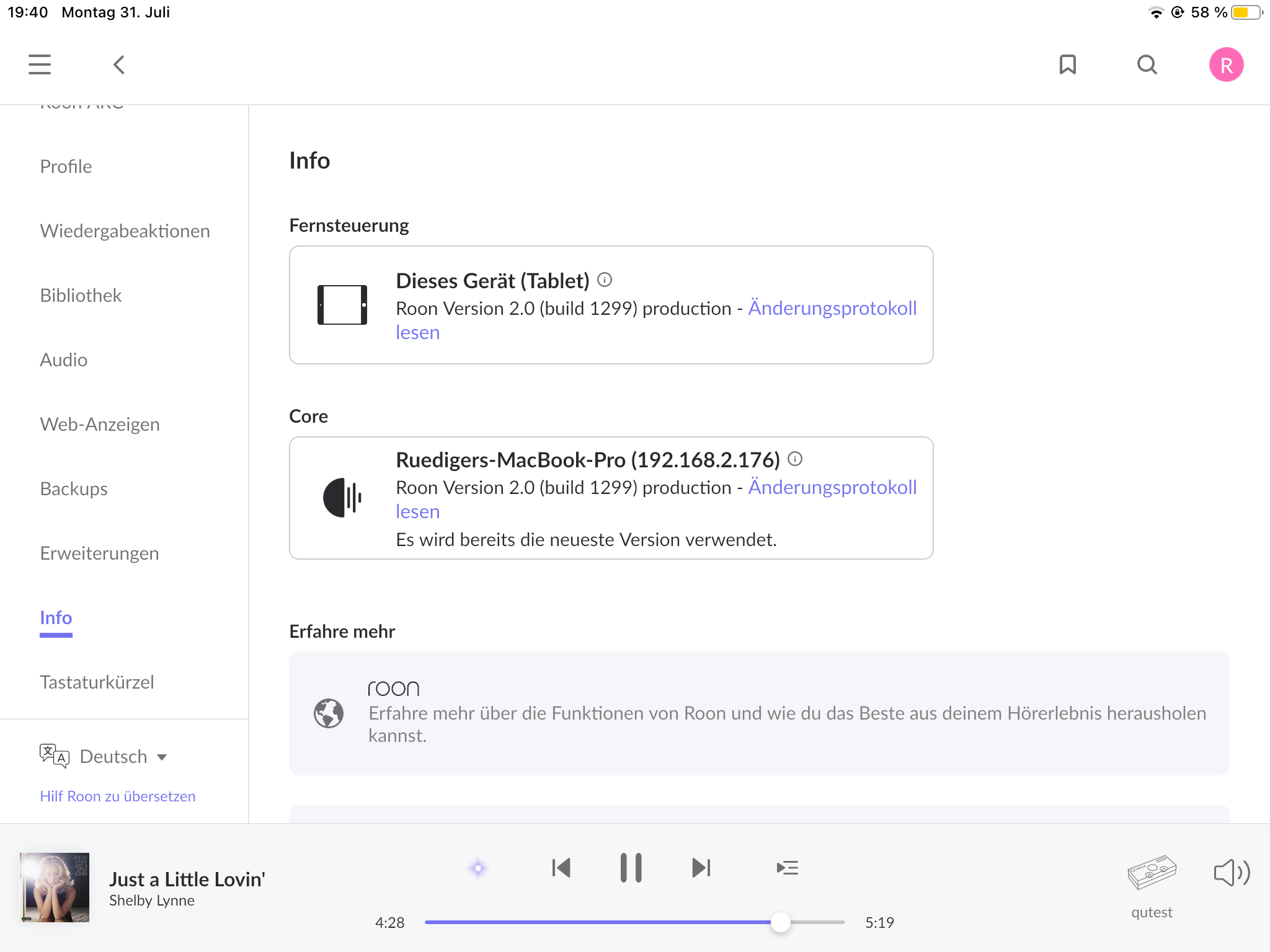

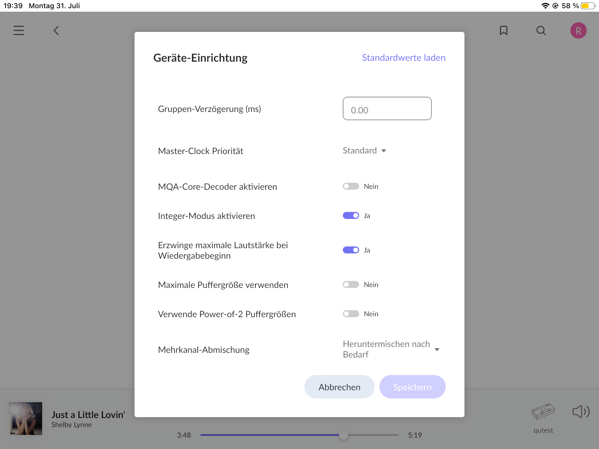

Here are some screenshots from my iPad. Perhaps ist can help.
