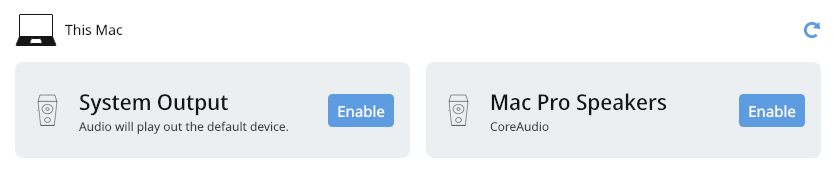

this is a very basic question and I didn’t see it answered in the setup FAQ or searching the forum. I’ve installed the Roon application (not server) on my Mac and when I go into the settings/audio I notice there are two choices (see below) to select from to set up a Mac for listening. I have a Nucleus+ setup as the Roon server. My question is, what are the pros or cons of selecting between the two choices. I have just a plain Jane Mac device, no special hardware connected, etc. Any recommendations? Cheers.

Mac Pro Speakers is the built-in output and this is the one you probably want to use. However, Roon will have exclusive access and control of the hardware device. With System Output you’ll hear system notifications and other sounds.
Here’s a fuller description.
Many thanks @mjw for finding this. Exactly what I was looking for. Cheers,
