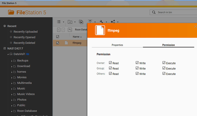

Thanks so much for all the detail. I think I’ve managed to do it but the error still remains. I have done a few more screen shots so you can see if it looks lik eit’s in the right place.

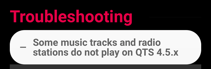

I see the troubleshoot instructions say to restart the server. I have refreshed the QNAP app centre, and closed down and reopened Roon (I can see it now says its using a ‘user supplied ffmpeg’ where before it said ‘default’. Is there anything else I need to do to refresh the server?

Looks alright to me. Not sure why it doesn’t work. I’d restart the whole QNAP just to ensure that everything that might be relevant gets restarted.
I’ve just restarted it and the whole computer, but unfortunately no luck. I really appreciate all of your help today, thank you so much. If any other thoughts come to you it would be great to hear you’re expertise. Thanks again.
I’ve just been playing around with rebooting it again and it works!! Thank you so much. Means a lot to my Mum especially to gets Dad’s stuff working again. Happy new year to you and thanks again.
