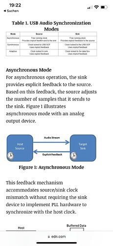

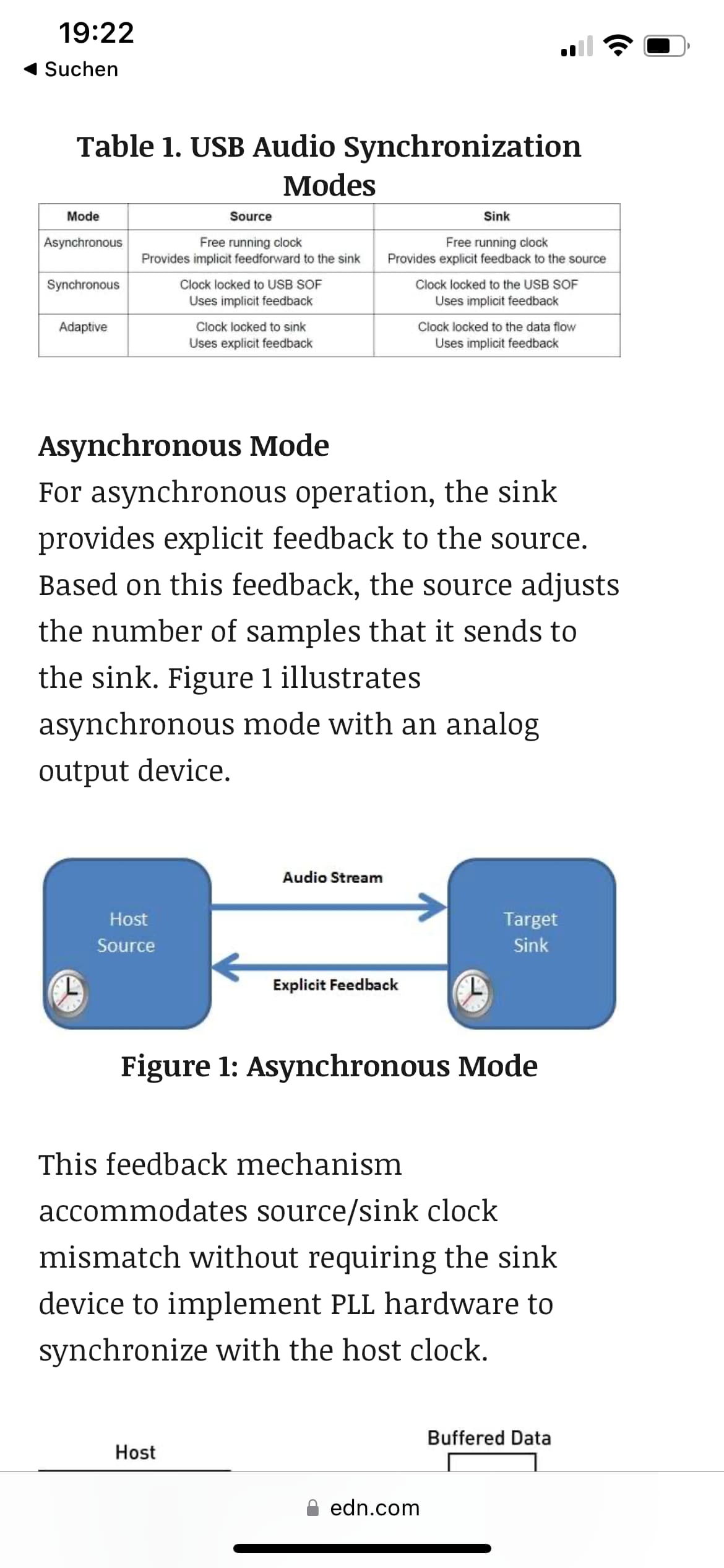

Some basics re USB audio may be helpful. The USB audio protocol takes care of problems that some hardware manufacturers claim to solve by fancy high end appliances. It’s hog wash.
https://www.edn.com/usb-audio-simplified/
Yes, USB gives the DAC full control over its only job: the D/A process. This McDonald’s-ization of USB (“if you haven’t heard anything else etc.”) is 100% unwarranted. It’s pure, unadulterated FUD. It’s a factory of phobias and mental allergies (“I refuse to use USB”). It promotes the narrative that when something becomes cheap, it’s automatically obsolete and mundane (“it wasn’t designed with whatever in mind”). Enough.

USB audio gets every time domain problem up to very D/A process out of the way. Pretty darn perfect data(!!) transportation. Done.
