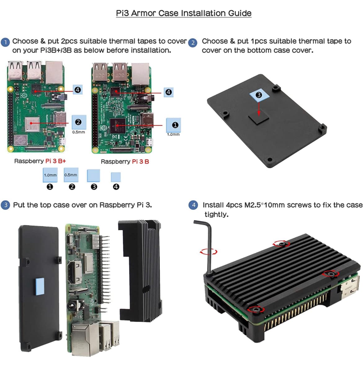

A Pi4 with RoPieee would do you fine if you can find one. It will require assembly but its like putting a kids toy together. Click parts in place, load RoPieee on the card, plug in cables, and away you go. For single order, take out of box, make work I like something like this CanaKit Raspberry Pi 4 Starter MAX Kit - Aluminum (Pearl White)

Well, yes, but the kit is ridiculously easy to put together in about five steps. Really. No tools required. I was a little apprehensive the first time, but you just click the board (which is pre-assembled) into the case, apply the heat sinks (they’re adhesive) to the chips, and plug it in. Then you flash RoPieee to one of those memory cards like cameras used to use, and plug that in. Bingo!

An RPi4 running RoPieee is hardly a DIY project. It’s about 10 minutes of downloading a file, burning it onto an SD card, sticking the card in the RPi4, and inserting 4 screws to install the RPi4 in a Flirc case. When I say 10 minutes, I mean the entire process.
