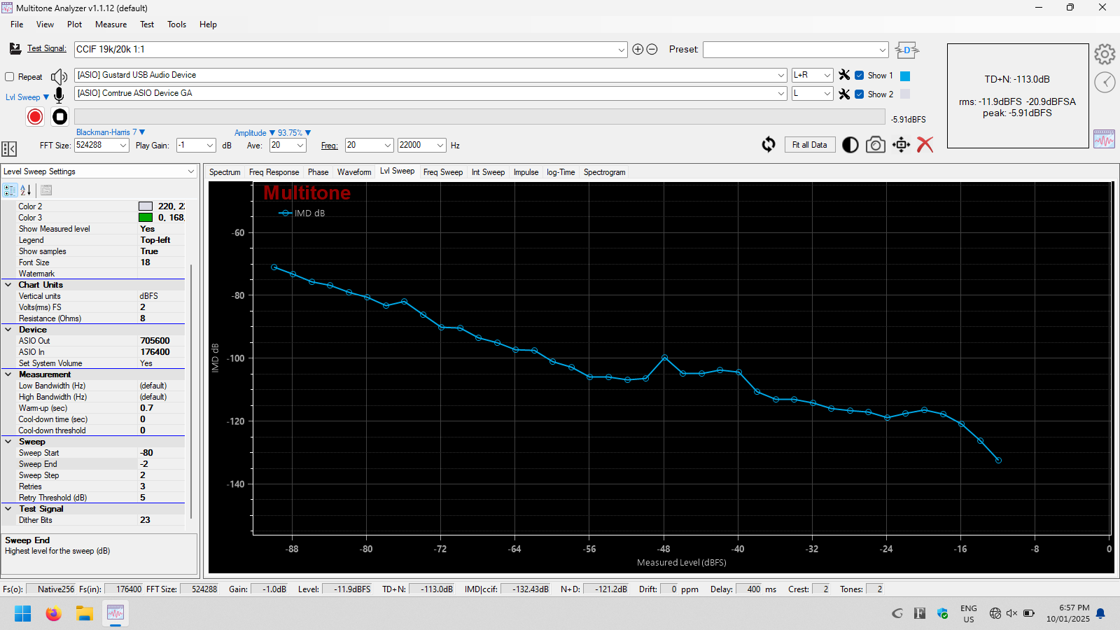

Cyan2 actually has a high IMD hump with CCIF vs level measurement. AH90 is one of the best I measured. My ADC (Cosmos) has its own IMD hump but Cyan2 boost the level of the hump around 30dB higher.

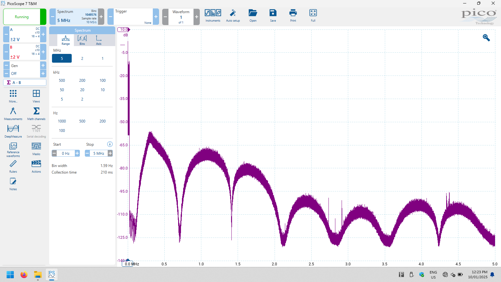

1kHz wideband shows DSD noise hump level more accurately than Pico:

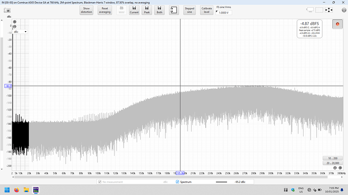

The classic Jussi wider band sweep - clearly not as clean as Cyan2 and ADI-2 (AKM):

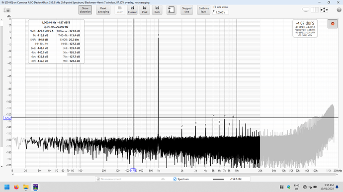

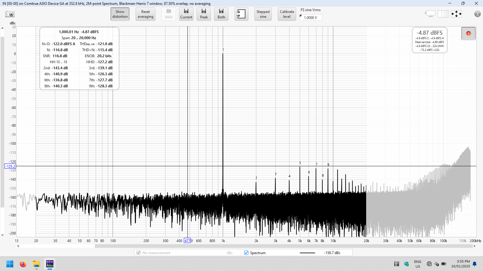

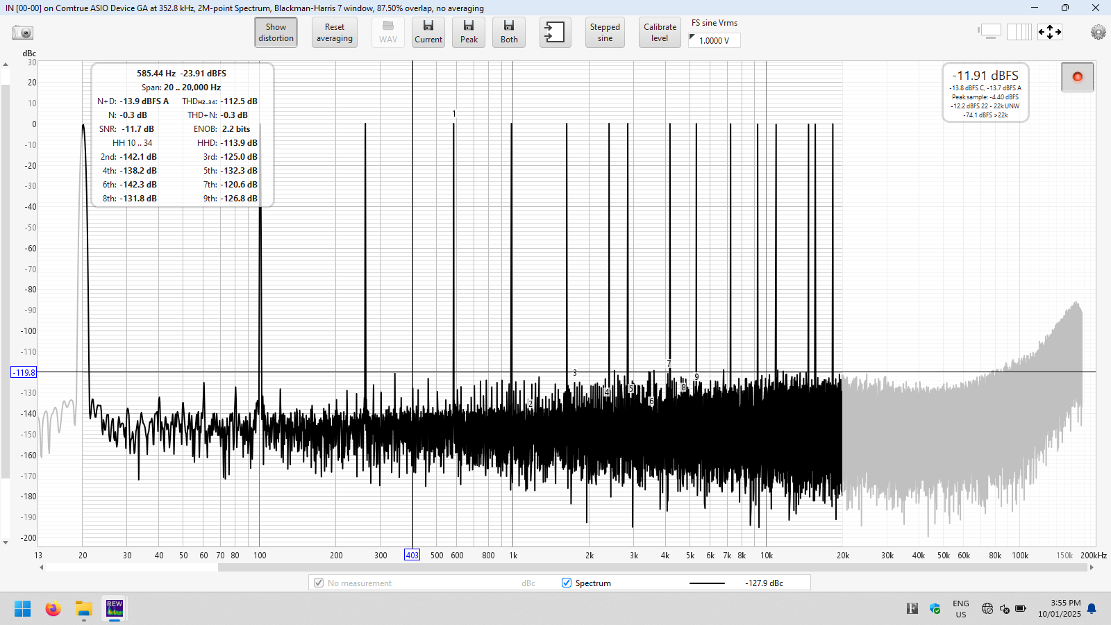

115dB SINAD (probably better in reality since this is my ADC limit I think):

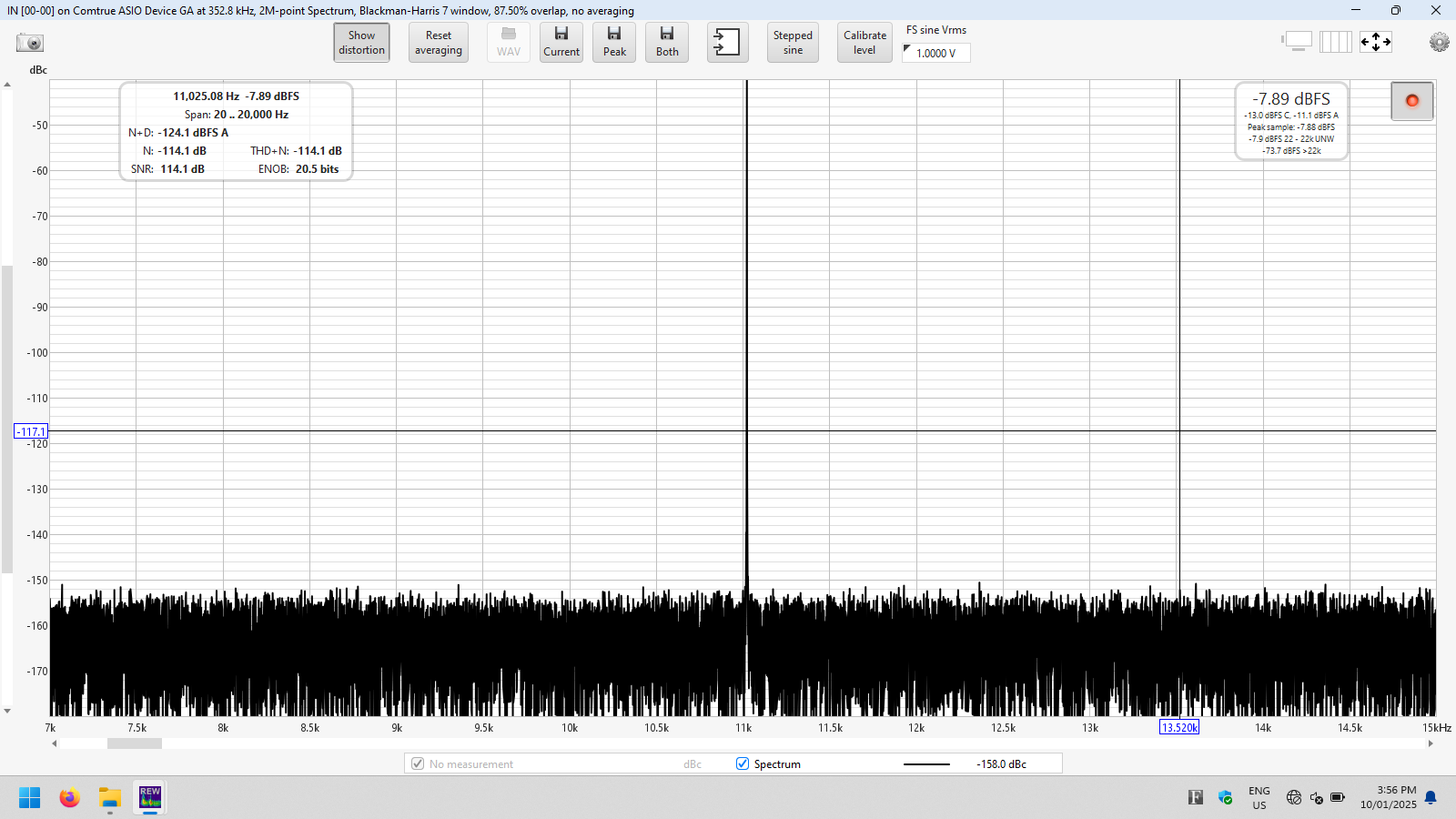

NID multitone is great:

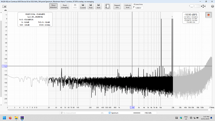

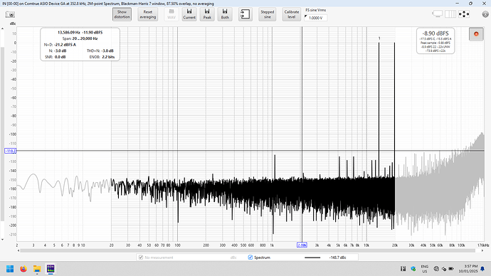

Dual TDFD tones (NID) is great:
Triple tones (NID) great:

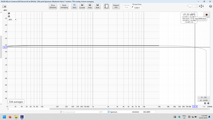

Frequency response with sinc-S filter very extended compared with Cyan2:
CCIF vs level: Small IMD hump but that is from my Cosmos ADC (ESS ADC) - most importantly hump is 30dB lower in level than Cyan2:
