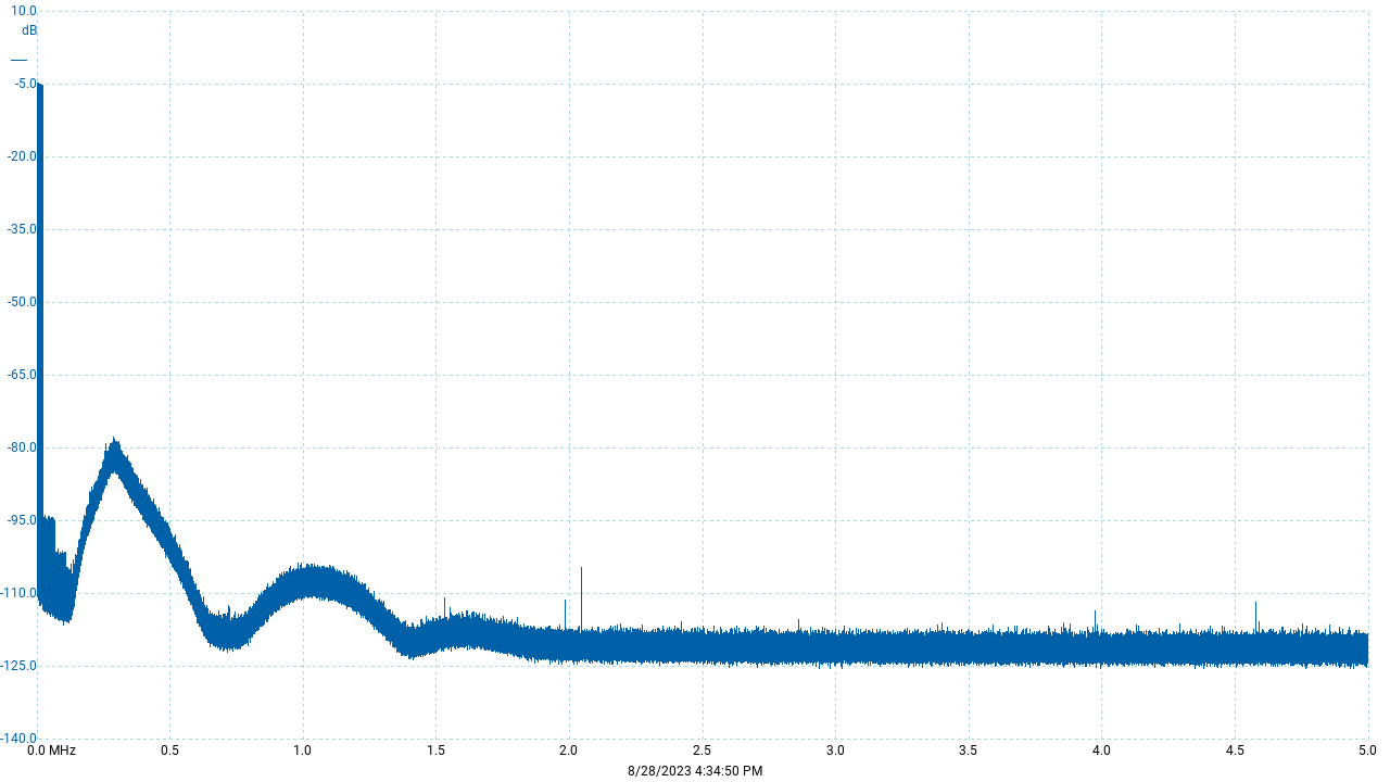

For the DSD noise hump, as Jussi has said for over a decade, this is non-music/non-signal correlated noise. So you need to listen to decide.

The classic Jussi wider band sweep - clearly not as clean as Cyan2 and ADI-2 (AKM):

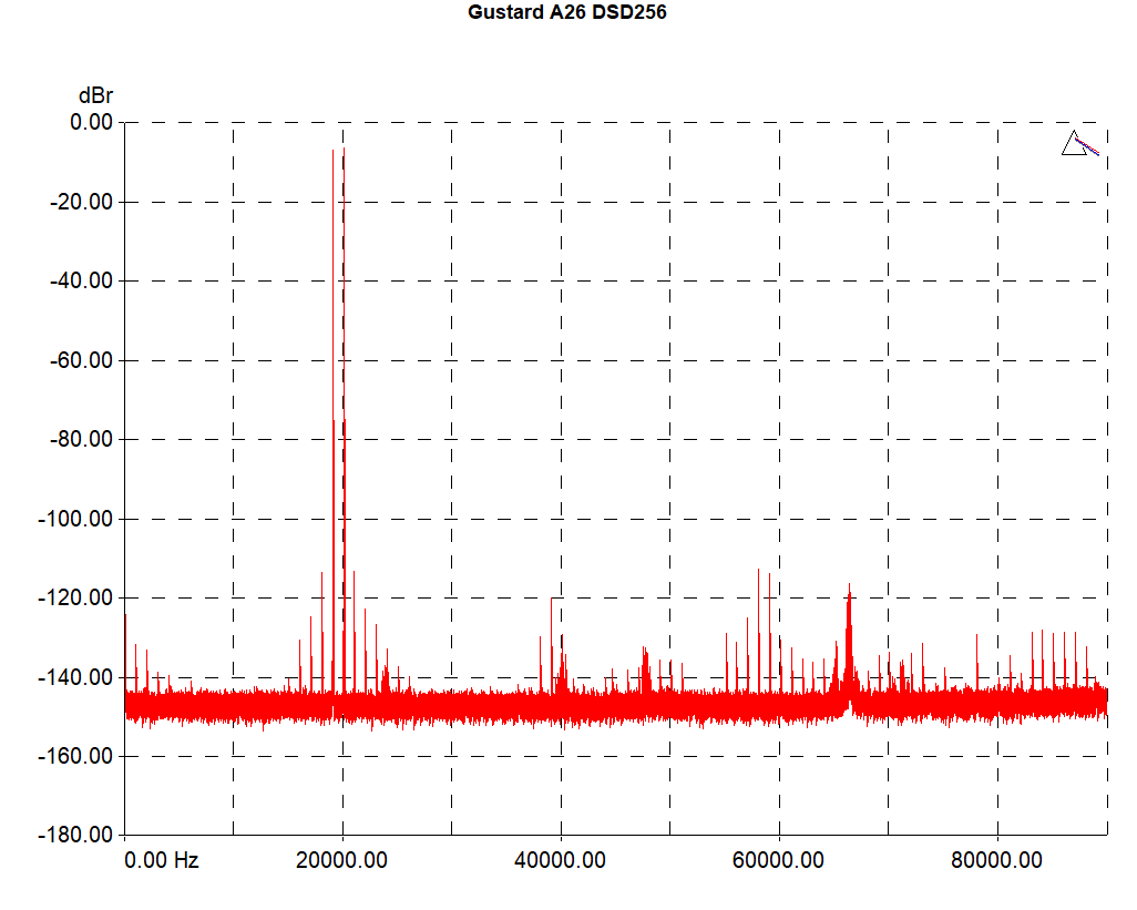

@jussi_laako will the A26 dac correction work on this?
I was the first to post back in Oct 2023 :smile: - but I didn’t want to risk it that early and be disappointed with DSD Direct, like with SMSLs and Toppings:
But you were the one that got them to update the firmware, so we thank you !
Just now I had an opportunity to loan one - I will definitely be keeping it (buying it).
@Thomas_Rector - I’m curious what Gustard engineers can do if the spend more time and effort on improving the analogue stage
I haven’t seen many A26 measurements posted, I wonder if there’s much difference or small
I’m just happy they did the dsd right on the akm chips lol.
Maybe the only ones, with 4499EX chip ?
True
We still need to confirm the A26 right? But it looks like Gustard know what they are doing.
Yeh would be nice to compare my same measurements above with A26.
I don’t know anyone that can let me borrow to measure though
