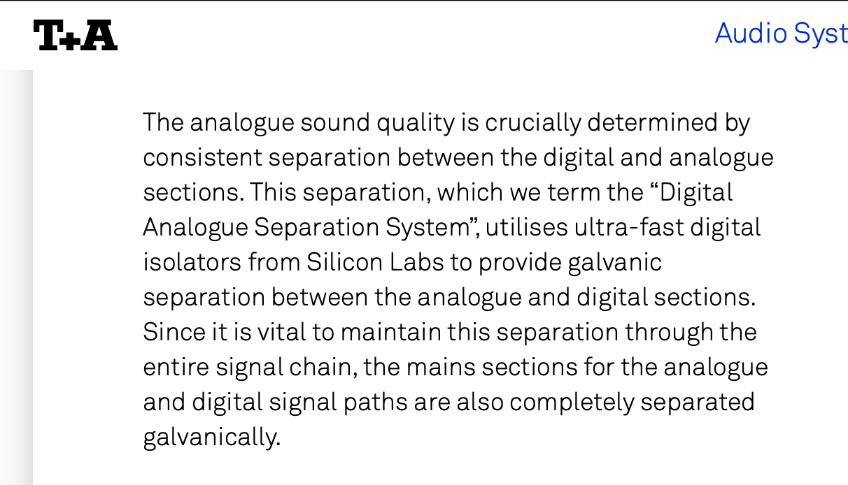

DAC200ās entire digital board is galvanically isolated from the analogue board
So that means all digital inputs , not just USB.
I canāt imagine what adding an Intona would do, electrically
Jussi had actually done measurements on the dac200 with and without the intona and confirmed improvements can be found with an intona.
I wonder if @Larry_HV can explain how this is possible with the DASS design?

If I understood correctly, DAC200 USB input is not galvanically isolated. So even though the digital side is isolated from the analog side, noise can travel through the USB input to the digital side. Maybe this has an impact to the DAC performance as a whole.
Yes noise can travel into the digital board but being a DAC, after the digital section comes the analogue section - and DASS is supposed to isolate the 2.
The only thing I can think of is both sides share one common power supply? Ground currents are finding a path to analogue section through there ?
I donāt know - and thatās why I asked @Larry_HV if he can help
