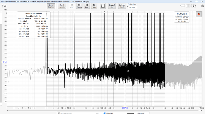

Cyan 2 is indeed the classic we were hoping for. My measurements below.

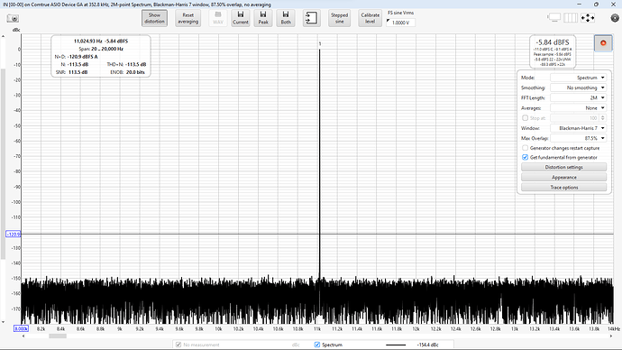

All measurements below using 44.1kHz test signals → DSD256 + poly-sinc-gauss-xla + 5EC-light
120dB RMS ‘range’ (nice):
Higher level dual tones create HF distortion but low enough in level:
Pretty much like the spec:
IMD vs level. Ignore the small ups and downs. ‘Line of best fit’ is good enough:
TDFD dual tone brings out more HF distortion but still low enough:
