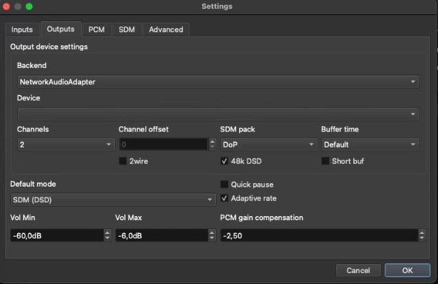

On Advanced -tab.
At least it is something I have tested and know how it works…
Not a real classe D : Benchmark + A26.
Actually : DSD256 classic poly-sinc-gauss duo + ASDM7EC light 512+fs

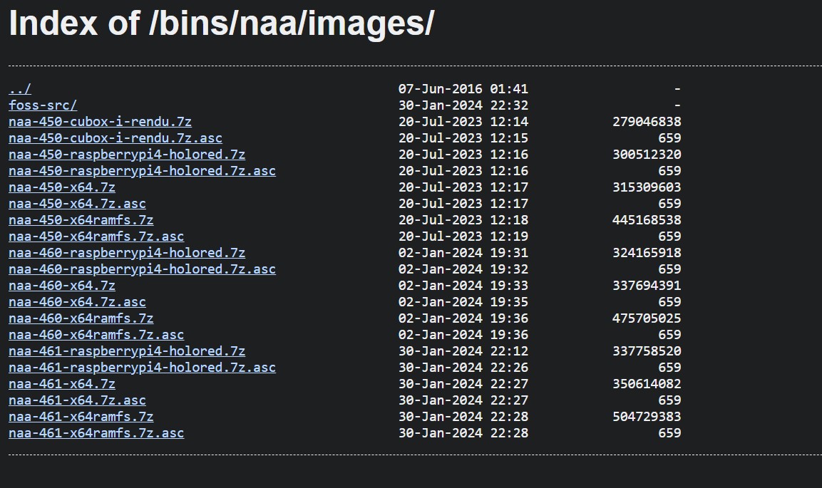

For NAA Os, it’s here?
Choose naa-461-X64.7z or naa-461-X64ramfs.7z
For installation on an Intel NUC without any OS, how do you install it?
Take this one…
Extract the .img file from the 7-Zip archive and write it on a USB memory stick on microSD card using disk image writing utility. Then just boot up from it. No installation necessary. When it ends up in login prompt, it is ready for use.

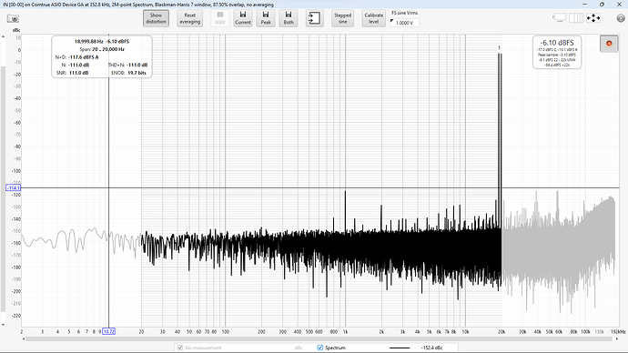

Cyan 2 is indeed the classic we were hoping for. My measurements below.
And yes I am finally listening to it after measuring - beautiful.
Under 100kHz DSD256 beats DSD512 in all measurements. I won’t show DSD512 here, no point.

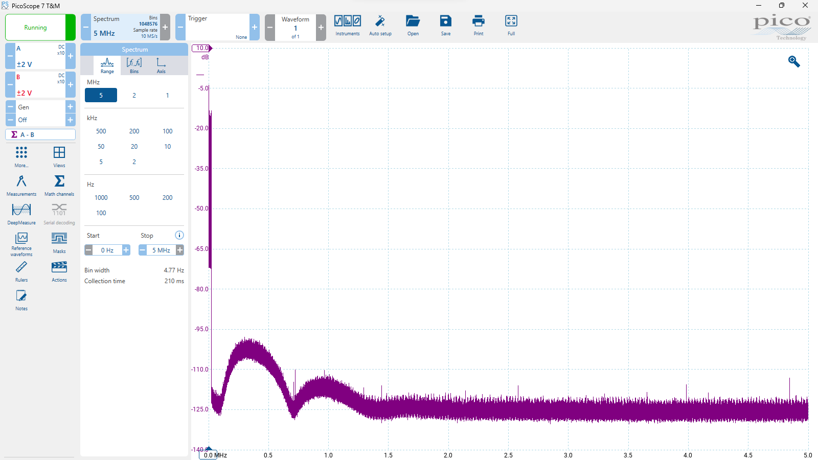

With Jussi’s classic 5MHz wideband Picoscope, DSD512 is nice but for my headphones listening I would choose DSD256.

All measurements below using 44.1kHz test signals → DSD256 + poly-sinc-gauss-xla + 5EC-light

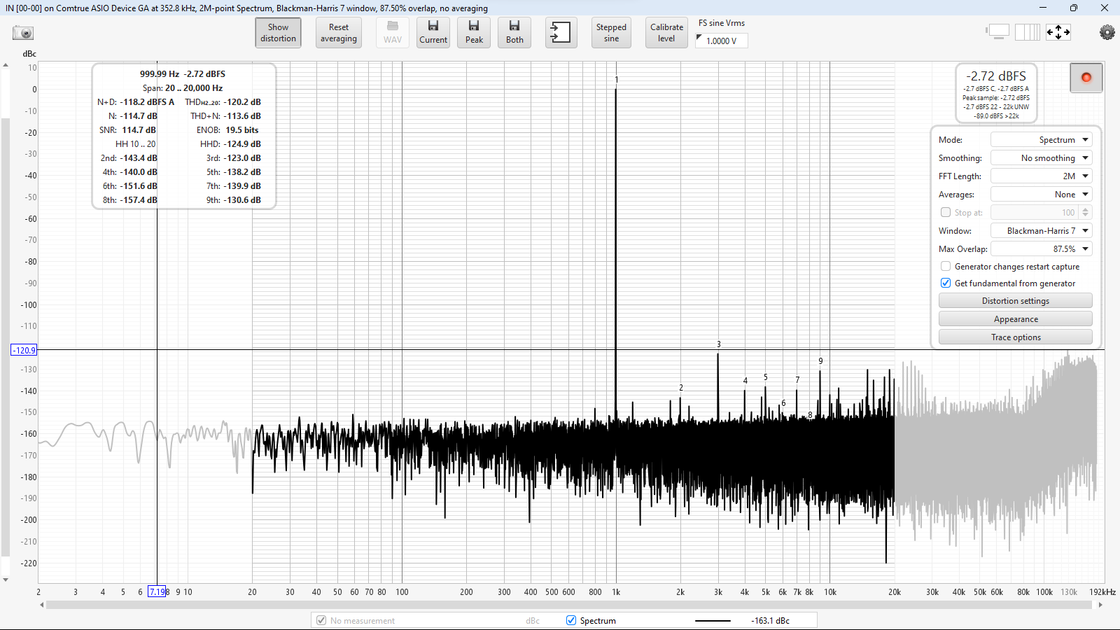

120dB RMS ‘range’ (nice):

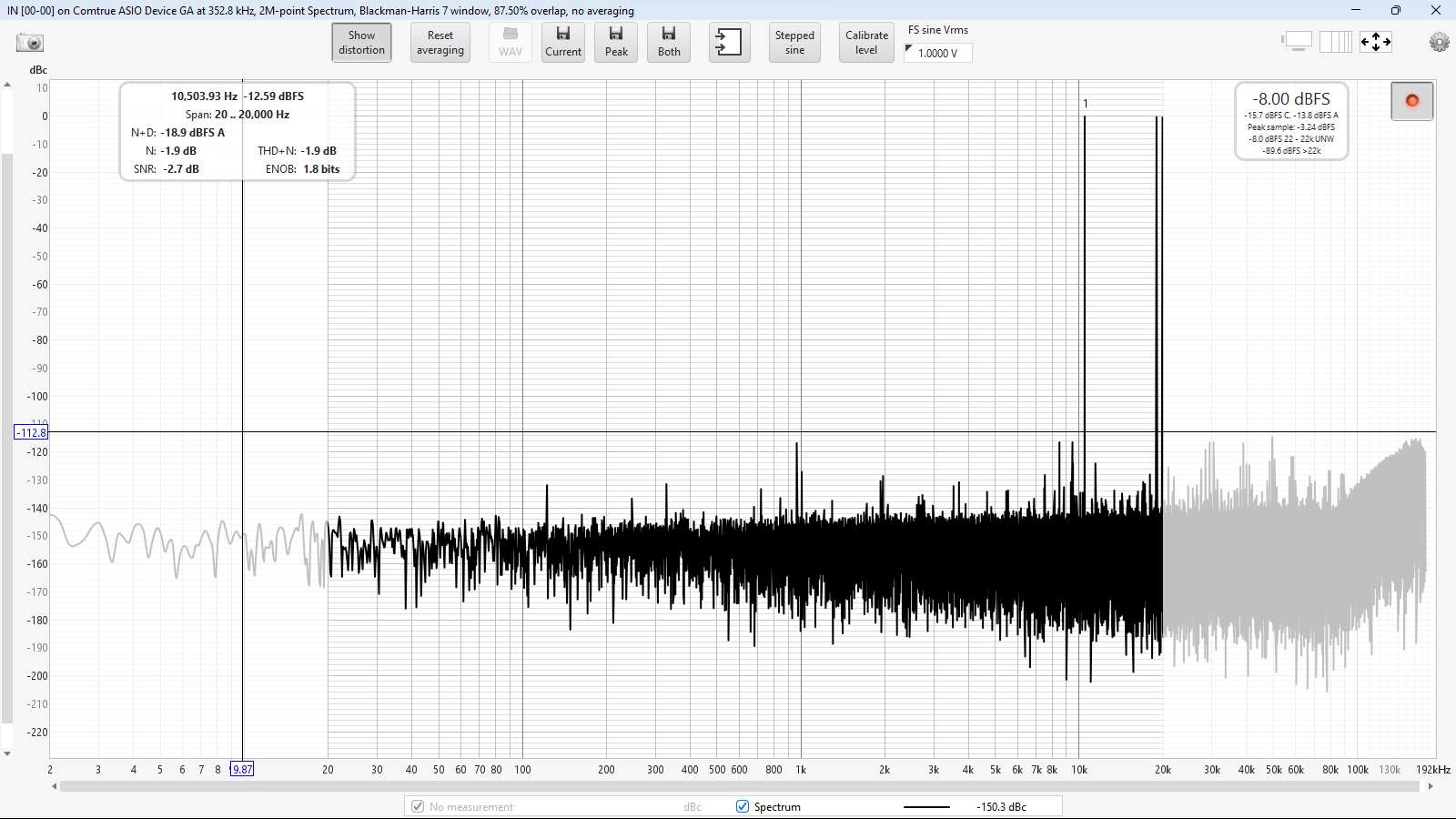

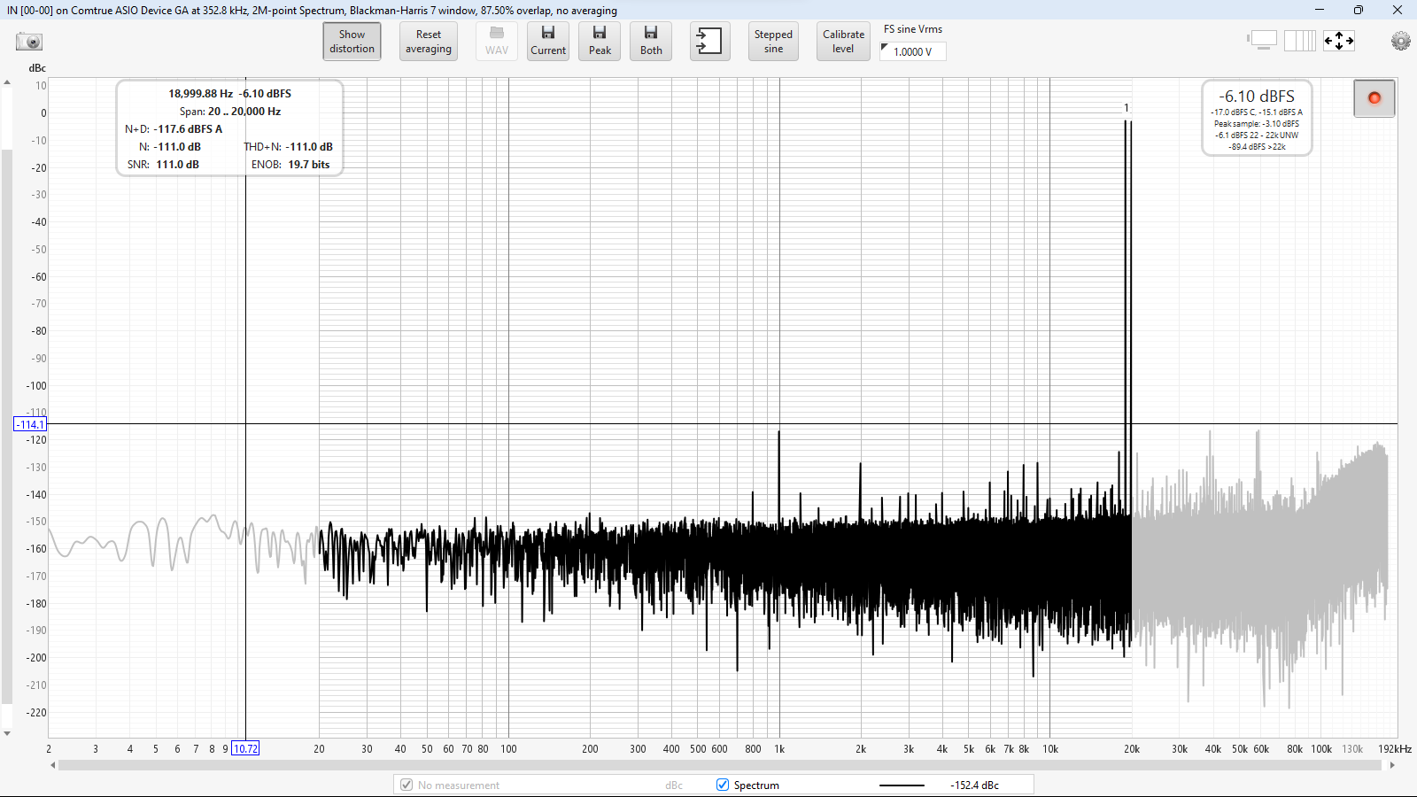

Higher level dual tones create HF distortion but low enough in level:
Pretty much like the spec:

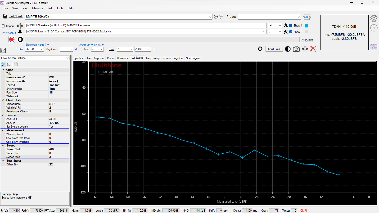

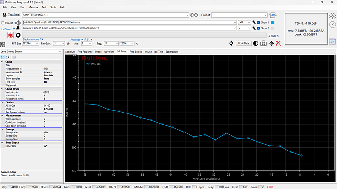

IMD vs level. Ignore the small ups and downs. ‘Line of best fit’ is good enough:

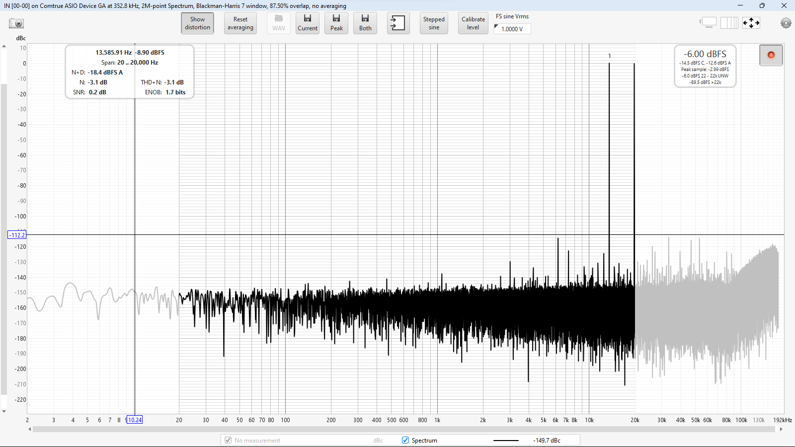

TDFD dual tone brings out more HF distortion but still low enough:
Triple tone:

Jussi classic Pico :smiley: - it is good enough
