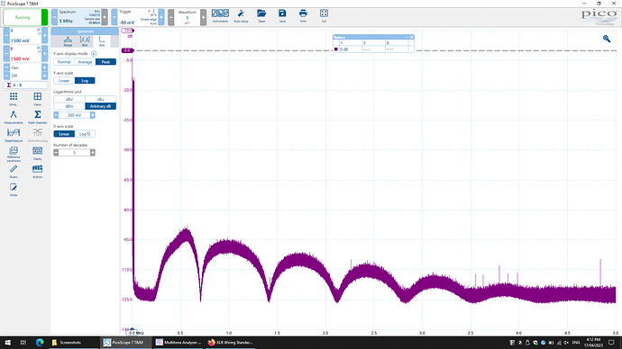

This is my D-6 with DSD512. I only get the uncorrelated DSD noise ?

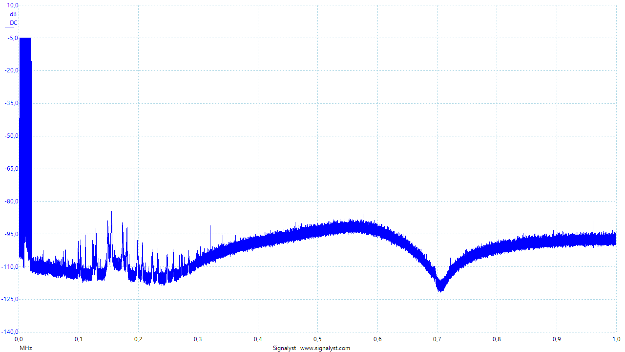

Not in mine, see for example this 44.1k PCM input case, around 100 kHz:
But could be similar to Topping, that it is more or less random how good unit you happen to get. Like my two Topping E30’s, with SNR difference of about 60 dB.

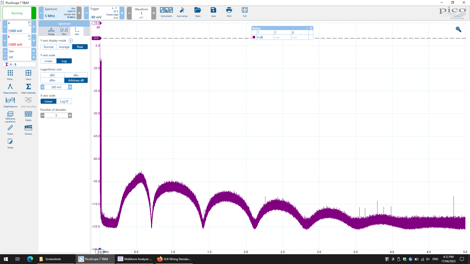

Yes but I wrote with DSD512 input
Need to compare Apples with Apples
Can’t compare Cyan2 DSD256 with D-6 PCM44.1k
That is clearly interference from the built-in SMPS.
I had ugly wideband with D-6 at first
And then I played with grounding to the Pico and it cleaned right up
All that crap vanished
So what goes into your amplifier will depend on overall system grounding but that’s the same with any DAC
If I played with my laptop and Pico grounding during Cyan2 measurement I’m sure I can introduce something funky to show

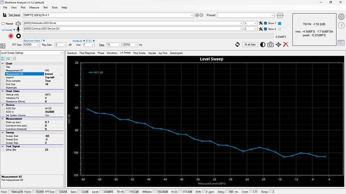

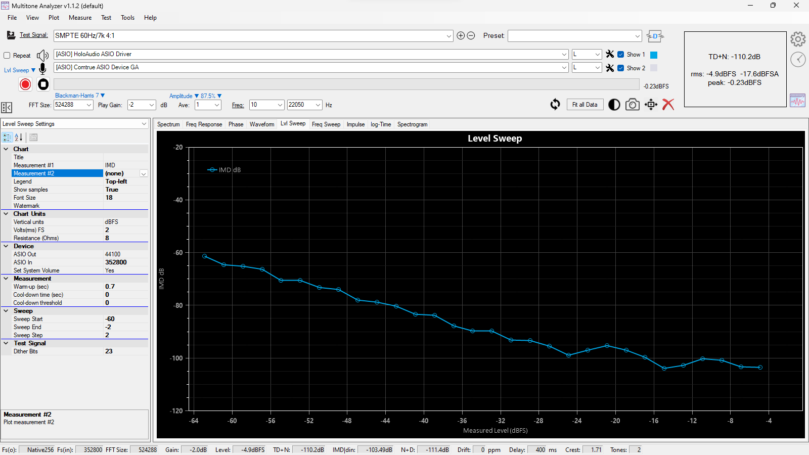

Late last night I wasn’t happy with my IMD vs level plot.
From Multitone Analyzer on the laptop I was outputting to RPi4 NAA input and then it back from HQPlayer into my NAA and into my ADC, also connected to laptop.
Something in this loop was causing a blip in the IMD vs level plotting, getting results was really inconsistent.
So very late last night , I used Multitone’s Analyzer’s built in DSD upsampling to DSD256, bypassing all network (just for IMD vs level plot). Just straight out to the DAC and straight into the ADC. ASIO in and out.
I got the same result each time, so this result is reproducible.
Nothing weird about this result. Small turns up and down are minor. Mainly looking for a big rise up in IMD and we don’t get that. Nice.

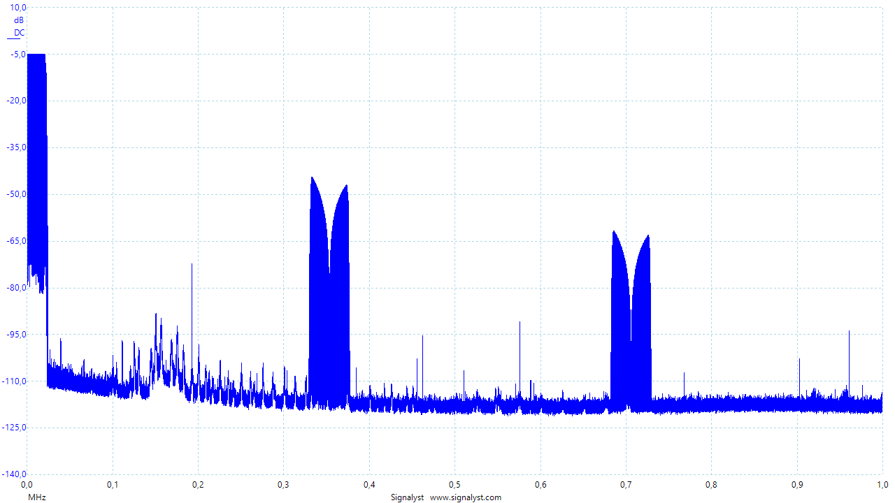

Part of the reason is varying relatively large delay on that path. Input side clock is only virtual. (which is not actually used to clock anything)
Ah i see. Actually all the REW measurements above (exception is the level sweep) are:
iPad (Onkyo HF 24bit / 44.1kHz test files created in REW) → RPi4 NAA input → HQPlayer DSD256 output → UpBoardGateway NAA → Cyan 2 → ADC → REW RTA on laptop

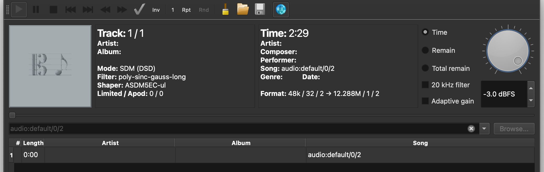

Cyan 2 direct USB connected to Mac Mini M1 with RPi4 NAA input (Apple Music Hires on iPad)
DoP 256 enabled. Auto family rate enabled to help lower CPU loading
And new 5EC-ul (Ultra Light) modulator also to help keep M1 CPU lower also.
