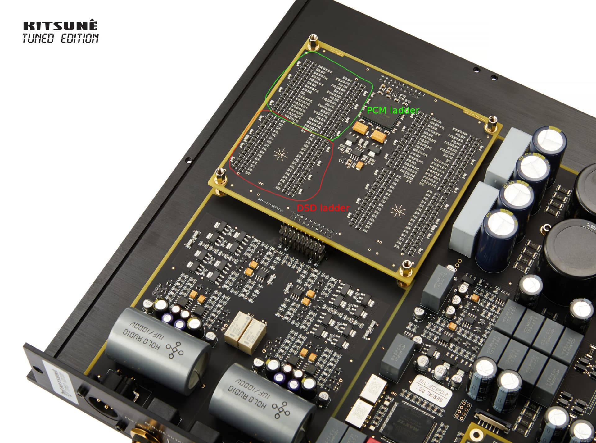

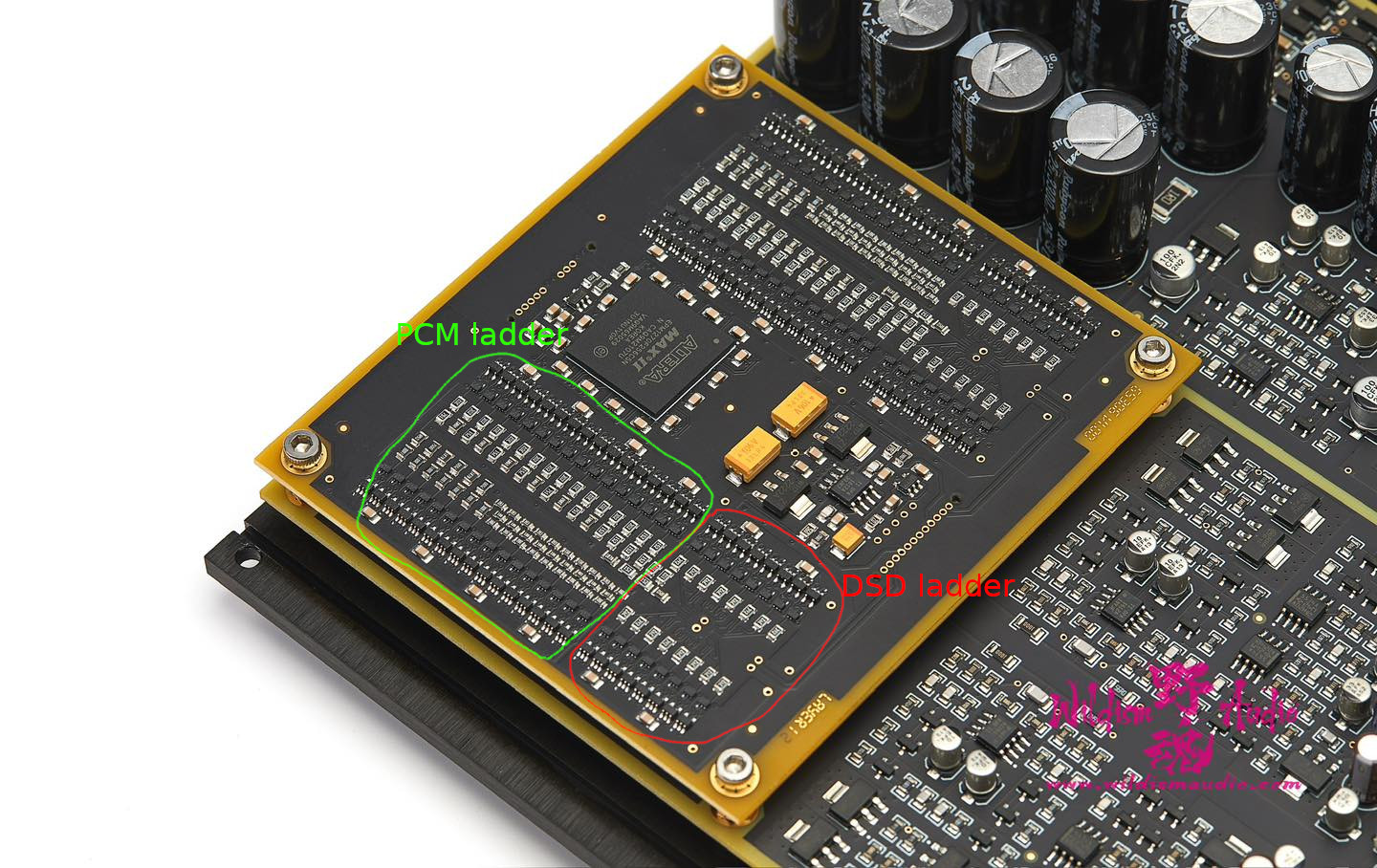

They describe it on the Kitsune website.
It is actually complicated but similar to Jussi’s open source design DSC1.
But it is a discrete design, not using an off-the-shelf D to A chip.

This post already in this thread might help (see photos)
So it looks like overall Jeff @ Holo did a good job filtering the higher ultrasonic noise, with half the number of elements Cyan 2 has ?

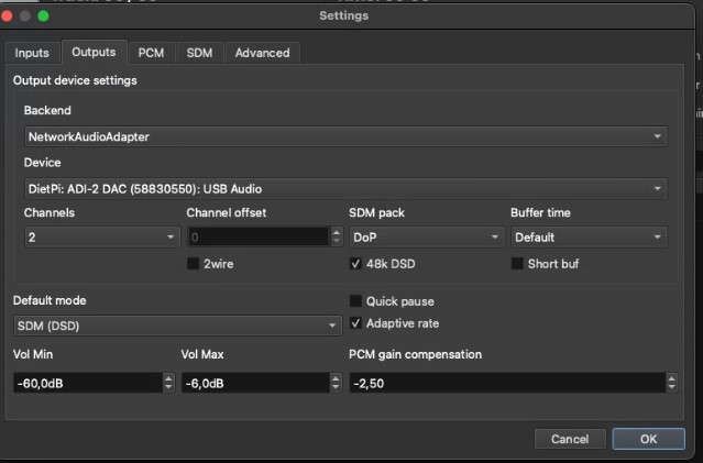

With RME ADI2 in direct DSD with NAA HQP, I regularly have clicks/plops when changing tracks or albums in manual, but this also happens in automatic playback.
I have a doubt about the settings I put in HQP Desktop (see screenshot)
Should “Adaptive Rate” be checked or grayed out?
Should “48 DSD” be checked?
“Short Buf” and “Quick pause”, is it worth using them or not?

From Roon? Try setting Idle time for example to 30 seconds or 60 seconds. So that you have enough time to change tracks/albums before it times out.

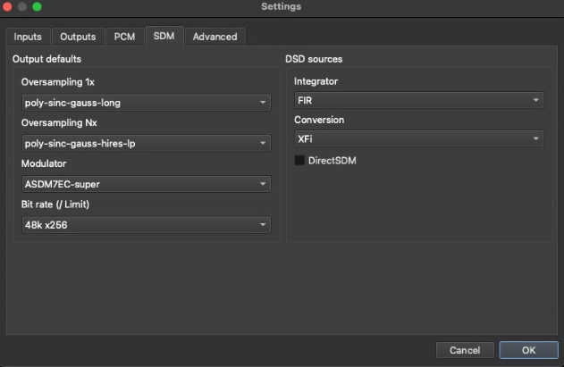

Looks good, but how are your SDM settings? Have you tried with NAA OS?
yes from Roon.
Where is Idle Time?
NAA is installed on NUC/Dietpi, would NAA OS be better?
