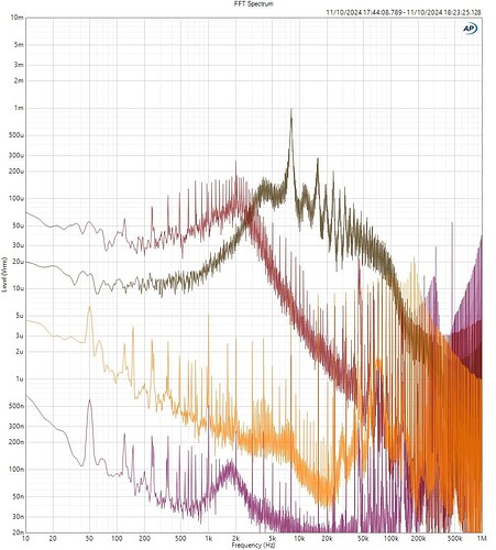

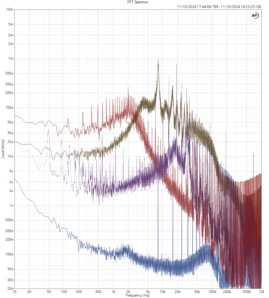

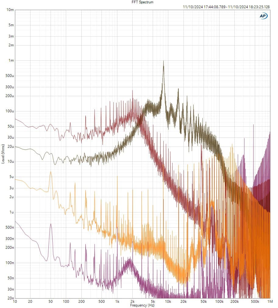

For context, thanks to some help from both my friend Pete at DoubleHelix Cables and Daniel at Intona I’ve been doing some measurements of the actual noise at the output of several USB sources whilst they are in use/playing to a DAC.
This shows just how much cleaner even quite an affordable isolator is than a PC, phone, or many streamers.
(NOTE: Ignore the levels of stuff up around 250khz-1Mhz for the most part, I need to do some further testing to see how the activity of the device and keeping cable twisting consistent etc affects this so these shouldn’t be considered indicative yet, but the overall level of everything else was very consistent)
Red: PC
Brown: Phone (Samsung Z-Fold 5)
Purple: Eversolo DMP-A6
Blue: JDS Synapse

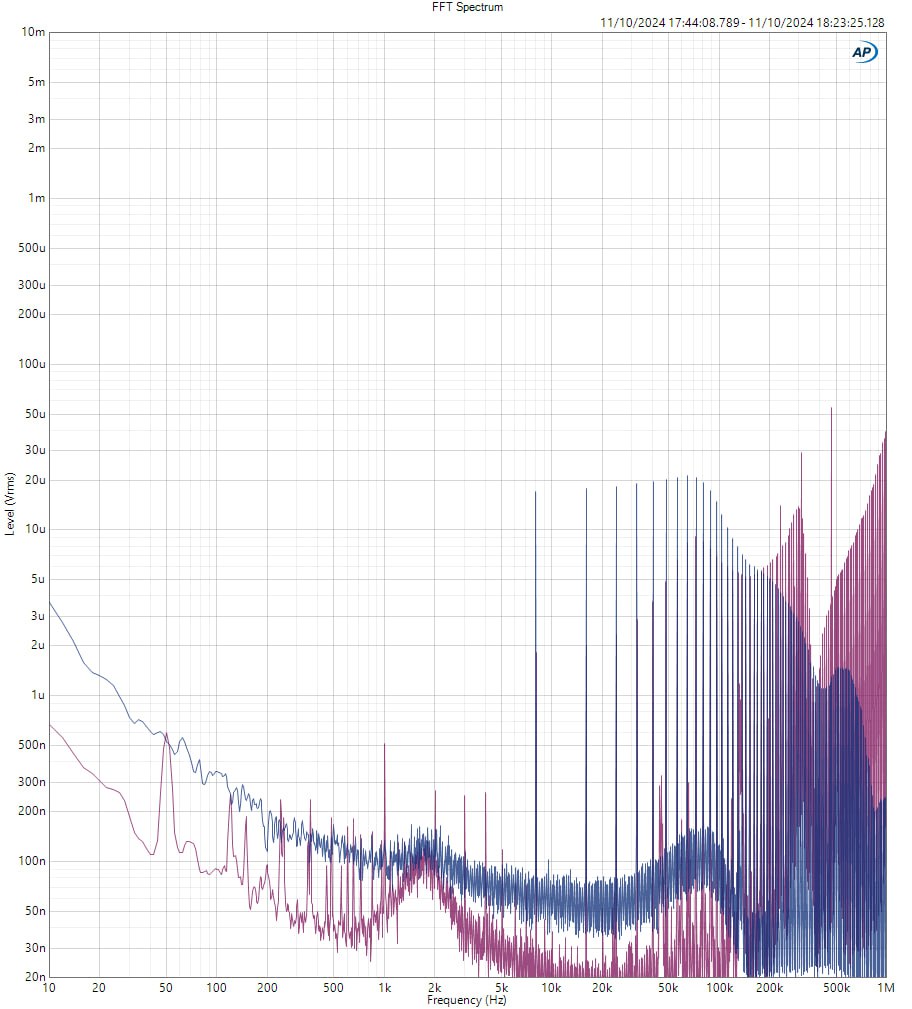

JDS synapse doesn’t get quite as quiet as the Intona 7055-C or 7055-D, but they’re pretty close, and both DRASTICALLY quieter than typical sources. Quite frankly if you’re wanting a guaranteed clean USB source, get one of these two devices and be done. (Unless your DAC already has galvanic isolation in which case leaving both ends of the connection ungrounded may not be ideal.)
Blue: JDS Synapse
Purple: Intona 7055-C
RED in comparison to some of the others:
Holo RED (Orange)
Phone (Brown)
PC Direct (Red)
Intona (Purple)
RED isn’t quite as quiet as the intona, but again drastically cleaner than a phone, PC, or the Eversolo DMP-A6. Plus then you do have the benefit of keeping your USB ground connected at the source if your DAC needs it.

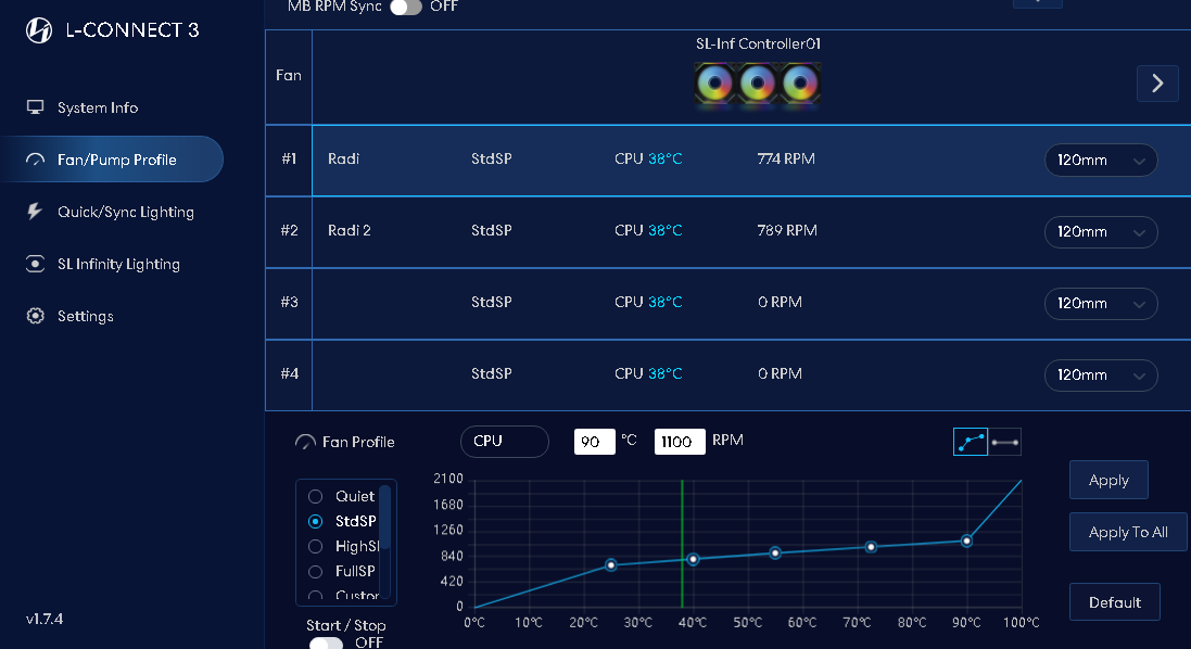

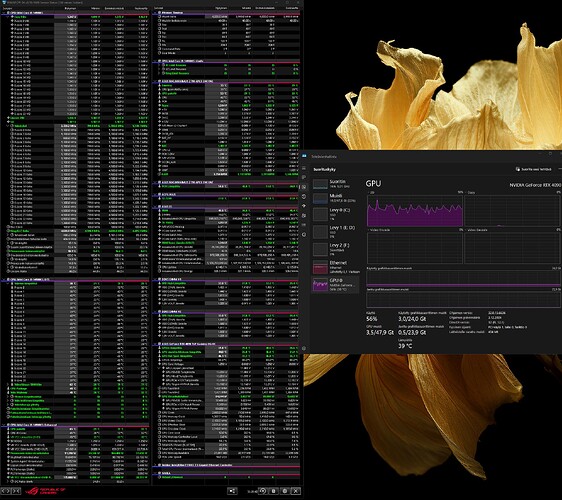

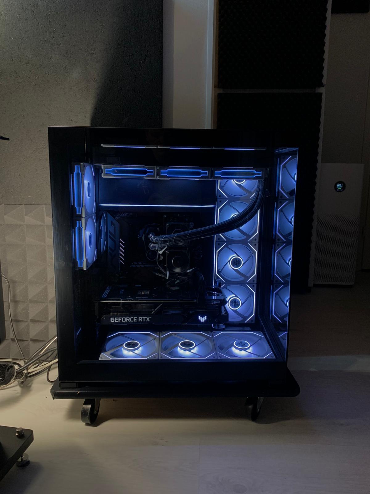

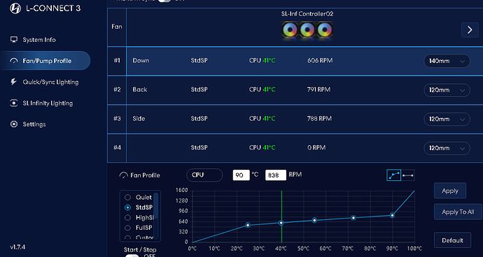

I can’t hear the sound of my computer even if I put my ear to it. And the Cyan 2 is directly connected to the computer and there is no difference even though at first there was a RED in between. i9-14900KS, Apex Encore, Seasonic Prime TX-1300, RTX4090 and 48gb 8000Mt/s.
I count 12 case fans + the ones on the Nvidia RTX. They must be something special if they’re inaudible.
My desktop gaming PC runs quite silent also but it’s definitely audible if it’s running stressed in the same room with my hifi.
Lian Li SL Infinity 9×120mm and 3×140m.
The 4090 does all the work and the fans stay at minimum speed. All other fans are around 700rpm and there is no noise.

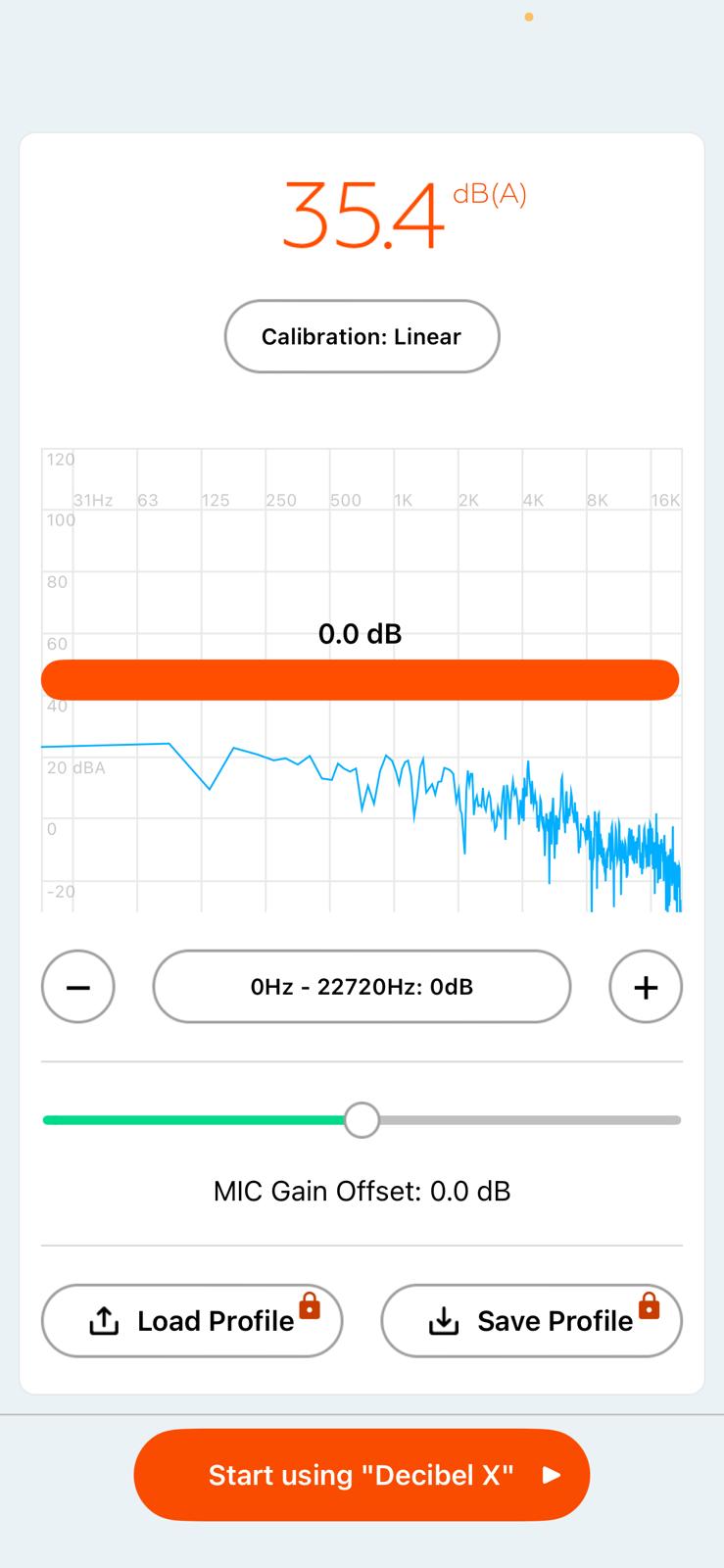

DSD512 super 512+ with DC
Measured from the top of the machine, the washing machine is on in the bathroom :sweat_smile:
