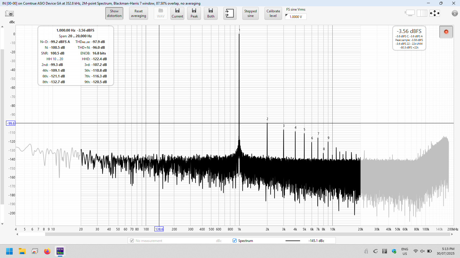

Managed to find my 4.4mm to XLR cable (from AliExpress for $30 :grin:).

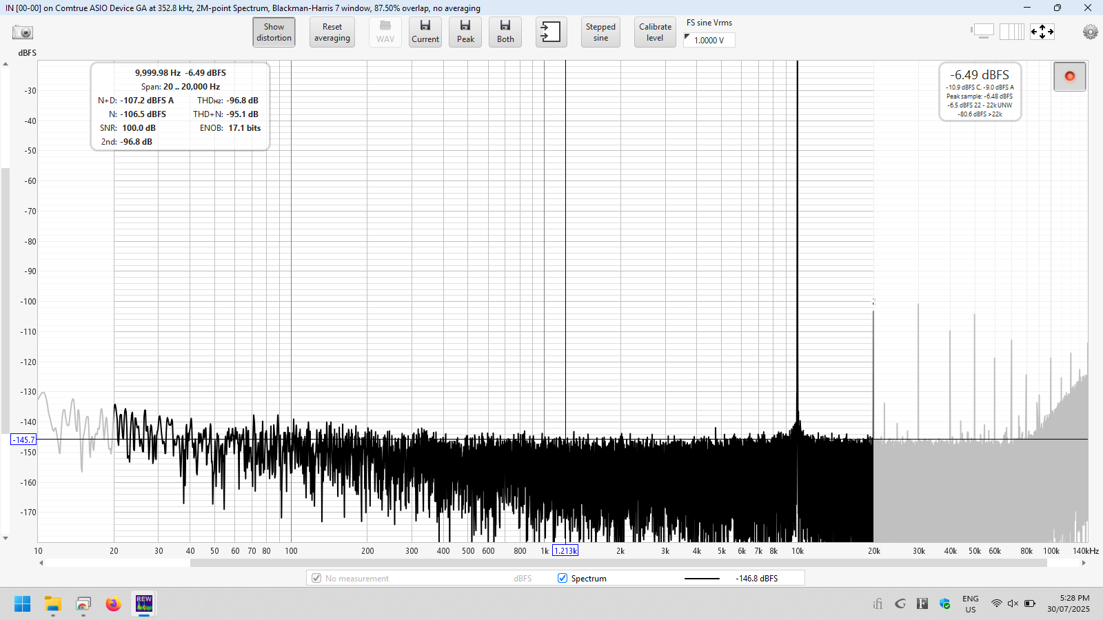

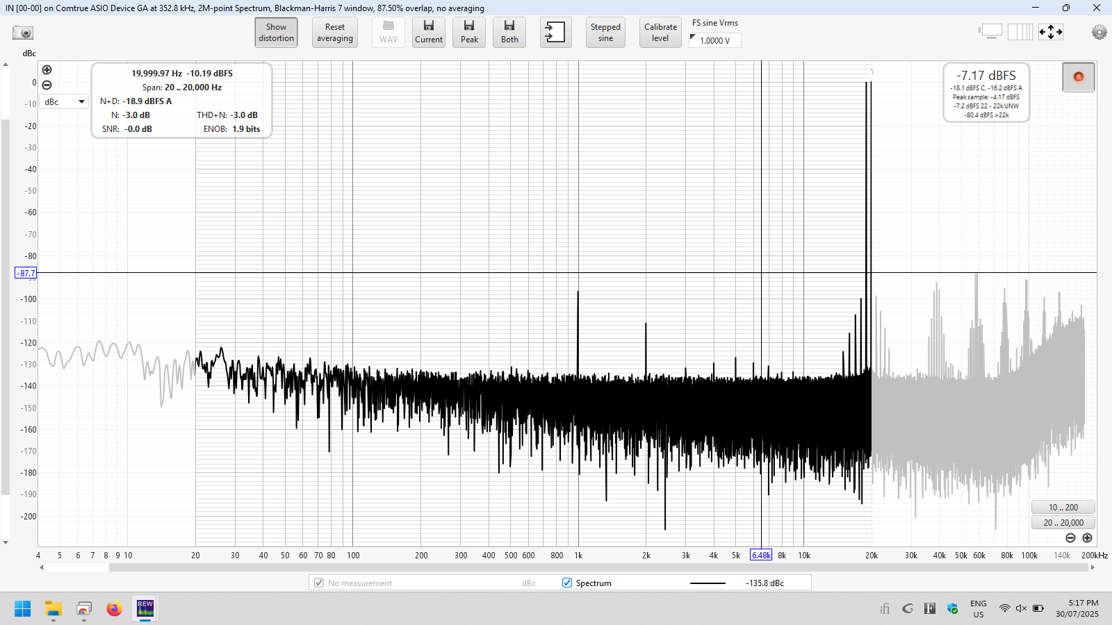

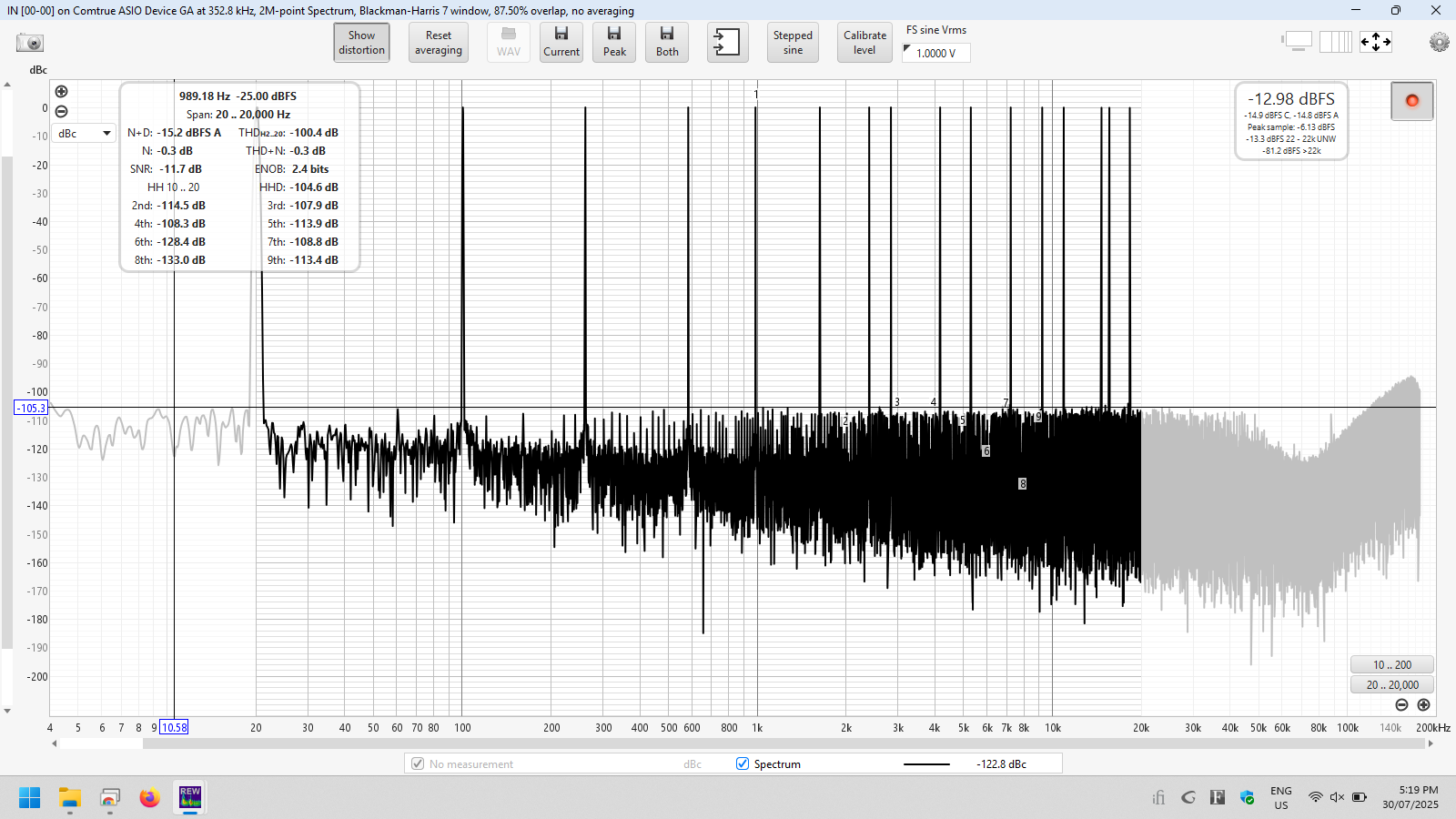

Most measurements are the same as my RCA (with super careful grounding…) except multitone which has around 105dB ‘range’ - nice improvement over RCA ! Surprised me

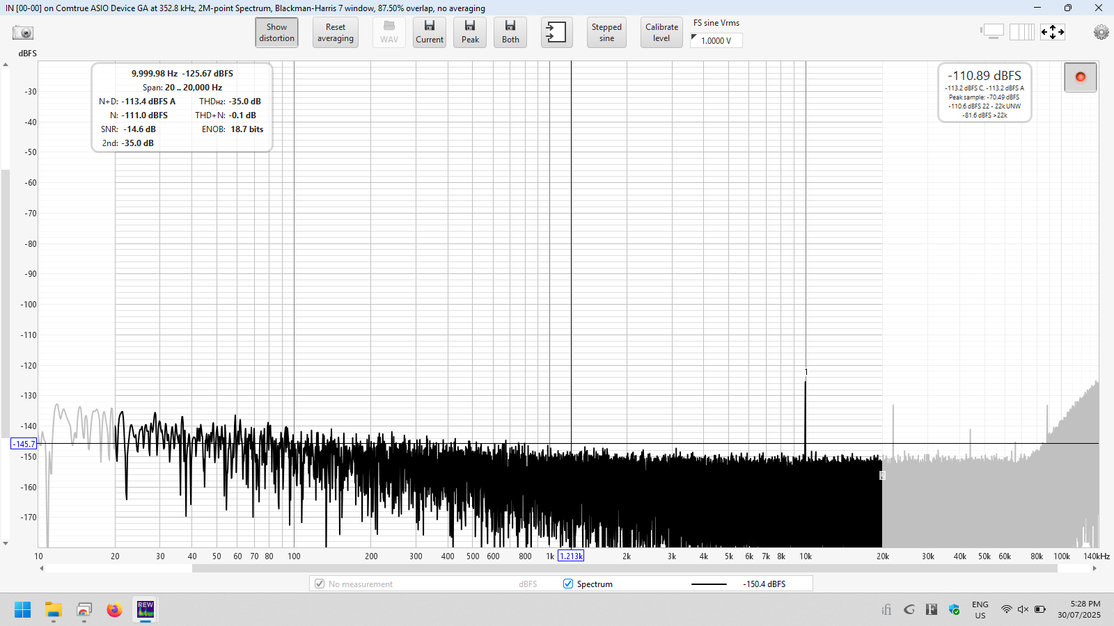

One thing I didn’t show with RCA since I wanted to wait for XLR measurements, was that there is a little bit of noise floor modulation. This is with DSD256 , gauss-xla, ASDM5 and ASDM7 both are the same in terms of noise floor modulation.
Here you can see 0dBFS signal vs -120dBFS
Its small but this is absent in the AH90 with built-in NAA input.
