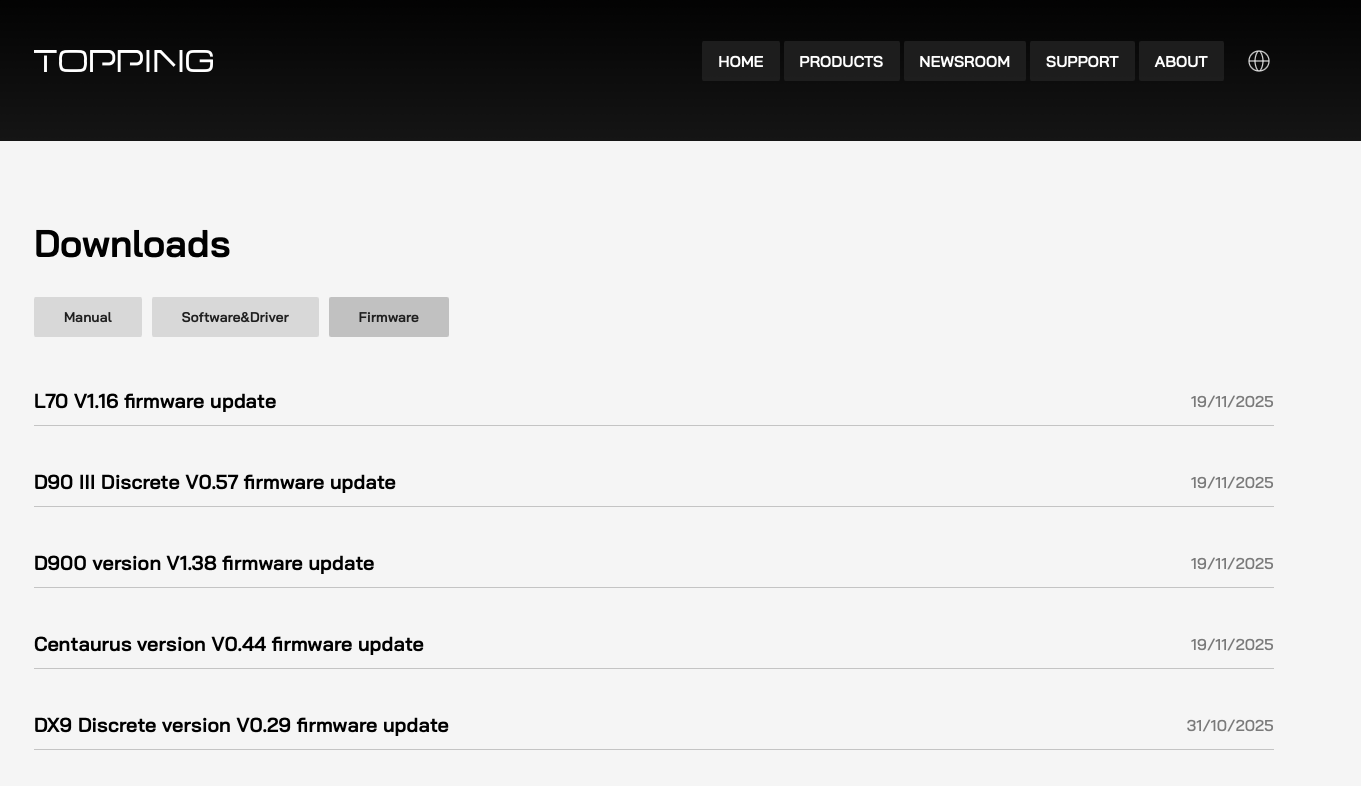

I got a loaner Topping D900 with latest firmware to test.

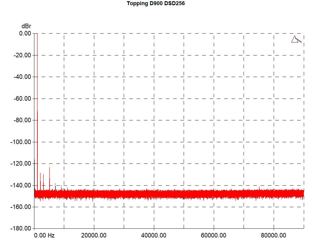

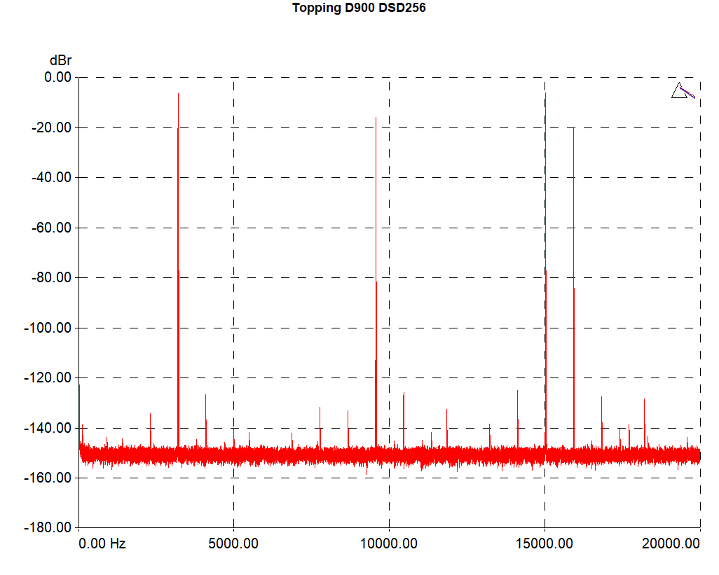

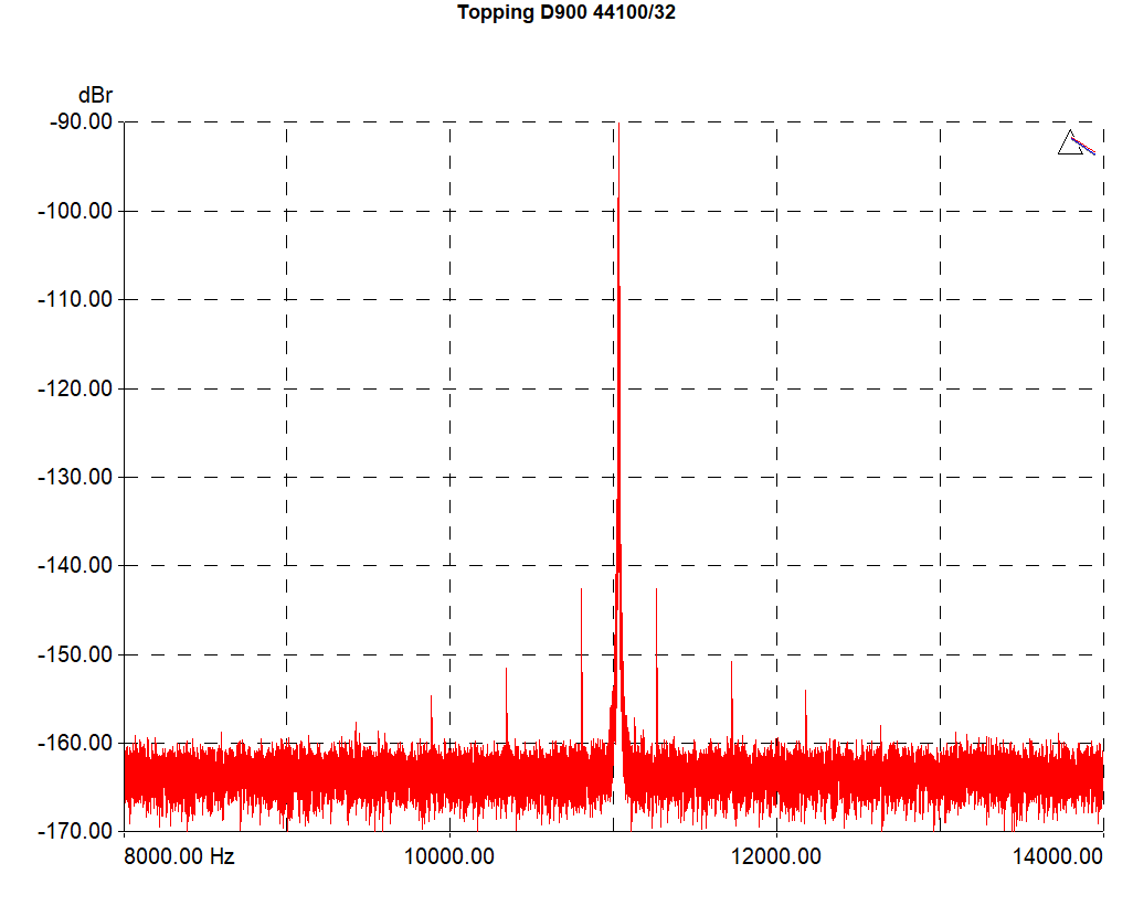

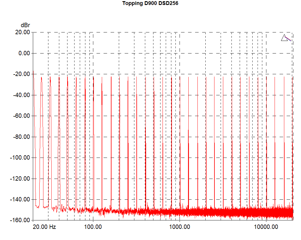

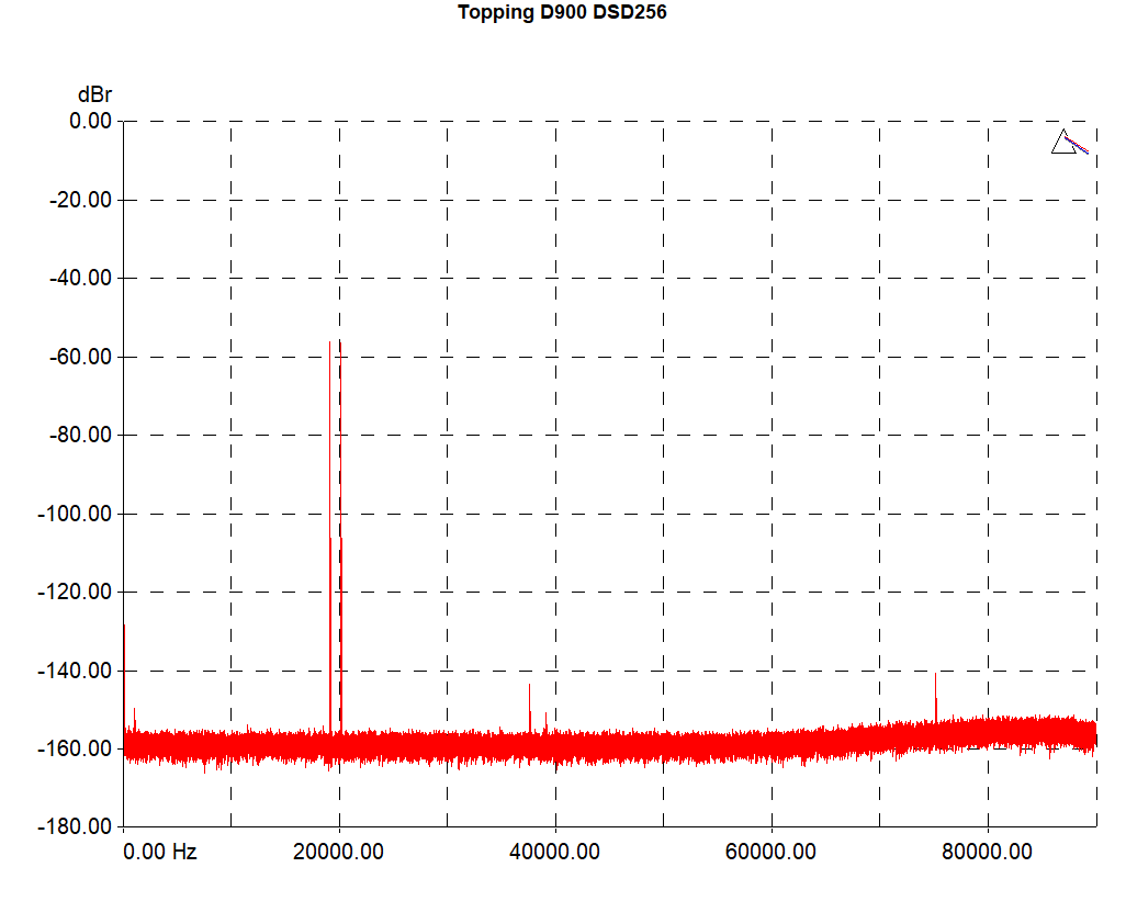

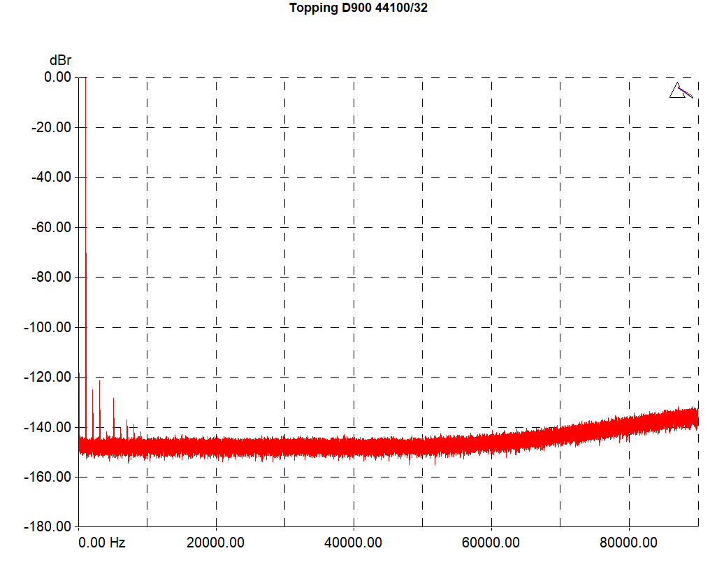

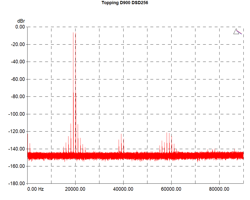

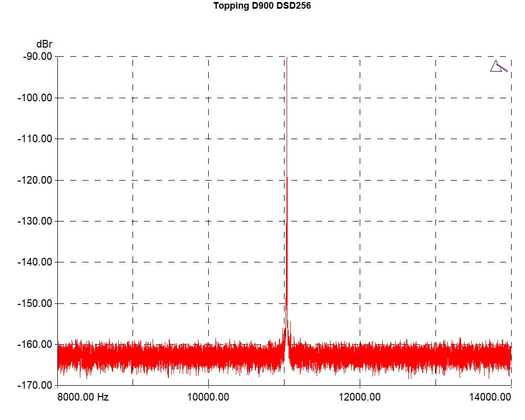

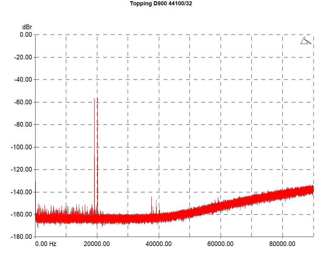

DAC is measured with DSD bypass line out mode. PCM input vs DSD256 input from HQPlayer using ASDM7EC-fast modulator.
1 kHz THD test tone:

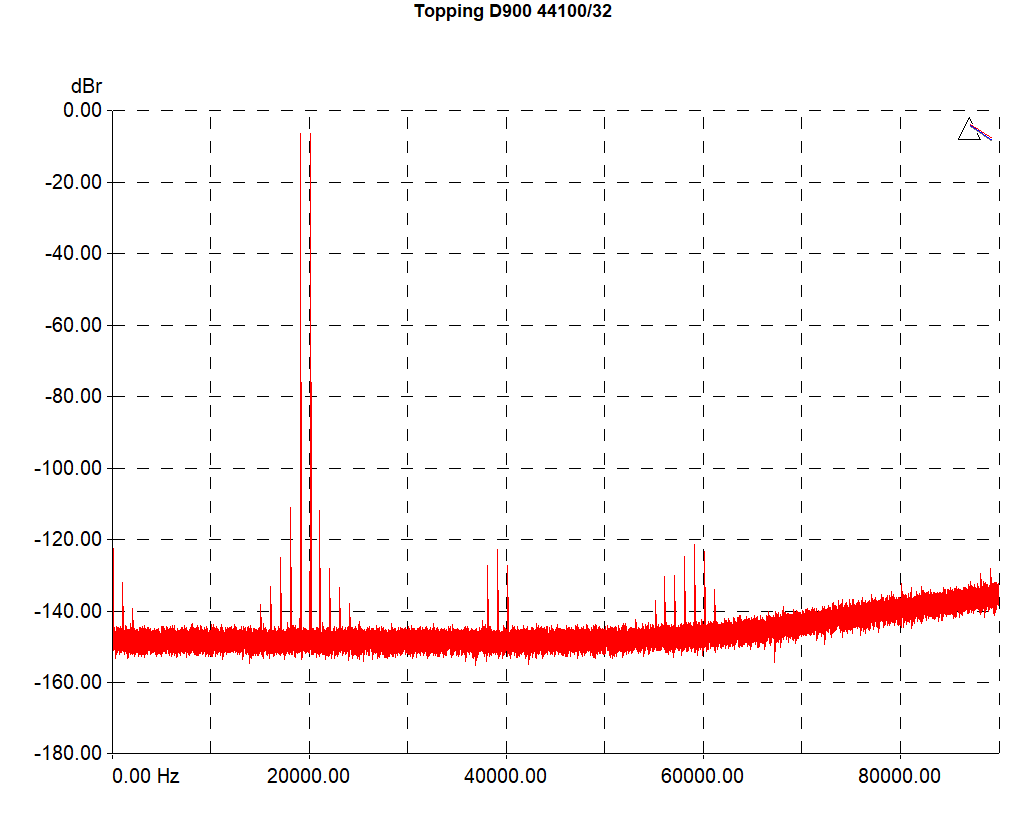

IMD:

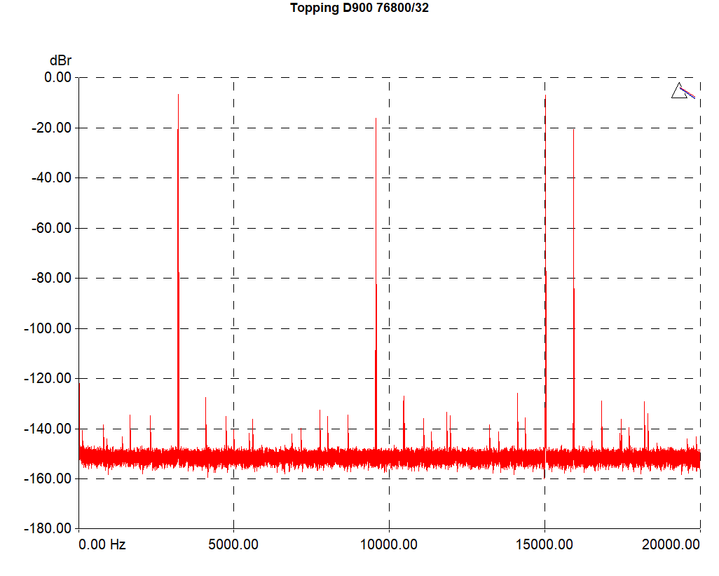

Jtest:

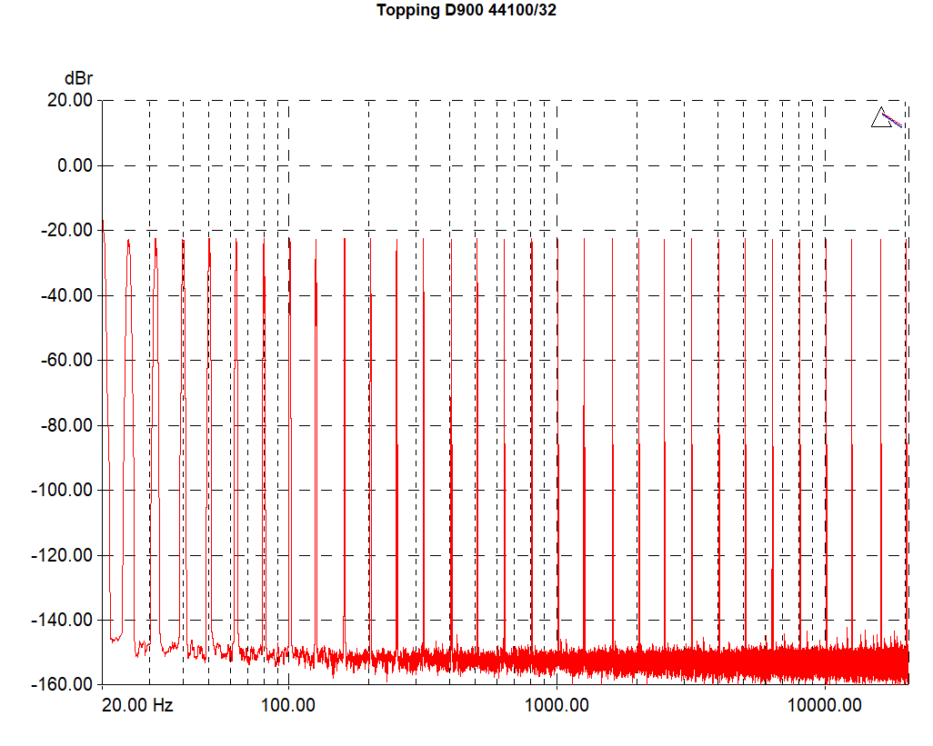

Multitone:

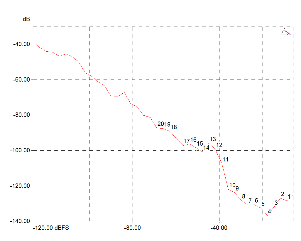

IMD sweep (sorry, forgot to disable the waveform and spectrum for 44.1k output):
Example of IMD at -50 dB level:

Can you share your Pico measurements? And from your Pico measurements with different modulators, are you convinced this DAC is now true DSD Direct, with firmware fix?
Measurements look good at DSD256 but nothing significantly better than significantly cheaper NAA streaming Audalytic AH90 DAC (with firmware fix).

Much more affordable Topping Centaurus (with the Cyan2 D to A) got firmware update same date as D900. I wonder if that is performing as true DSD Direct. Both release notes don’t mention anything about the DSD Direct mode
Topping said they cannot fix DSD Direct for D90 III Discrete. But said that they can for D900. And so far it seems to work. I got some wide band measurement results from one HQPlayer user and it looks promising.
I know D900 requires latest firmware to get the direct mode working properly. D90 III Discrete is similar, but maybe different enough. Possibly D900 has some FPGA/CPLD to route data past the same chip used for oversampling/modulators on both.

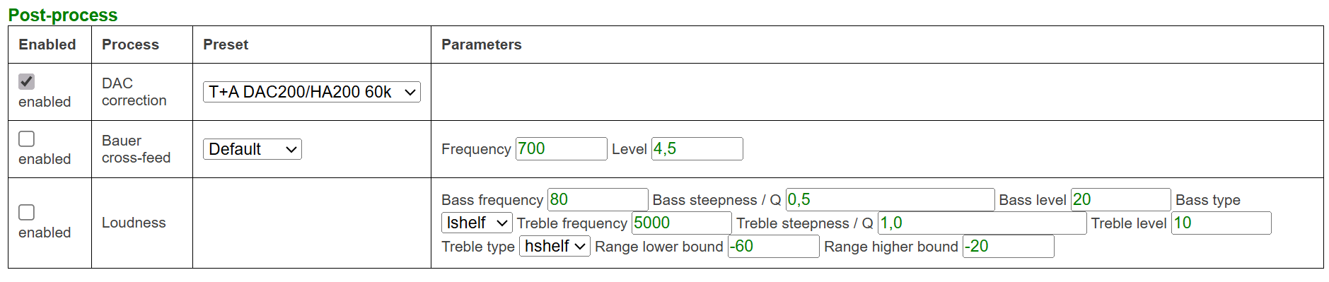

Sorry, but what is DAC correction? :frowning:
Is it something within HQPlayer or in T+A DAC200?
Have this DAC at home for trial and using it with HQPlayer.
It is a feature in HQPlayer. You can find it under matrix configuration, as a post-process plugin. So you enable matrix processor, the post-process plugin and then select the correct DAC setting from the drop list. For DAC 200 there are two, for the two DAC 200 configurations; with and without the 60 kHz analog post filter. I recommend to keep the 60 kHz filter enabled and choose the corresponding correction profile.
Work to do, thanks!
Enabled the 60 kHz filter as can be seen in the screenprint, right?
But where can I find the corresponding correction profile?
Maybe a new topic?
You have it selected there. Now just check that your DAC200 settings match that.
So your correction selection needs to match the DAC settings.
So in status information the display of DAC200 shows filter: LP 60k, right?
Yes, exactly. Then you know the correction and DAC settings are matching, which is very important for correct operation.
