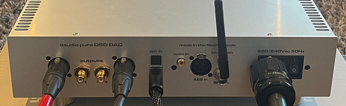

They developed this DAC via a DIY forum in the Netherlands and have made a first step to sell it. It is all still very premature. No manual, no packaging, no serial number, no power cable, just the DAC. Moreover, it is still under development. So no official reviews yet.
Unfortunately, I don’t have a picture of the inside, and I certainly won’t be opening up my DAC, as I’ve only had it for a week.

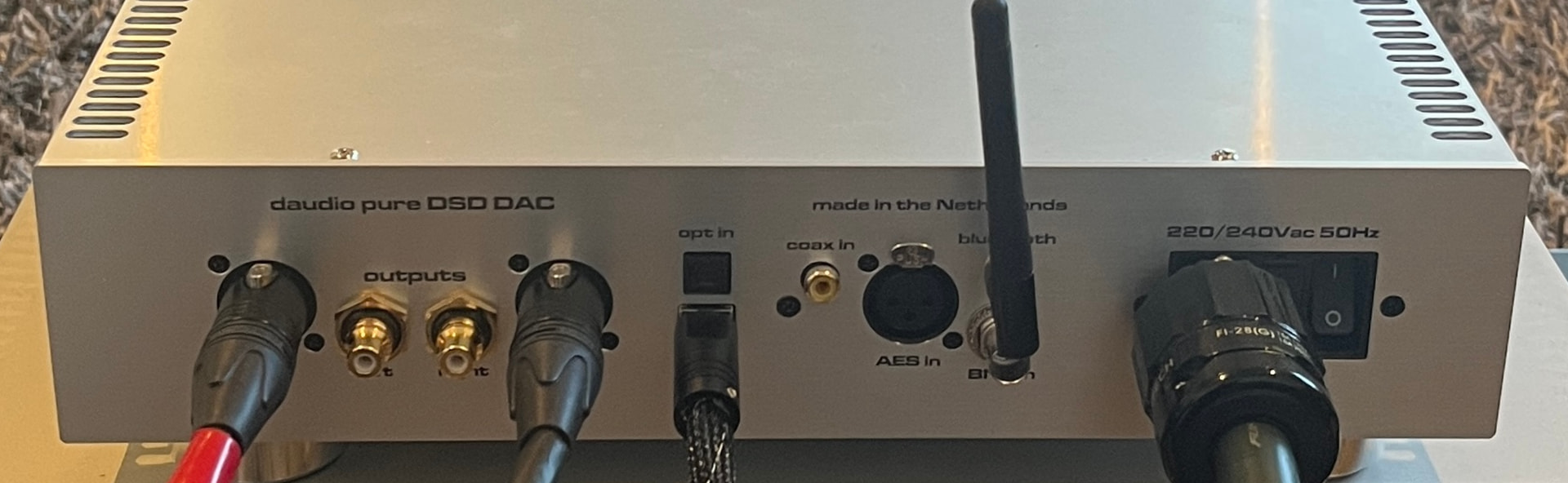

It is best to get information from Daudio themselves. Perhaps they would be willing to share a photo of the interior. Furthermore, they can also inform you about multiple playback methods. It features 6 digital inputs (USB, Optical, Coax, AES, Bluetooth, BNC) and 2 analog outputs (XLR, RCA).
Here is a photo of the back (not my DAC):
