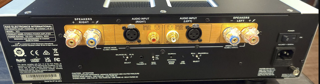

For example Benchmark AHB2 has three input sensitivity settings in the back panel:
And sometimes DAC output levels are suitable. For example Holo Audio has pretty low DSD output voltage, around 1.5V and thus it is less likely to reach too high output levels. While for example on Ferrum Wandla I have set the output level trim to -12 dB to avoid amplifier input stages (before analog volume control) from clipping… OTOH, Wandla allows me to choose digital or analog volume control.
My M23 has a gain selector on the rear, which I have set to low on my amp.
