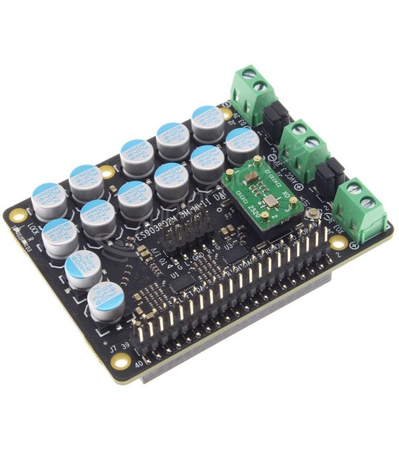

Has anyone tried any of Ian canadas gear? His Dual mono Dac has native capabilities or so I’ve been told.
The DIY approach could be fun. @jussi_laako
Yeh but doesn’t belong in this thread - he has ESS based boards.
Same as the the Innomaker DAC Pro HAT I had which performs really really well when you feed it PCM353kHz - no wideband issue at all on the Picoscope
Load NAA OS and you have a great RPi4 NAA DAC.
Balanced output too. Very clean outputs.
But not a ā€˜native’ DSD D to A converter since ESS based.
I could only feed DSD128 not higher and Ian Canadas is the same - but PCM352kHz was cleaner than DSD128

Could you explain this more? Ian says ā€œMy Dual Mono DAC doesn’t do any over sampling and takes native DSD. I think that’s what you want.ā€
What is it with the ESS based chips?
Are his dual mono DACs the ESS based ones?
If so, it is just like every other ESS DAC - you can’t bypass the ESS modulator.
With feeding PCM353k you bypass first stage ESS chip digital filtering.
This? It’s the same DAC chip as Innomaker DAC PRO (just has 2 of them I guess)
Correct ES9038Q2M
What is it with this chip?
What’s a good setting for this chip?
No ESS based chip belongs in this thread. As mentioned above you cannot bypass the modulator like you can with AKM.
Not belonging in this thread is not a knock on ESS - I’m listening to an ESS DAC now.
The Ferrum Wandla that features HQP filters by Jussi is ESS based.
The Innomaker DAC PRO HAT has same chip and is clean as anything on its output when fed PCM353kHz
It just doesn’t convert DSD direct to analogue.
No ESS DACs do.
I measured the Innomaker and can easily recommend it as a superb NAA DAC (comes in a nice metal case now).
I never had the Ian Canada so no idea how it performs.
As previously mentioned, it probably performs best fed PCM353kHz like the Innomaker and all ESS based DACs I’ve measured (which is not every on the planet of course)
