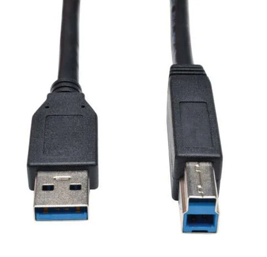

Use big connector USB 3 cable
For best mechanical connection
Thanks, haven’t seen that it is an USB 3 cable.
Holo Audio packed an USB 2 cable to the Cyan 2…
Holo included that kind of USB interface, for this cable
Even though the interface runs at USB 2.0 , its a nicer mechanical connection
Ok, thanks.
Maybe the previous owner changed the cable? Will ask him.
No they included stock USB 2.0 cable (even tho they provide USB 3.0 input connector on the DAC itself).
